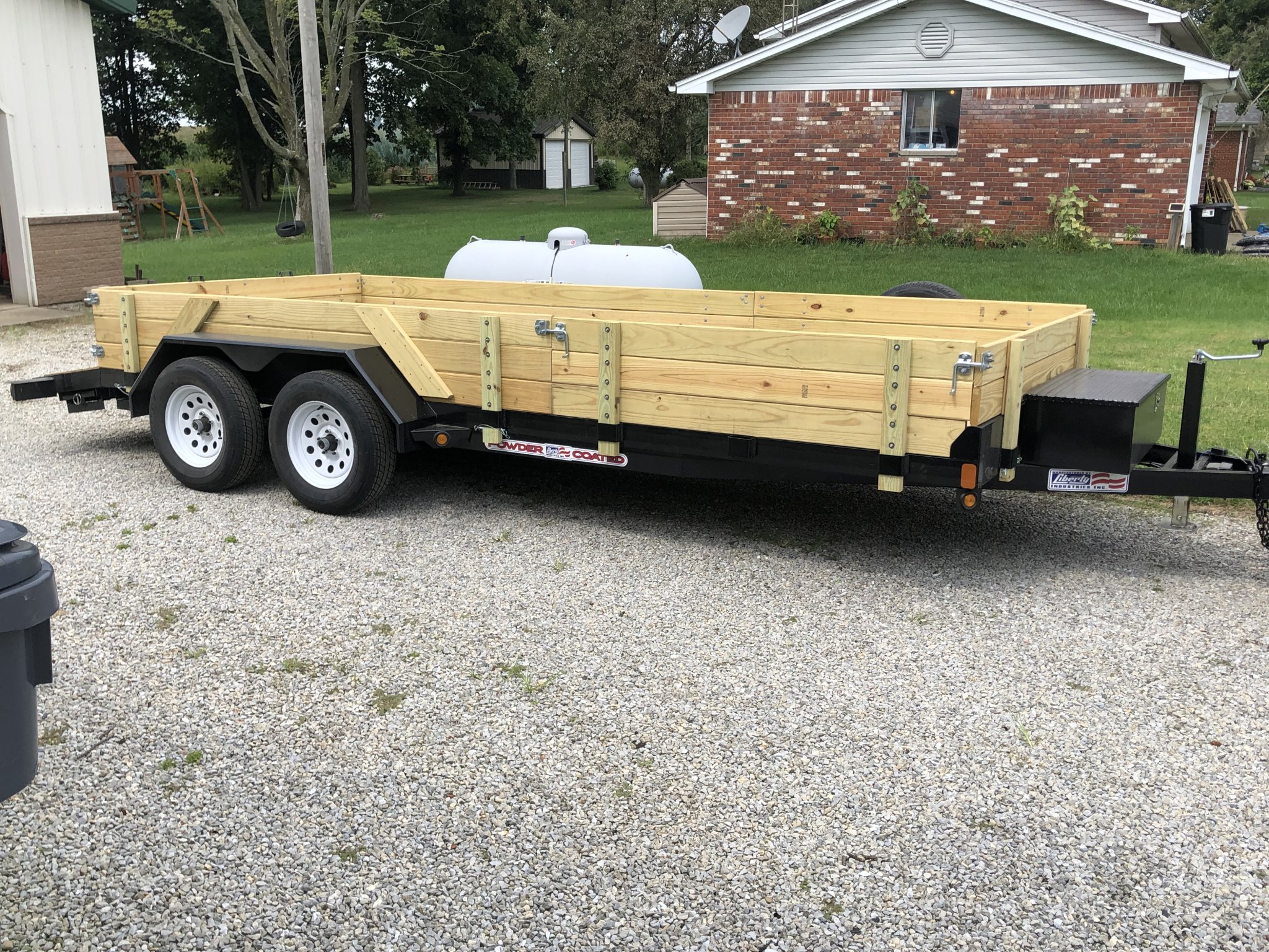

I use an 18’ car hauler to haul my BX24. I wanted a trailer without sides or fold-up ramps that would interfere with loading skids. I built a set of wood sideboards for hauling loose materials.

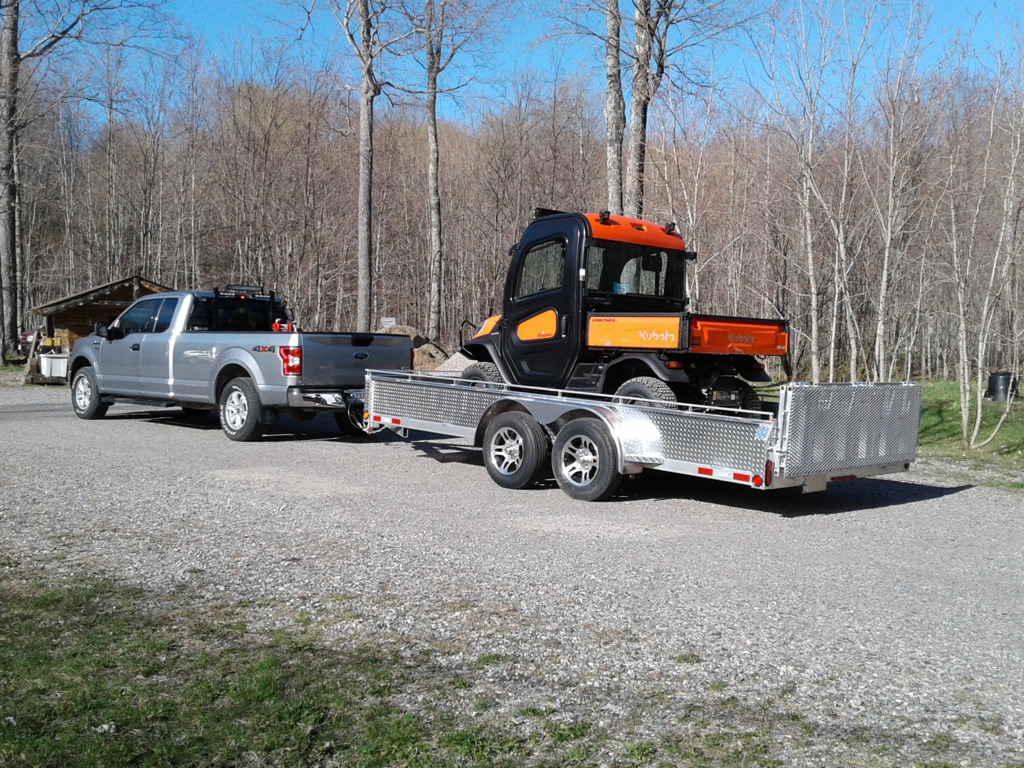

I bought this to bring my RTV home and to use for my B2620 and Allis Chalmers CA.
It was $5300 Canadian, 16 foot deck and 5700 pound capacity.
