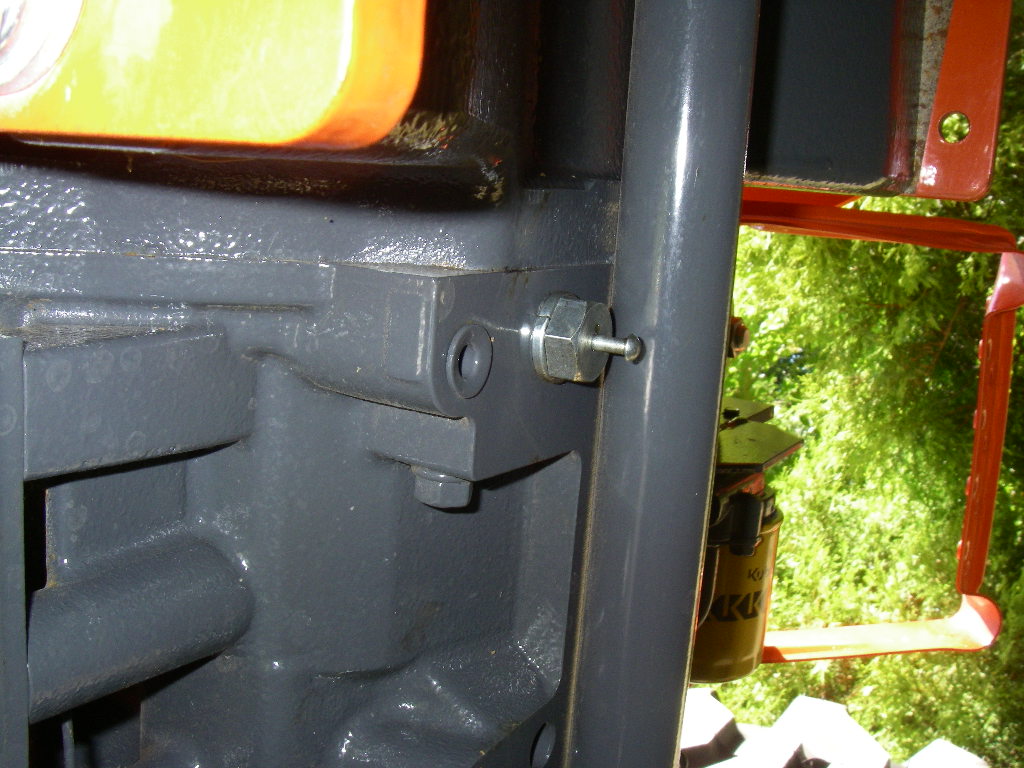

1/ Found this odd valve thingy while greasing underneath. Can't see anything about it in the WSM. The pin is loose and not oily. It's the only thing not painted.
What is it?

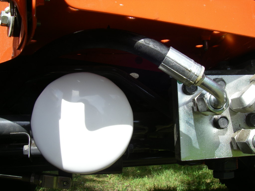

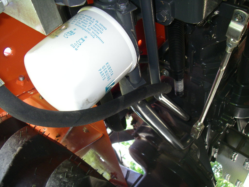

2/ The new hydraulic filter is bigger than the original and gets in the way of the hose even more. i'm thinking I should re-route the hose above the 2 steel lines.
Is that a bad idea?
When I unscrew the fitting on the main block is it going to piss out fluid like crazy?

First one is a drain for the clutch housing.
second one that hose isn’t routed right I don’t believe. It that for a back hoe?

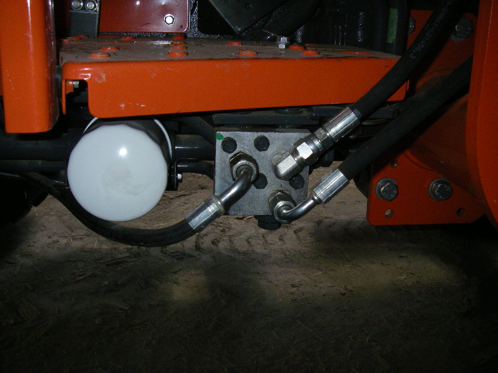

Just speculating just from what I can see, that almost looks like a hose being (strangely) routed perhaps from the Kubota Rear remote outlet (PB for the sandwich under the seat) heading over to a backhoe (inlet hose of the BH). Without the BH hooked up, that connects in a loop on the back and then the BH outlet hose would head back to the Hydraulic Block.
What’s the part# of the filter you’re looking to put back on?
I know if you take that Hydraulic Filter loose, it will ‘drain the vein’—and like nobody’s business—not sure about the fitting, though.

Ok, so the clutch housing drain lets any oil out that got by the main seal so it doesn't contaminate the clutch material? Automatically?
The hose goes back to the rear remote valve.
The filter already got changed, I'm sure the original filter was shorter and the hose wasn't in the way so badly. HH3A0-88623

Is it possible to route that hose on the top side of the filter, would also reduce the chance of it getting caught on something. Just say this because when I installed the hoe on mine the hoses run over the top of the filter

Yes, it's possible. Seems like it's not a bad idea to you guys.
i intend to go above the 2 steel lines and above the filter so nothing is stressed like it is now.
So is a whole bunch of fluid going to come out?
I can get an assistant to put a thumb over the hole I guess and get the hose re-routed as quickly as possible.
When the filter came off there was a waterfall of UDT. I didn't do it but I watched, I think he lost about a gallon and a half.

I got the machine new with rear remotes, I assume Kubota parts. No back hoe ever.

It's best that the thingy isn't oily. If stuff comes out there it gets expensive.
With regard to the filter. Are you doing a hydraulic oil change? If not, I'd try to work around it. The vacuum cleaner trick works well if you're just doing a filter change. Suction on the fill hole makes the fluid yodel back into the machine (think 8 year-olds finishing a milk shake) :)

Re-routing the hose was super easy.
The hose drained of course but only a dribble came out of the block.
Now it's out of the way of the filter.
