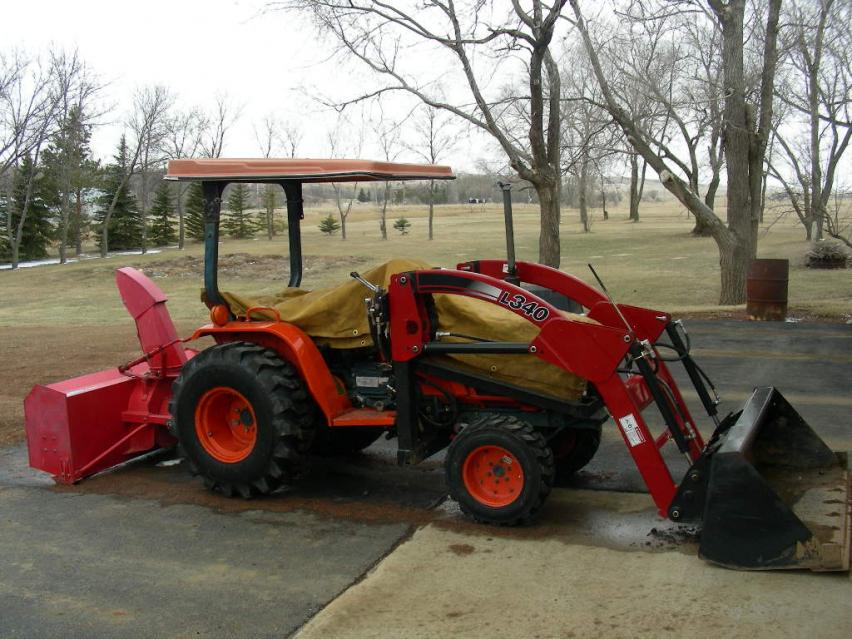

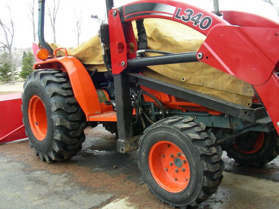

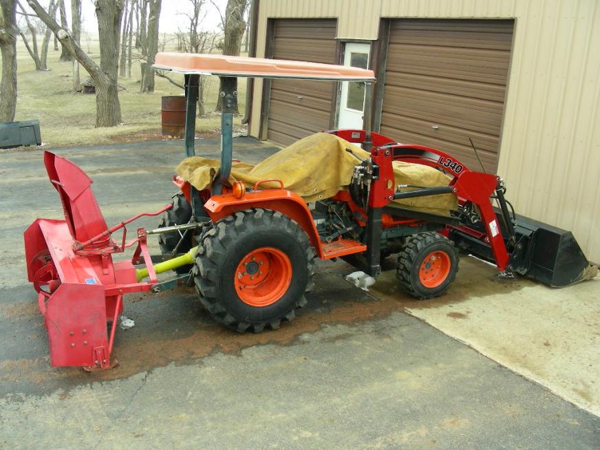

Just got the new treads on the rig tonight.
Carlisle Trac Chief I3 6 ply 12.4 X 16 on the rear with tubes and 20 gallons of Chloride in each one.
Approx 220 lbs ballast in each tire plus each tire weighs 80 lbs plus the rim weight gives me about 700 lbs of rear end weight now, should help a lot with my big 68" loader bucket.
Mounted diameter = 37.2"
Rolling circumference = 117"
Fronts are 6 ply bias BKT Skid power HD 23 X 8.50 X 12 "couldn't get carlisle's in this size, factory backrdered"
Mounted diameter = 23.05"
Rolling circumference = 67.95"
Gives me a 1.721 drive ratio.
Now to see how she performs.

Wild,
I think you're in for some big problems buddy, your math is all wrong and here's why: in order to figure the ratio you divide the front tire rolling circumference by the the rolling circumference of the rear tire. So here's how that works out: 67.95 divided by 117= 58 ratio and it must be within 2% in order not to cause problems.
The rolling circumference of the 12.4-16 Trac Chief is 108.1, and the rolling circumference of the 23x850-12 Trac Chief is 68.9, so now lets do the math:
68.9 divided by 108.1= .637 so we'll round that off to .64
I sure hope you haven't made the purchase and if so hope you haven't used the 4 wheel drive in anything where you could get a decent bite of traction so it won't explode when the parts start breaking!
You need to start over with what was originally on the tractor and get the true rolling circumference based on mfg specs and do that math. It irritates me to no end that many tractor dealers and tire dealers always seem so darn clueless when it comes to 4 wheel drives. I'd bet money you won't find ANY tire retailer that would sell you 2 totally different tires in size front to rear if you drove in there with your every day 4 wheel drive pickup truck because they know that will screw everything up quickly. But, they somehow don't seem to relate that a 4 wheel drive tractor is just as easy to mess up as that pickup truck. I will give some the benefit of doubt since the tractors we're discussing here never have the same size front to rear, but they should at least have a clue and find out what is and isn't proper before they sell you the goods.

I appreciate the info :) but you lost me at where you got the 108.1 and 68.9 numbers from?:confused: From your calculations how many percent am I off from the 2% acceptable norm? I stressed that they needed to be within the same range as the originals and they didn't seem concerned at all with the ones they chose for the fronts, if it truely does act up they are a good company and will make it right for me.
Tires are bought and on the tractor as the pics in the post above show.I had the exact same size/brand turf tires as the OP and went with the same rears and just different brand fronts in the same size which are about 1/2 inch bigger than the fronts the OP went with.
From all the info and spec i have the front tires are about 1/2 inch taller than the original turf tires and the rears are the same. Having been a heavy diesel tech for 20+ years and most of that working on 4 wheel drive and FWA ag tractors and 4 wheel drive payloaders and Backhoes among other loaders the chances of finding a loader other than new with matching tread diameters from from to rear are slim to none, Mine will be in the dirt 99% of the time and as long as the fronts are pulling a bit more than the rear I have never seen an issue.

Thanks Al, Time will tell now,
But your spec book and the info I printed off their sites differ, I have the sheets I printed directly off each tire mfg web sites which is the info I posted above and they seem to differ from the books you have.:confused:
