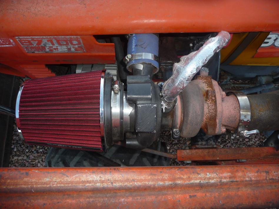

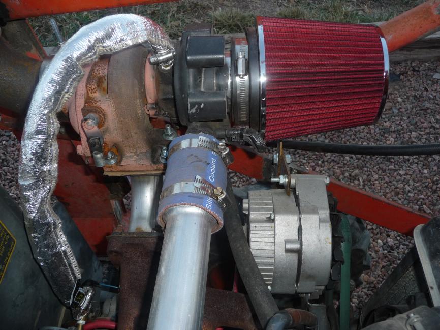

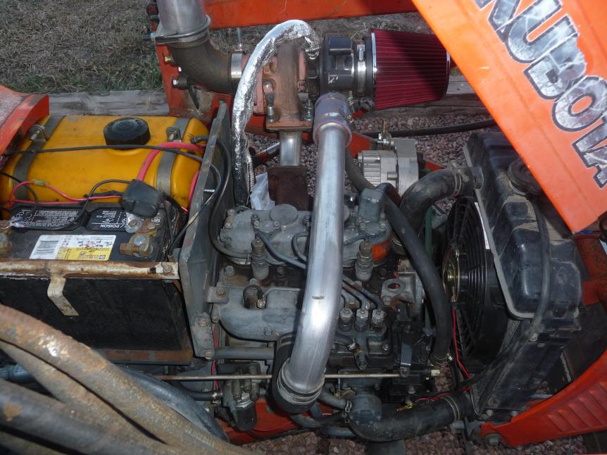

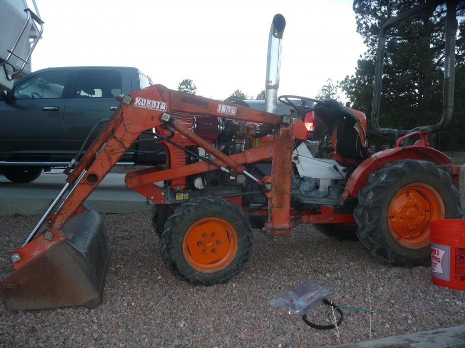

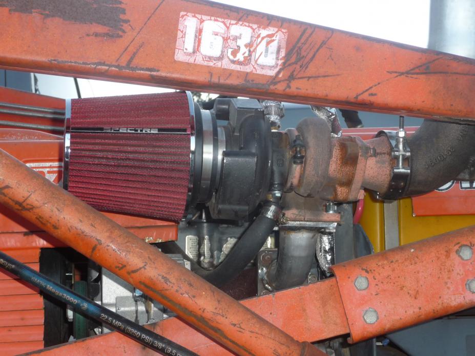

Hey guys,
Just wanted to shair some pictures of my ol B7100, I just added a turbo, (after being inspired by a few others on here) installed an oil supply line T-into my oil pressure sending unit, oil drain line, made a fitting into the fuel pump housing, had to fab up an exhaust manifold, and intake tube and of course a 3" chrome exhaust stack, while i was there i added a 30 amp single post GM alternator, and a 15" flexlight fan, All and all she runs real good now. Hope you enjoy.
Craig

Very good questions, and to answer them honestly No i have not yet, only boost. which at full throttle with a load is about 6PSI. wating on a pyro gage to come in before i start with any fuel mods. the turbo came off a very small 4 cyl Cummins gen set (i will get the specs on the turbo and post), so i do have some lag at bottom end, but thats ok, on our tractors you just set the throttle anyways so quickness of bottom end really is not a big deal, once i get my Pyro i will better understand what i can do on fuel, as far as hp numbers, i really dont have a way to get them. PS, I hope to look at sometype of intercooler as well to help with intake temps, but again no hard numbers.
