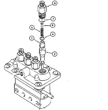

After pulling the valve on the injection pump i'm not getting any fuel in that cylinder. I was certain I had put everything back exactly like I found it but its clearly not pumping fuel.
When I cracked the line and turned it over, the odd thing is that the valve in question starts pumping fuel when I pull the kill switch.
I pulled it apart again to double check and believe I see the problem but I'm not sure how to fix it. The attached diagram is very similar but not identical. The question is about part #2, it has a hole in the side and a groove just below that however it does not lock in place on the groove, I am able to install it indexed any way I choose and i'm not sure how to properly align it.
Also attached another picture I found of the part in question with a red box around the hole and notch.

You reinserted the pump 180 degrees out.
With the entire pump out you can look at the rack and the valve gears there are marks that you line up to time the pump.

I had assembled everything correctly however for some reason the locking pin that holds the cylinder in place was not sticking out far enough. I fixed this by removing the pump and snugging the two flat head screws on the back.
All o-rings and copper washers have been replaced in the injection pump and I'm ready to try tuning it again.
For reference the o-rings for the injection pump valve holders are 13.8mm ID, 18.6mm od, 2.4 section
Copper washers are 8mm ID, 12mm od
