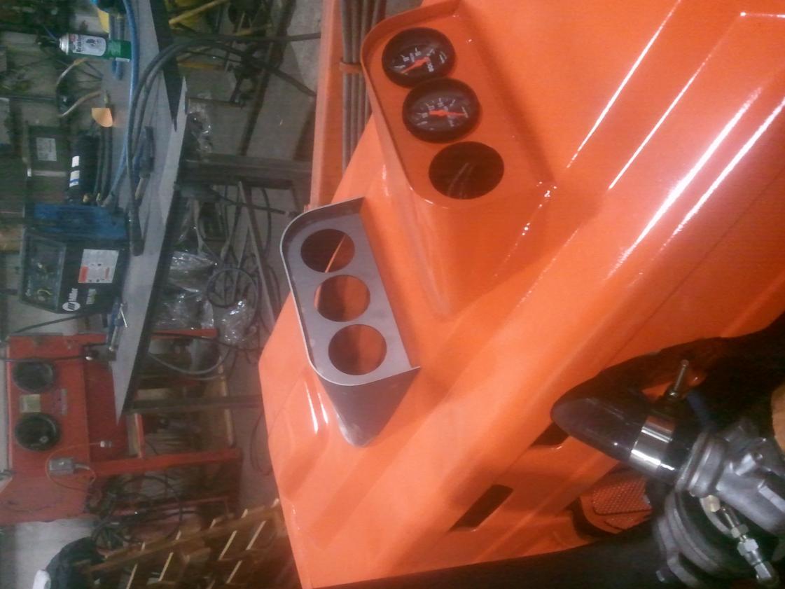

i noticed ur can of paint. is that by chance the valspar brand kubota orange? also i was wondering if you or one of the other guys would know where to lacate one of the small turnbuckles on the lower 3 point bar? im missing the center female theaded piece. any ideas?

I have a universal one on mine i got from Napa auto parts. Works perfect. When i got the tractor it was all bent to hell so i had to replace it.

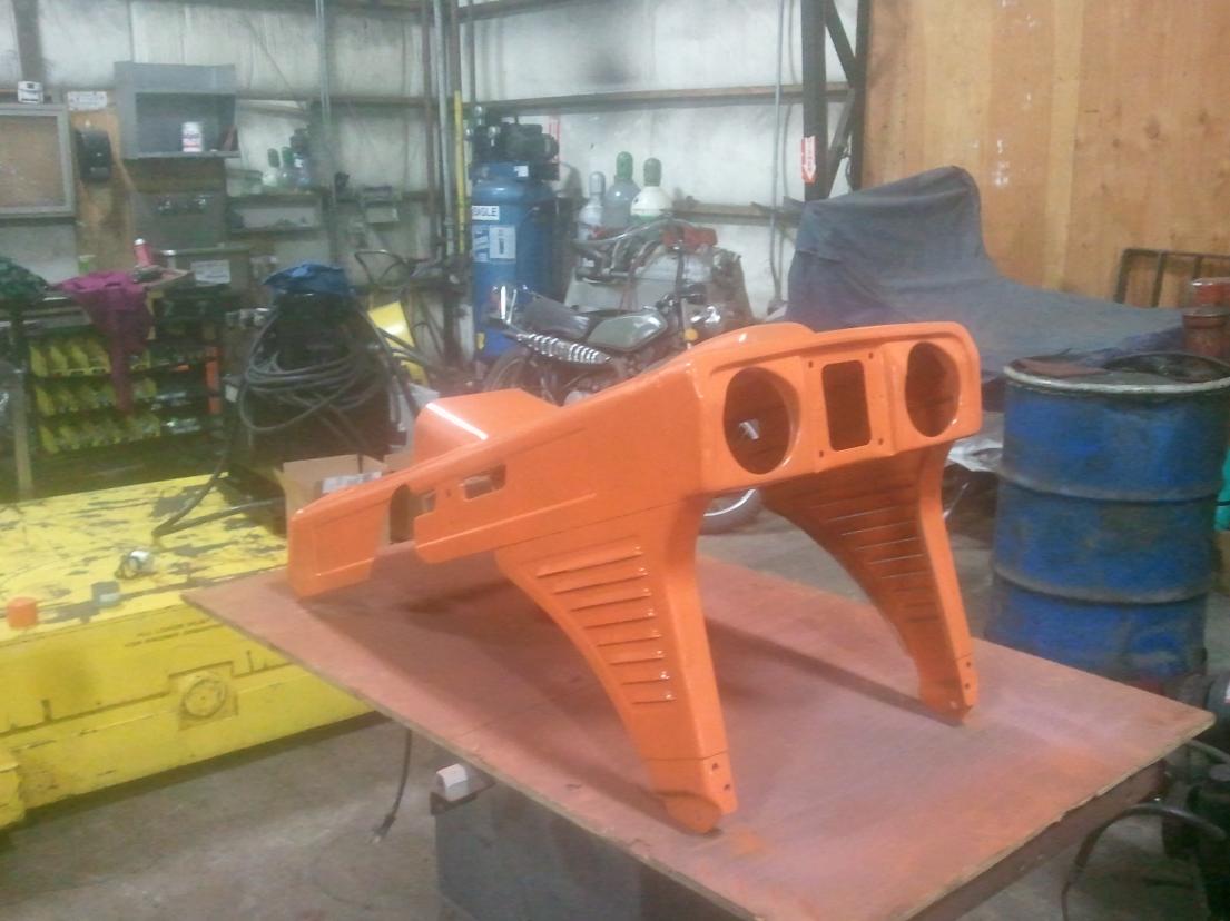

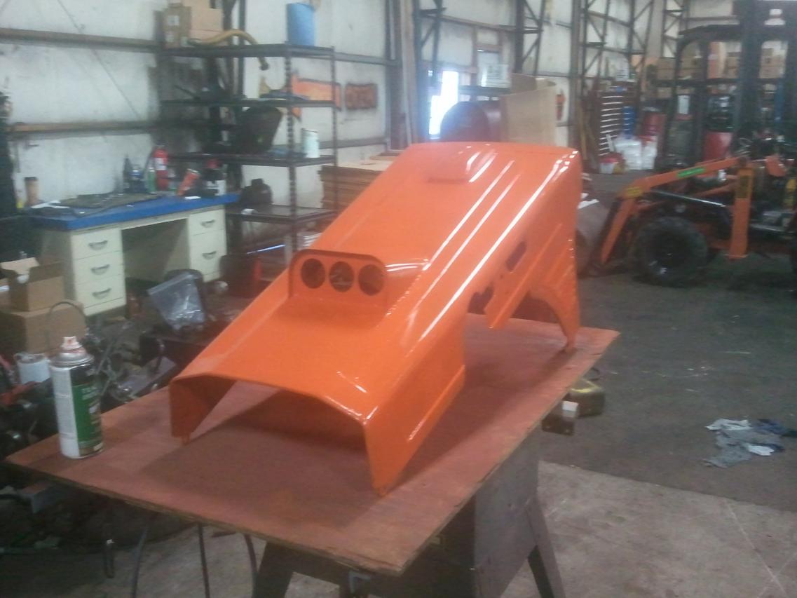

man thats awsome! did you make the pods or did u buy them. if u bought them, where did u get them i think i mite like to have one thats cool!

Its my own design and fabrication :)
Just made that one for kytim, ill make you one for $20 + $11.35 flat rate usps. So $31.35 and ill have it to you in a week. Let me know if you're interested or anybody else. I can always do a small production run :)

Hey Bro, I got my gauge pod today. That is one heavy piece! the level of workmanship is fantastic. very little fitting is gonna be necessary. maybe some light file work is all. After seeing this I sure wouldn't hesitate purchasing it again. Thank you for helping me out!

I'm glad you like it :) I always slightly over-build things, i could have gone a little thinner but i think the .063" is beefy enough to hold up to about anything. I am doing a small production run of these if anybody is interested, I'm going to run 6 of them.

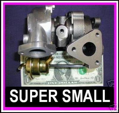

Iam curious, about this D950 OEM turbo your talkin about.? This is news to me that kubota ever turbod the D950..
Where can I find Imformation on the specs? etc.
As far as turbo sizes go, I think this one might be the smaller.., Brand New for about $250.00
