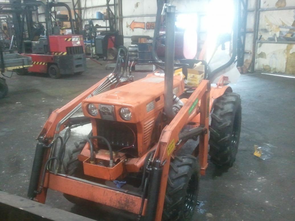

Hello, im new to this site, although i have read through quite a few articles before i joined. Just figured I would share my tractor. I inherited my B7100 three years ago when my grandfather passed. I grew up on this tractor, every year i was out mowing the field for him, drilling post holes, tilling the garden and whatever else was needed to be done. When i got this tractor it was in pretty rough shape from sitting out in the weather for years and years in an Oregon climate.... Since i got it i have put lots of hours into cleaning up, and fixing all its little issues. I have replaced all the tires with new silicone ballast filled ag's, i have completely rebuilt the hydraulic system, including replacing the spool valve. I converted the headlights to a custom snap in halogen kit. I added a utility strobe and worklight. Last but not least.... Have you ever just wanted just a tiny bit more power out of your kubota? I have, mowing fields especially. So i decided after quite a bit of planning and research a turbo was the best way to go :) I custom fit a rebuilt mitsubishi Td03 off of a Volvo XC90 onto my B7100. Adding a turbo and turning up the fuel as well as sligtly retarding the timing gave me a significant power increase. I am running 5 psi to the engine which it seems to love. I am still waiting to get it on a dyno for some exact numbers but, turning a 4' mower cutting 3' tall grass now only requires a touch over half throttle and i nearly doubled my travel speed :)

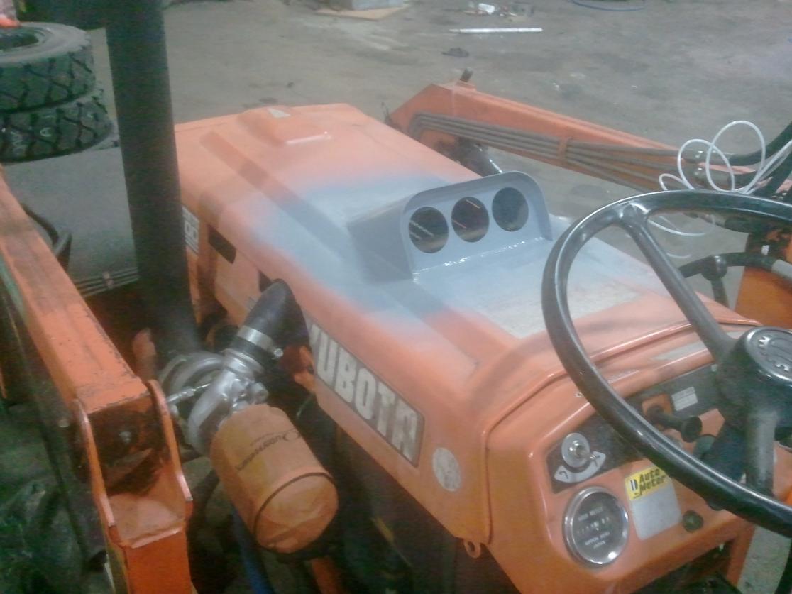

I purchased a universal autometer pyrometer kit from Napa, it came with everything i needed for the install. I just drilled and tapped the manifold right before the outlet flange, i had to shim it up with some washers because the probe works best when its centered in the exhaust flow. I also purchased the matching boost gauge and water temp guage kits. I'm working on a hood mounted gauge cluster i should have it welded up by Monday. Ill post some pics :)

We have been having some real crappy weather out here lately so she hasn't seen a whole lot of field work yet but as soon as I get the chance i will be sure to put up some good action videos. Until then ill get a startup and driving vid up within the next few days. Im working on my hood mounted guage cluster right now so as soon as i get some pretty guages on her ill shoot the video :)
