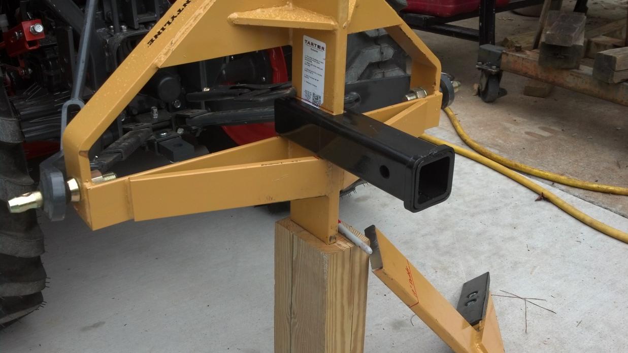

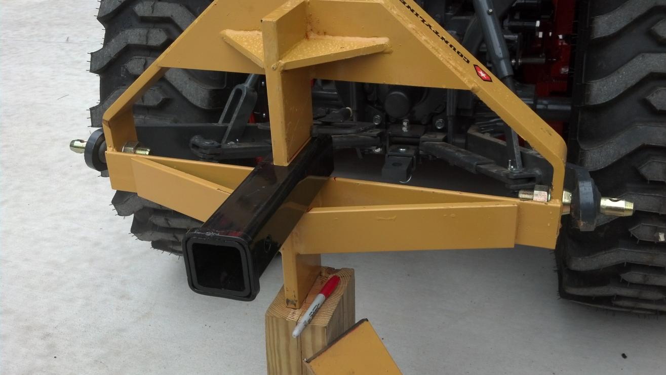

I had planned on making this a combo implement anyway by welding on a 2" receiver hitch so I decided to chop the 3/4" plate steel "backbone" of the subsoiler down just enough to allow me to drive around safely with it in the full up position when I'm using it as a subsoiler. As a bonus with my modification, I can remove the foot and plate doublers all together for extra ground clearance and not have to worry about it catching on anything during normal tractor operations, which is the majority of the time.

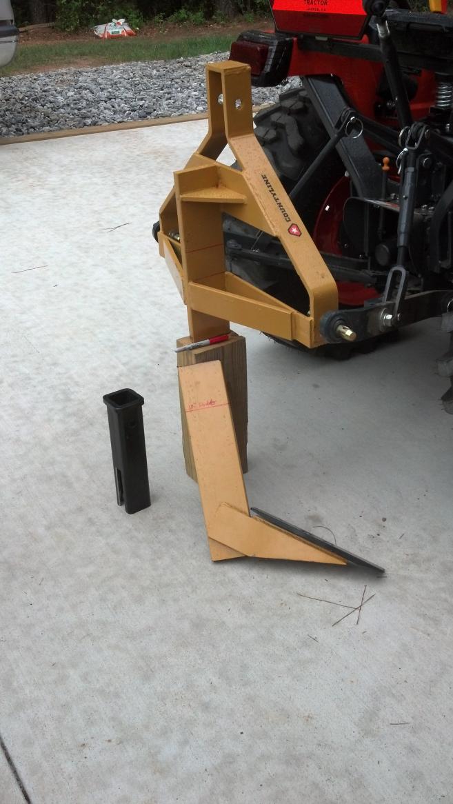

After measuring 4-6 times and triple-checking everything, I decided to make the cut!
Then notched out the receiver tube for fitting over the 3/4" spine.

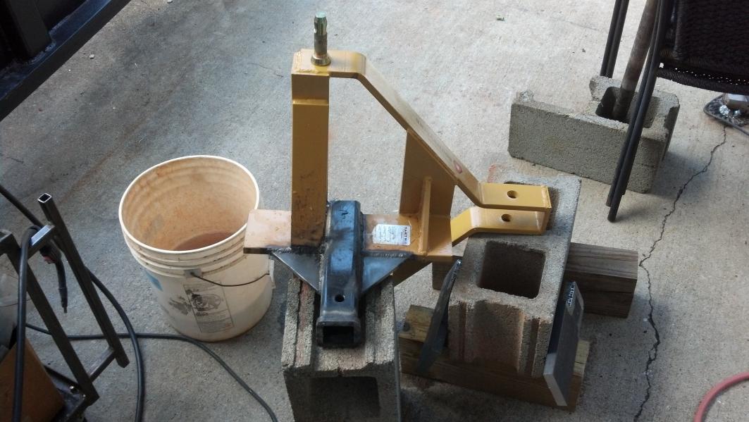

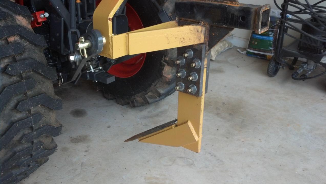

Next I made the removal cut from the spine (I think it was right at 5")....

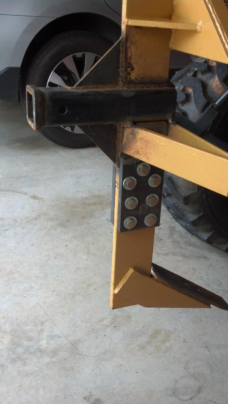

I clamped it in place and drilled 4 additional holes for it and then took all seven up to 1/2" diameter.
In full up position I have right at 4" of ground clearance now but still have adequate digging depth.

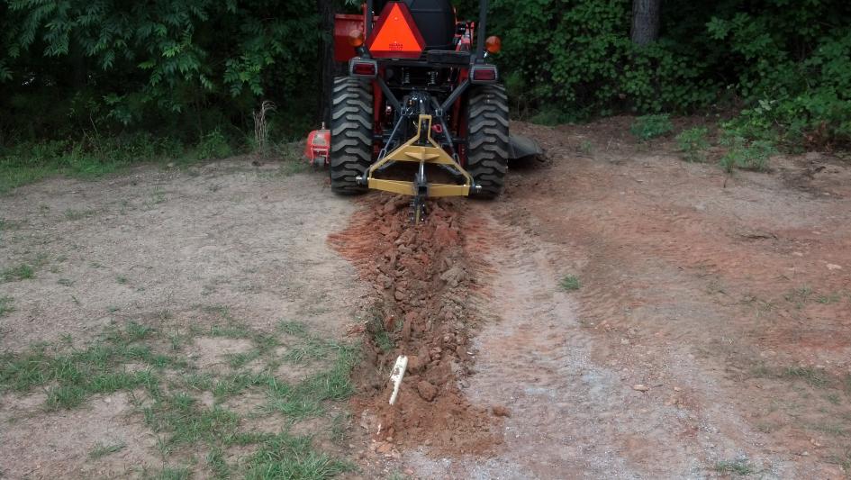

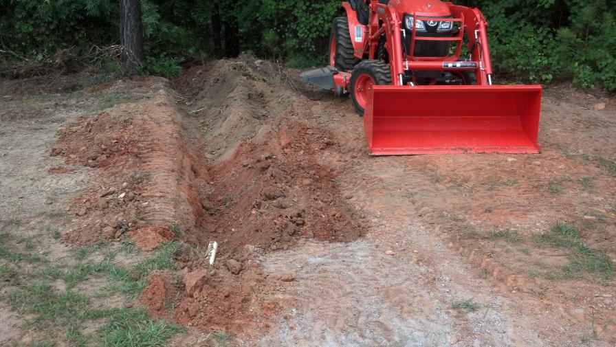

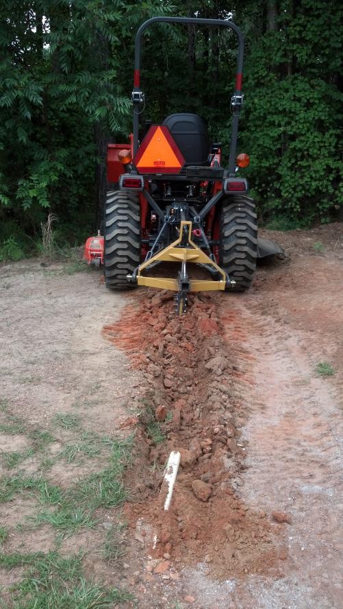

I didn't take any close up pics of it completed :eek: .....but I did get to put it to work yesterday before the rains came to continue my drain line project.
The subsoiler worked great in 4wd Low breaking up hard GA red clay to make my front end loader's job cake scooping out the busted up soil....

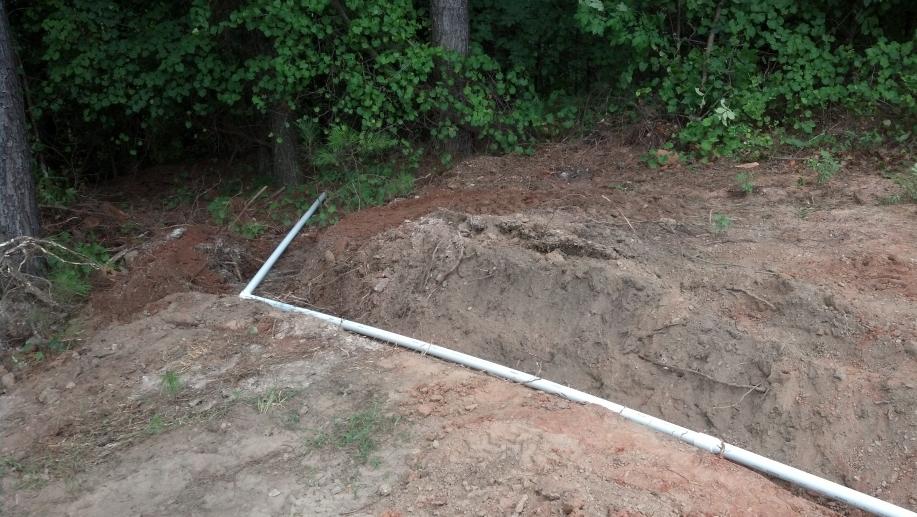

I was backfilling and compacting when my load of fill dirt arrived about the same time the rain came so I had to tarp the dirt and shut her down for the day.
I should add that this project stemmed from another project.....
A concrete pad addition I had poured disrupted two drain lines so they had to be relocated.

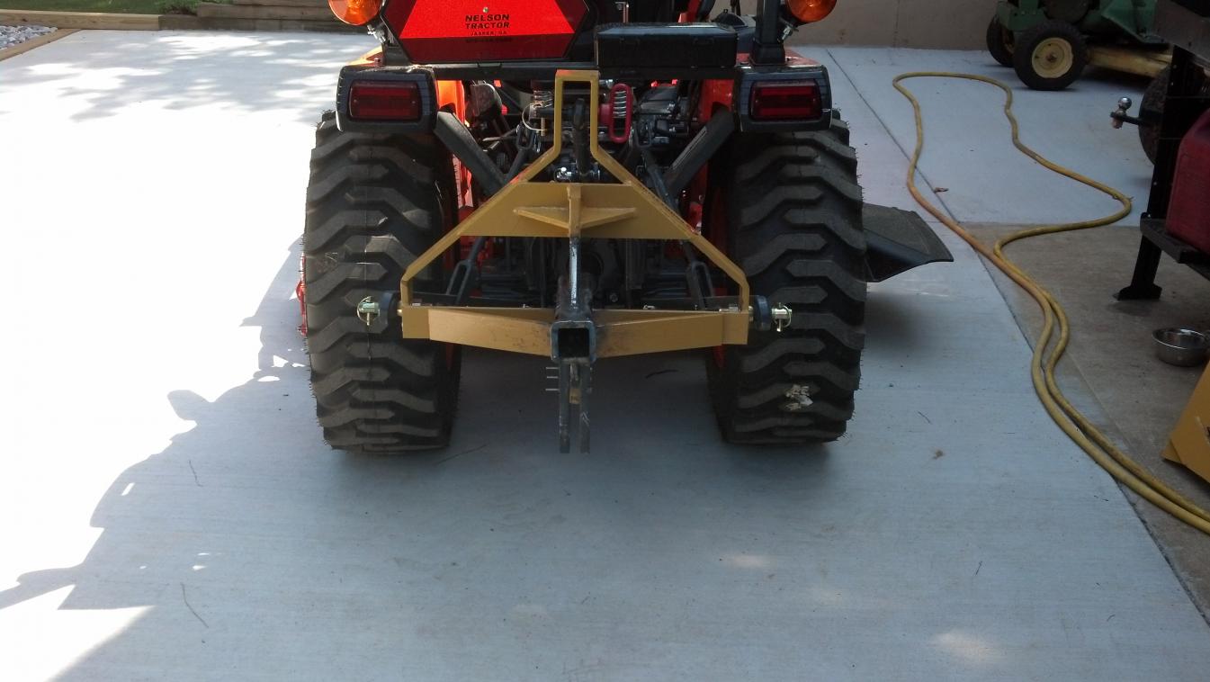

Just a quick update to add a few more pics since I didn't get any of the finished assembly.
I'm gonna wire wheel it all down and give it a couple coats of paint. I need to get by my dealer and see what they offer (and how much $$) for factory paint color in spray can's. I think it would look good in say......ORANGE! :D
Unless someone here has sourced a good matching paint elsewhere.....
