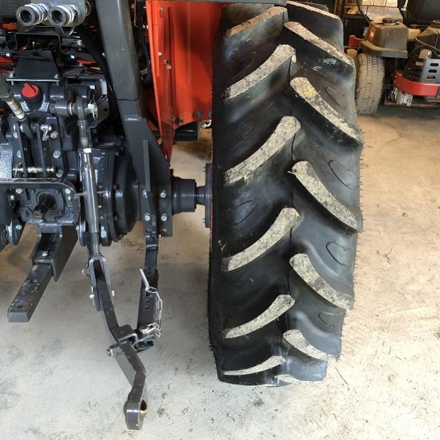

I needed good traction in the mud because I have a wet lands area on my property and I ended up trading the R4s in for the R1 tires but I went with the Radial galaxy 320/85R24 rears for extra traction in the mud. I have the rear tires loaded and the front tires foam filled it pulls around in the mud way better than the R4s did.
Here's how they looked new, they fit perfectly on the factory rims and are a good bit wider than the 11.2 bias tires it came with but work with the factory ride height so you don't bust up your MFD.
