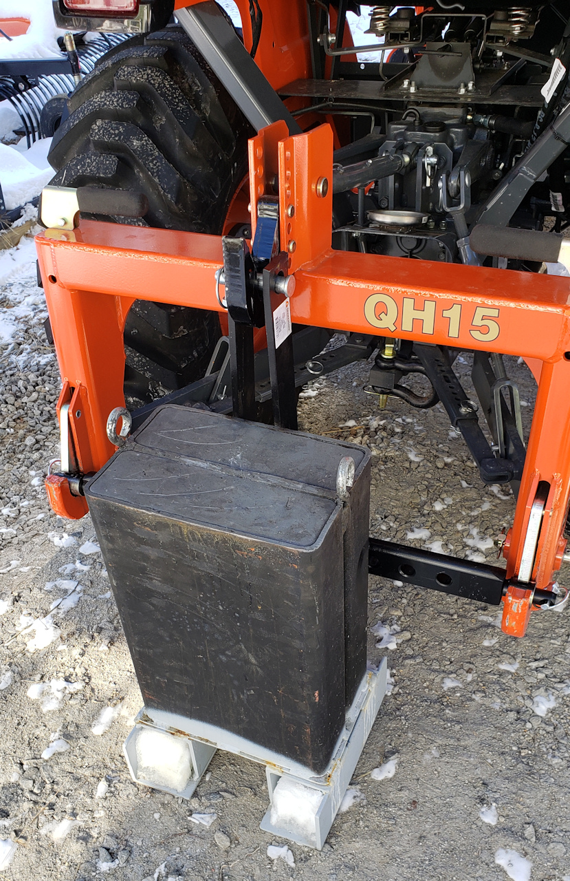

Bought mine off amazon, wasn't QH compatible had to mod it.
you may want to consider where to park it when using other 3pt implements. Can be as simple as 4x4's with tree behind them or build a stand.

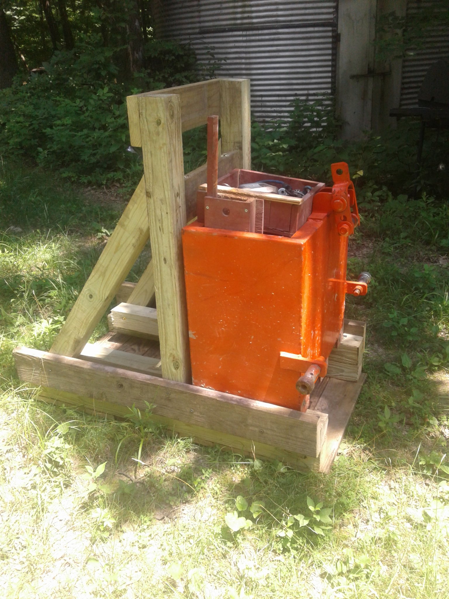

Made one of these also, maybe some I'll figure out a use for it.:unsure:

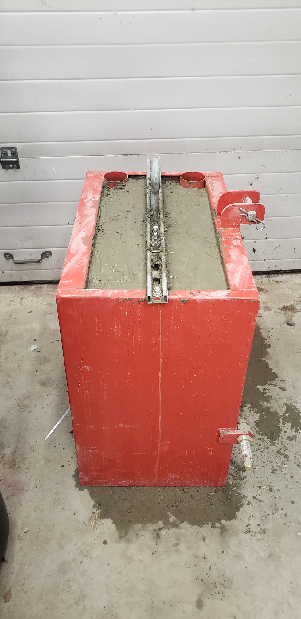

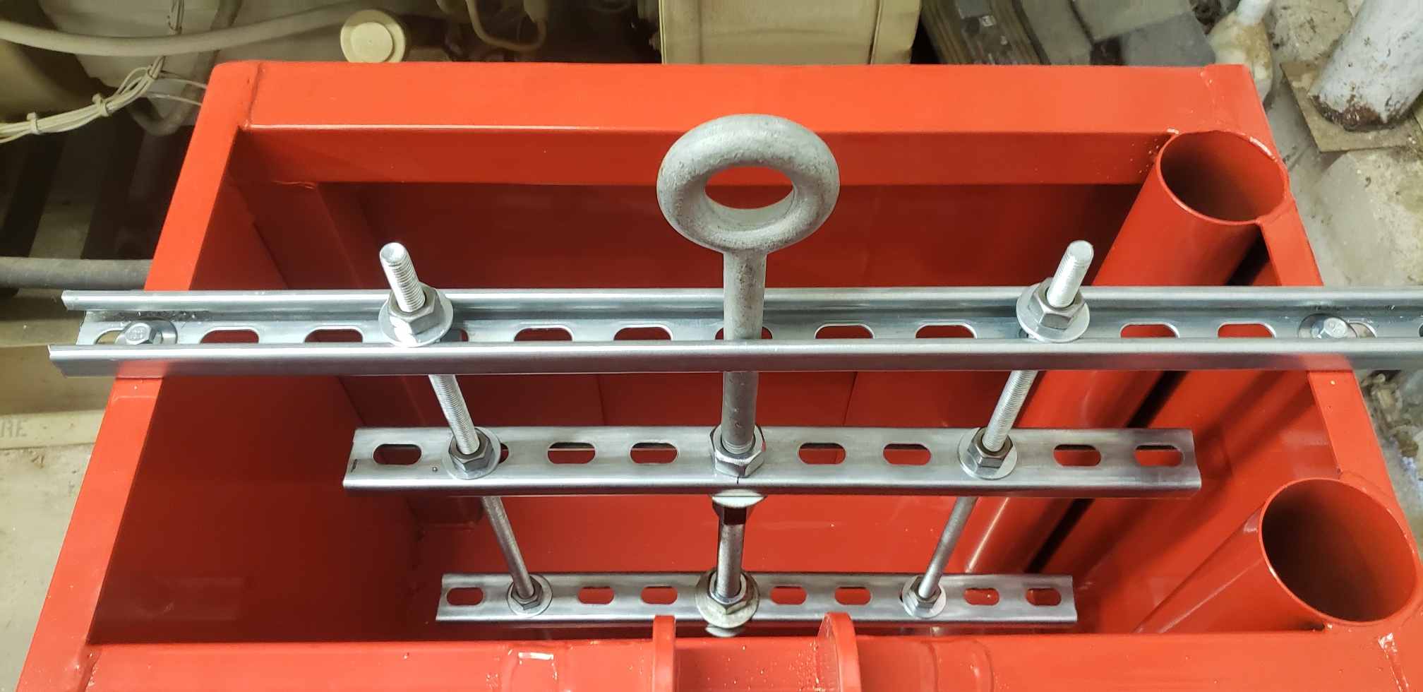

I picked mine on Ebay:
Ballast Box

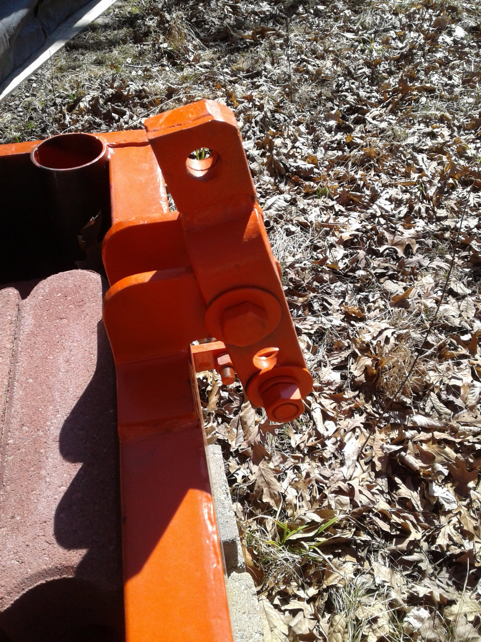

It shipped from NJ and I had it in 2 days. Other than the pins were undersized and I had to change them (lowers) it is very well constructed.
I filled it with concrete (7 80lb bags) and made a frame to go in it with a lifting lug.

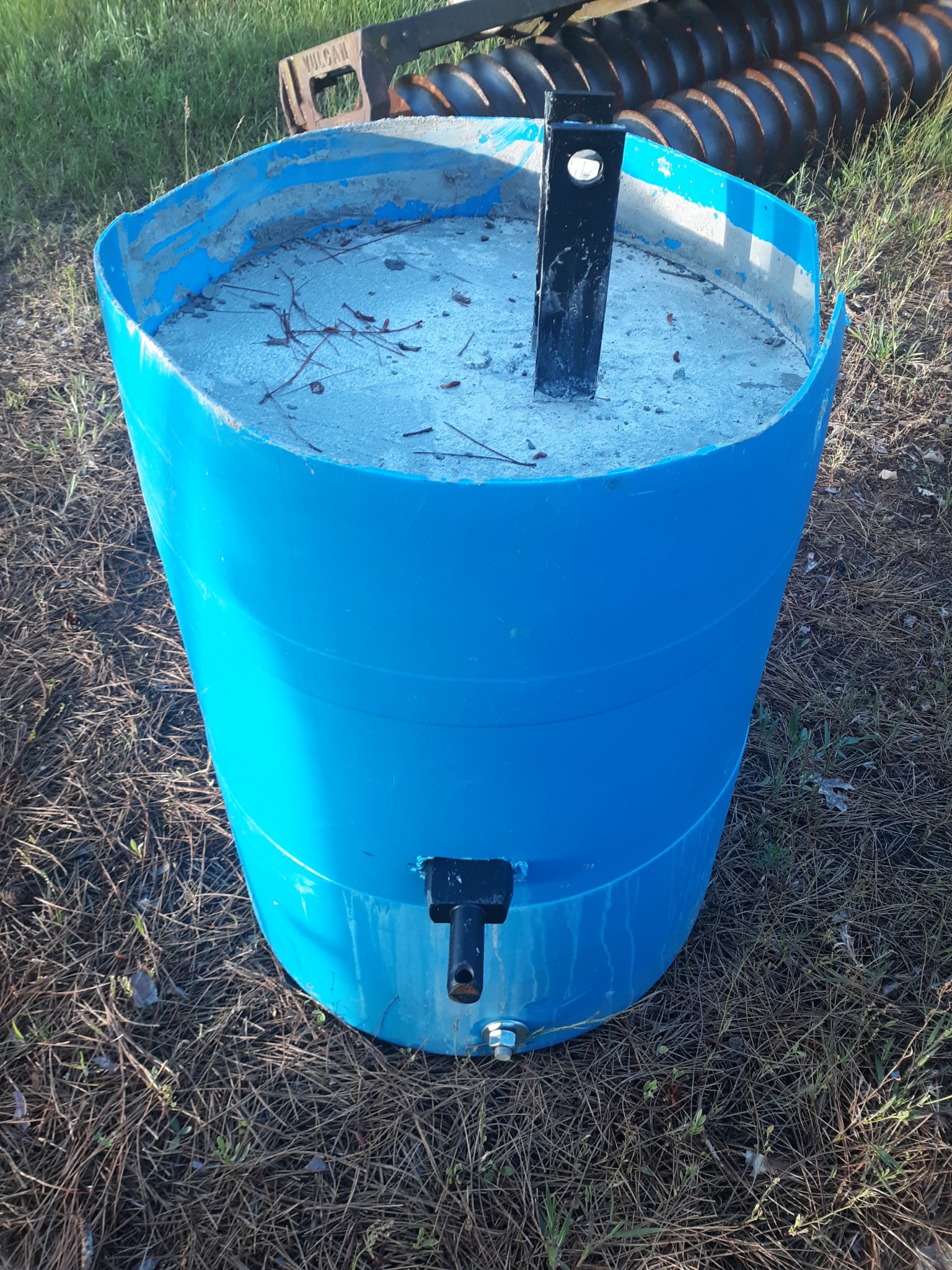

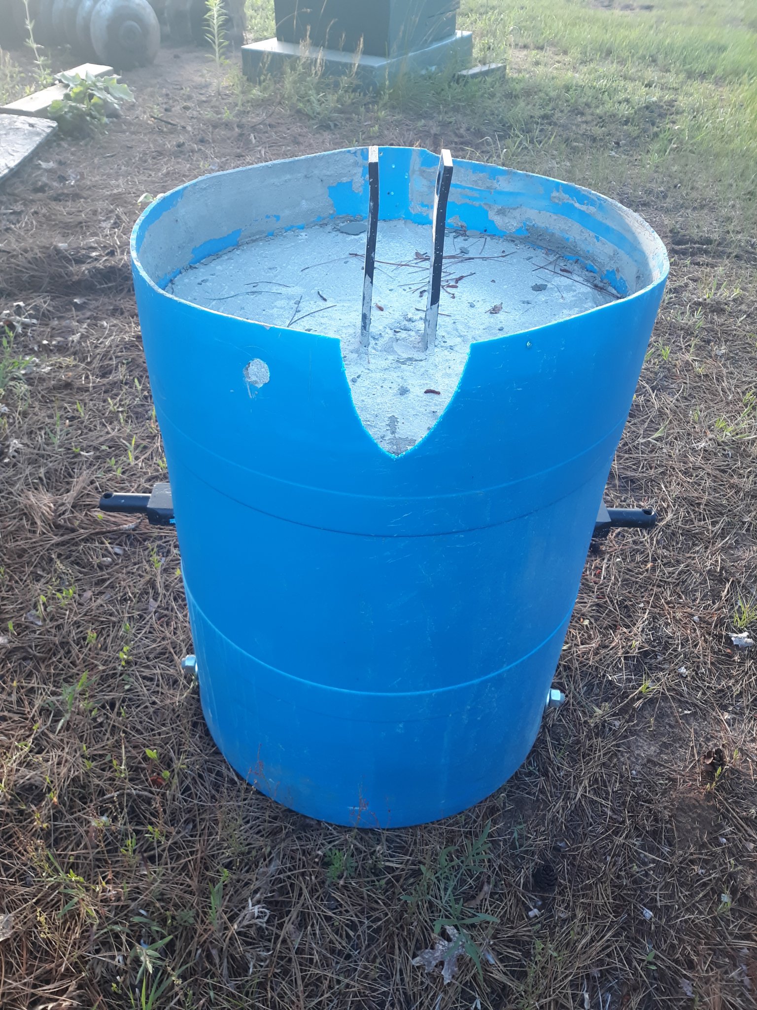

I built a black 35 gal drum filled with concrete (500lbs) with a drawbar slipped through. Dropped pvc pipe in it for shovel handles and sunk two plastic ammo cans in the concrete before it dried for tool storage and straps. Works really well. Had the same thing on my larger tractor for years never had an issue. About $50 all in.

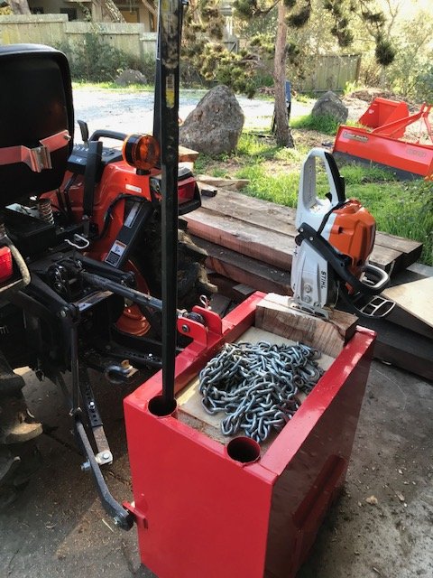

I also picked up one of the $250 ballast boxes from ebay. I wanted something more compact than a caryall since I often bring my tractor into tight areas including my workshop where I park it. This is compact enough so that its always on the tractor unless I'm using a different 3ph implement. When I'm not using it I set it down on a furniture dolly ($15 harbor freight) so I can wheel it around the shop and easily align to my 3ph. I like that this box has a 2" receiver and tool holders. I made a chainsaw holder out of a slab of wood and added 450 lbs of sand leaving enough room on top to hold gloves, chains, small hand tools, etc. Only two complaints, the door fits loosely and I had to seal it with silicone to hold the sand and the 3ph pins were undersized but otherwise its great. I figure its 550lbs and when I max out the loader (B2401) I need still need a couple hundred more pounds set on top to keep the back wheels down but its easy enough to throw a few bags of sand or concrete on top of the box. Overall its great and I wish I would have bought a ballast box sooner.

I like your chain saw idea, as I filled mine with bags of gravel, I might just lift them out and insert something similar to carry a chain saw, then put my bags of gravel back in. Like you I have a dolly onto which I unload the ballast box, makes it real easy to store and then to reinstall back on my tractor. For $250 delivered they are great value even if you have to replace the pins, I purchased from Titan several years ago, their pins were good.

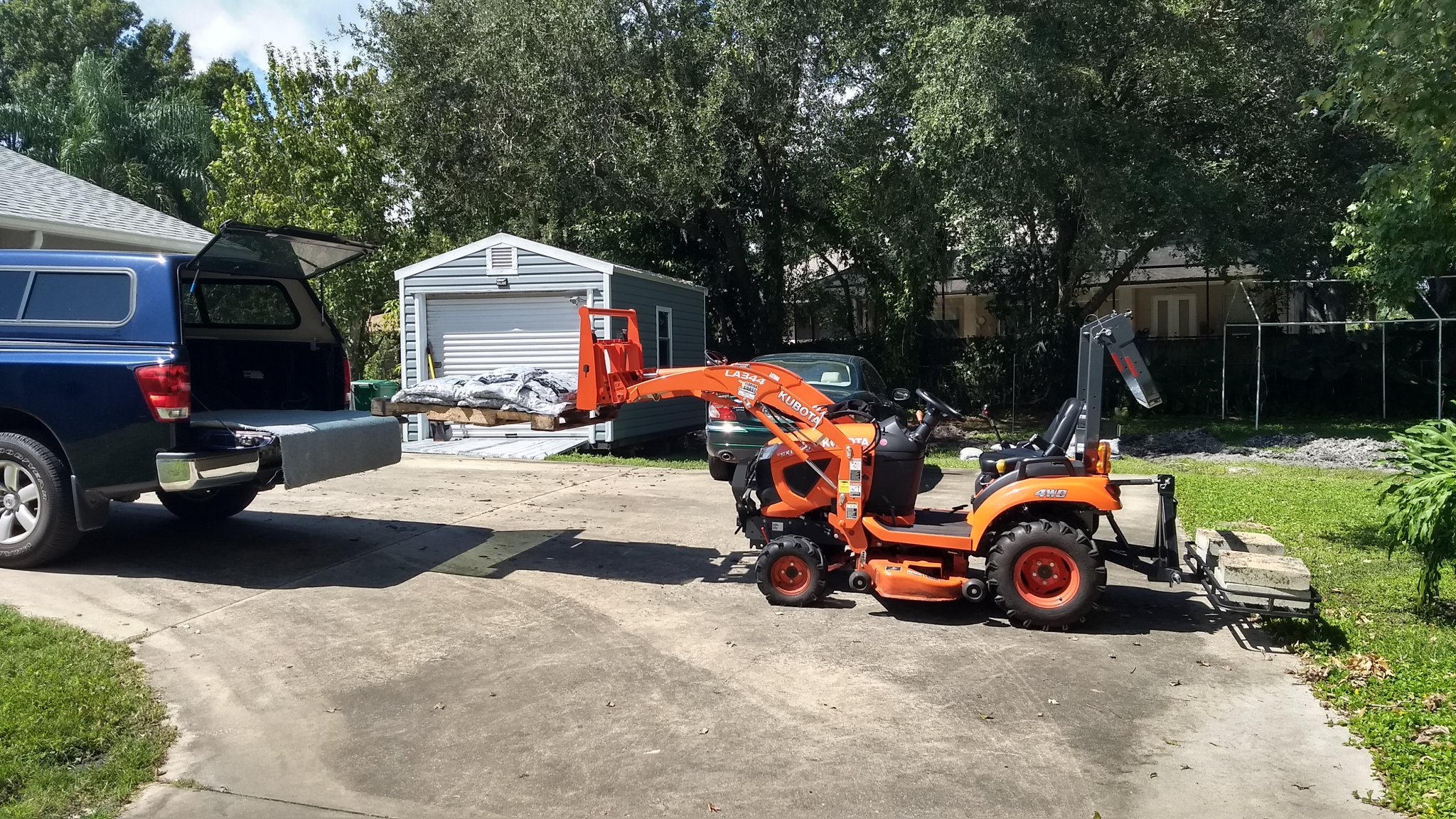

I am cheap. So, I got a 2 inch trailer hitch receiver:
To use with a subsoiler ripper:
https://www.ebay.com/itm/Titan-Atta...501933&hash=item4457067e36:g:FK8AAOSw1ZpgCvTu
And for ballast I use a 2 inch small car cargo carrier and four blocks of concrete:
