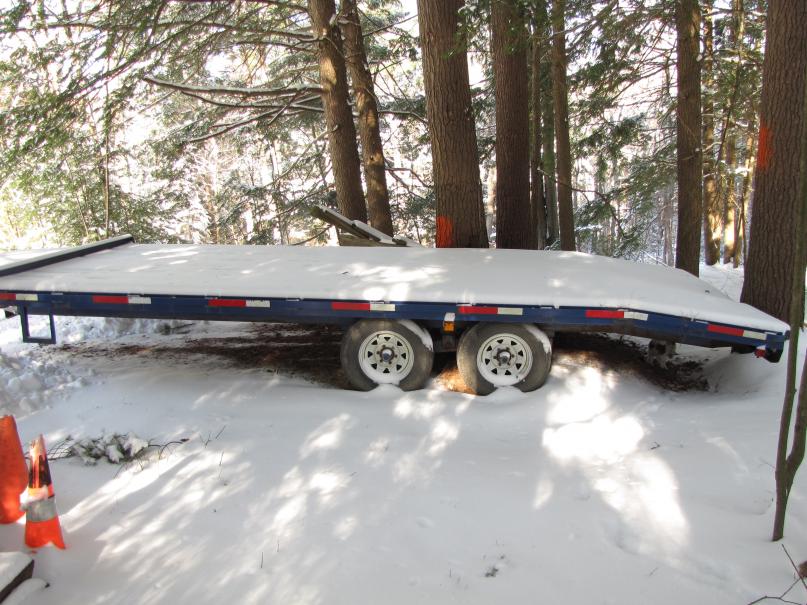

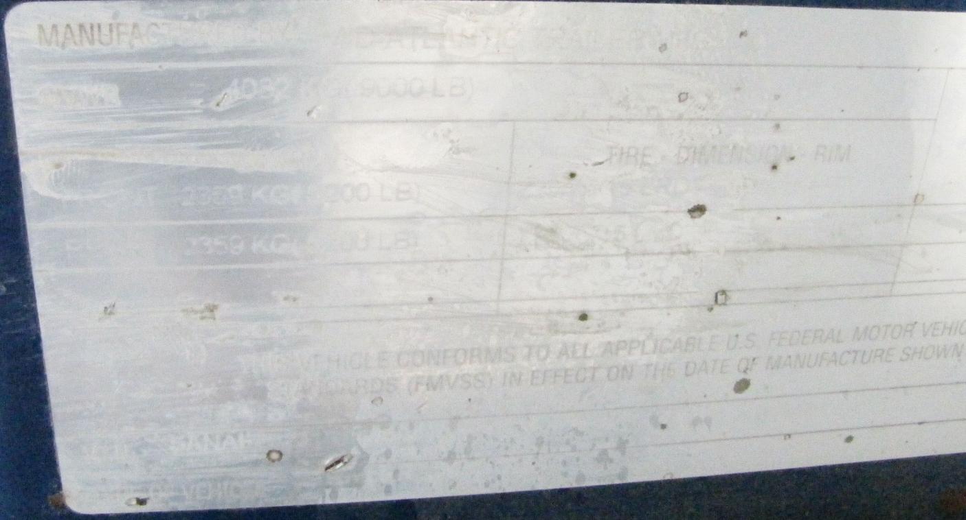

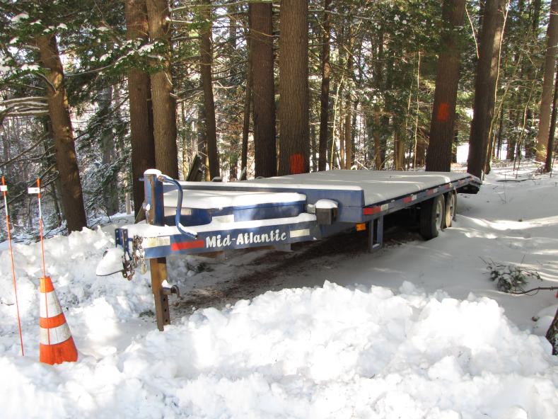

Anyway I went back to my old purchase receipts and tried to read the DOT sticker on the trailer and from what I can see the DOT sticker says front axle load is 5,000LBS and rear axle load is 5,200LBS. Gross weight is 9,000LBS and from notes from the seller the trailer weight is 2,800LBS. Cost was $3,500 for trailer and $221 for toolbox in front. I looked for pictures and I never took any in all the years I have had it. So I took a couple today but we got snow yesterday so the pictures are not great...
Funny thing is the application for title says GVW is 8,000LBS but the DOT sticker and bill of sale says 9,000LBS. I guess I should call the manufacturer to find out which is correct.

Well, now that the trailer size is clarified, that looks like one of those 12K frame designs that gets de-rated by the manufacturer to keep it under that magic 10K legal threshold. I would double check the status of the tires, brakes, lights, and wiring and go about hauling that little tractor without any worries at all.
As mentioned above, the whoa is much more important than the go. Do an ops check on the breakaway brake system. It should lock the tires so they skid with the tractor loaded. Anything short of that requires repairs to be made.
