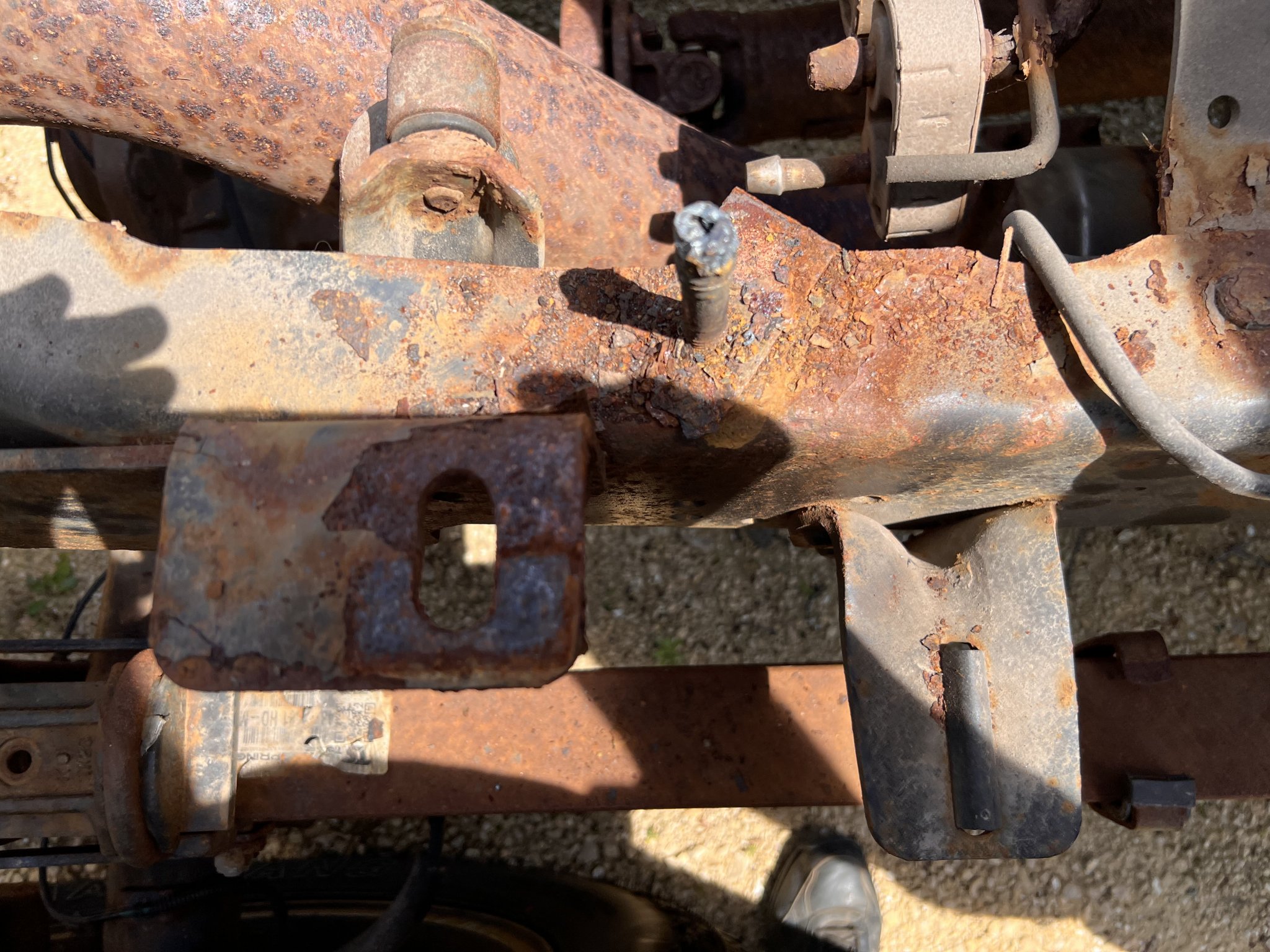

I've used something similar to that 30 years ago from Napa. Spray it on with a squirt bottle let it soak in, and the rust turned black. They all work on the same principle, convert the iron oxide into a hardened coating. The problem is, if you dont clean all the paint a good portion away from the rust, it comes back. The other problem is if you don't get the paint applied properly afterwards, the rust comes back. For proper rust protection, it is best to try to get rid of all the rust, but then you leave behind thinned metal.

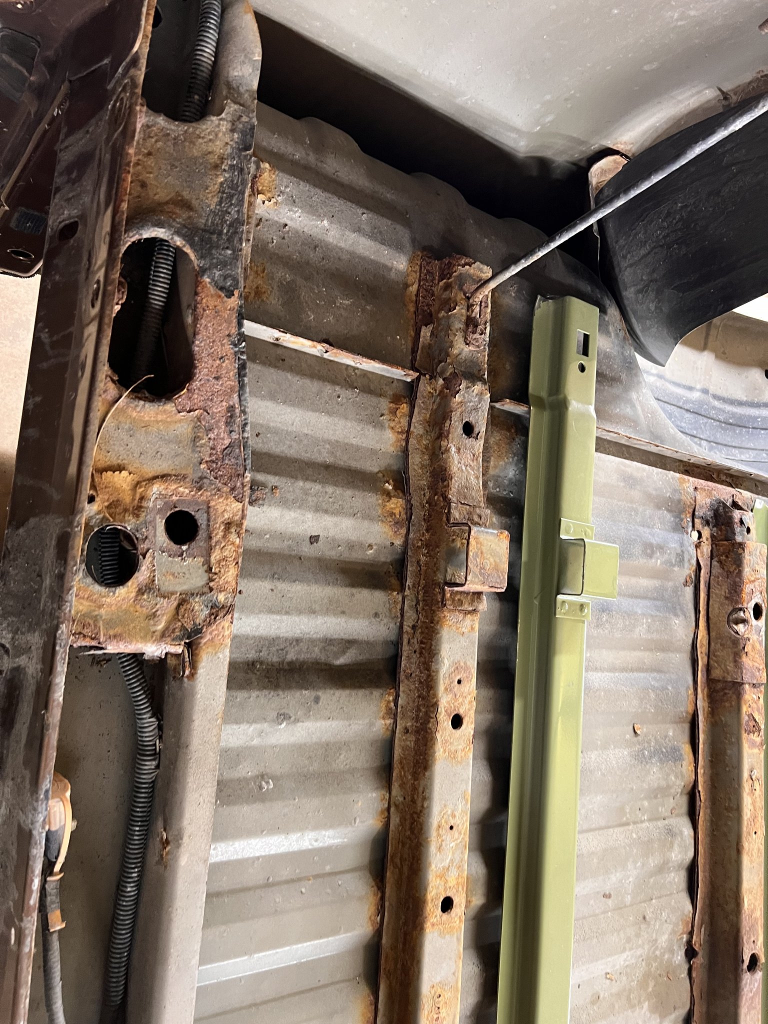

SO far I have the bed off and the front crossmember replaced, with all the rust removed in that section, now I am working on the middle two supports which are gutted, along with a good section of the floor. What was rotted on top, is nothing compared to what is underneath. Only rust on top went all the way through and made a huge hole, but the rest of the bed looks good. Underneath though the entire area under crossmembers is rotted, at least halfway though the metal, leaving very little metal when cleaned. I am going to have to stitch in new panels to replace the rotted one and then weld in the new crossmembers. The second to rear member will need to be replaced, but so far the sheet metal underneath seems to be salvageable. The rear crossmember was rusted up pretty good, but is made from thicker metal and salvagable. It is also a difficult piece to replace, so I will patch in some sheet metal where the one brace was too thin. Once I get the parts replaced, give it a good degreasing and power wash, I will soak all the left over rusted areas with POR 15 and then hurculine it.
The truck frame is not as bad as I thought, wont take much to clean it and it too will get a POR 15 treatment and painted black.
The truck frame is not as bad as I thought, wont take much to clean it and it too will get a POR 15 treatment and painted black. View attachment 82466 View attachment 82467 View attachment 82468 View attachment 82469

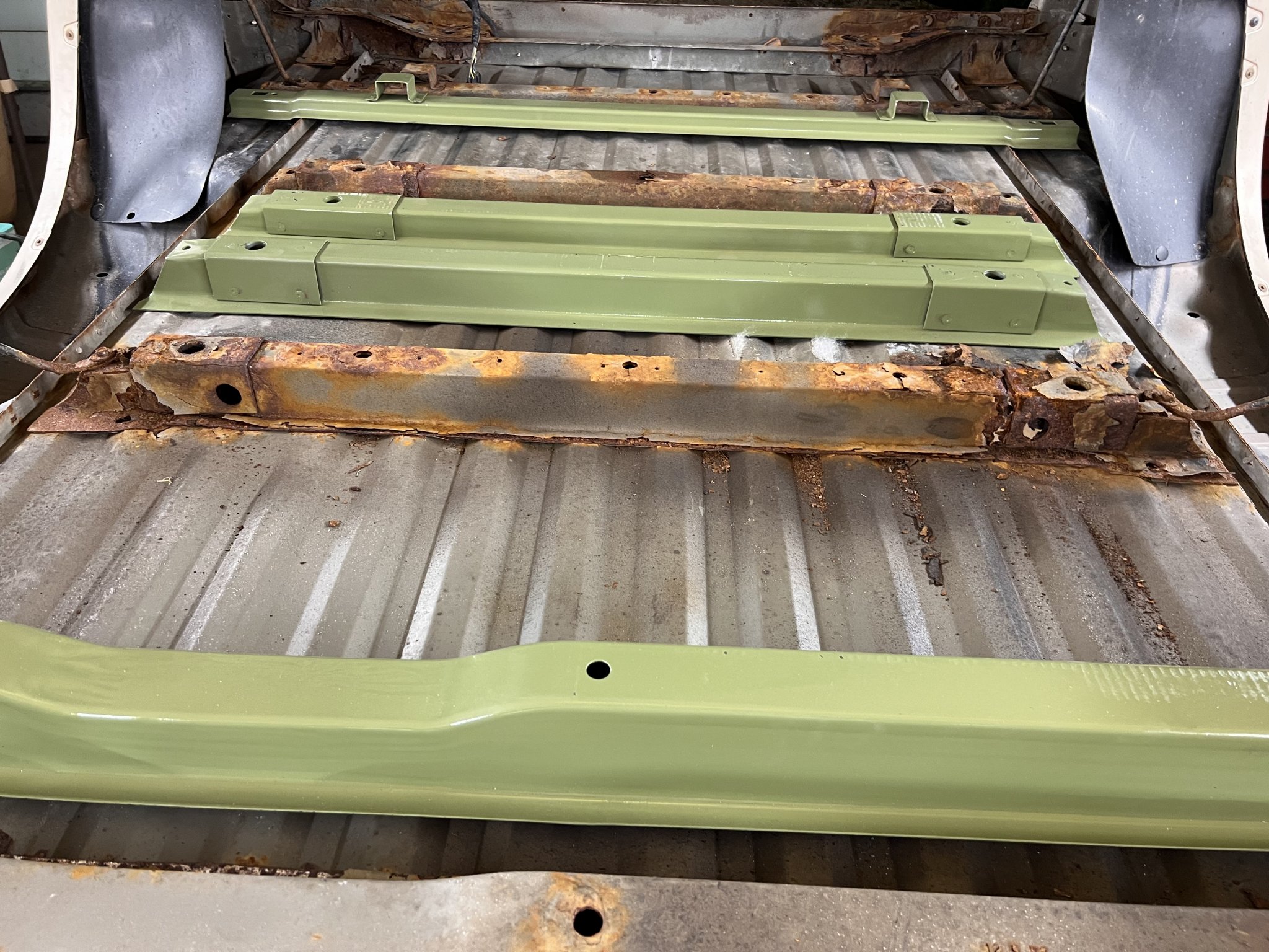

Well, the floor is patched, front cross member installed, second should be done today, possibly get started ripping off the third one and the other parts are set to arrive today, so hoping by Monday to have the repairs completed so I can move on to paint prep. After all the time it took to patch in 3 small panels, I decided that to cut out and replace all the rest where there is still decent metal is a waste of time. I am still not decided on if I am keeping the truck or not, so don't want to put more time into it than needed to make it tow worthy again.
What I have planned is after the crossmembers are in and everything is cleaned up, I will spray a healthy does of Rust Mort on everything, let it soak in and cure, then prime and undercoat it with Herculiner. I also have some inner rust prevention spray to coat inside all the cross member on the way. It's the same stuff used to spray underneath as an under coat, but with a special hose and nozzle for getting in tight spots.
I will have to repaint most of the bed sides and do some work on the bed itself inside, but that too will get Herculiner. Between the bed and the bumpers, the truck will be looking pretty good so if I do decide to sell I should get top dollar for it.
