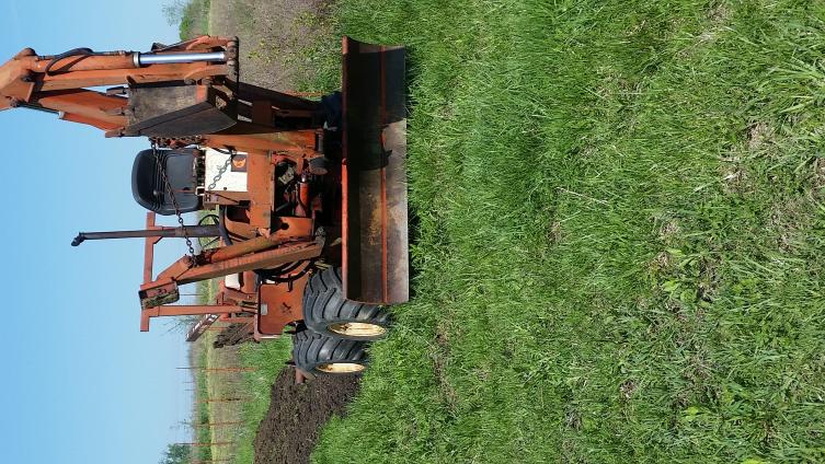

Have 5 acres with a house. The 4 acres outside the yard has water on it except in the heat of the summer. The neighbor has a pond that I am sure leaks and I dug a line between his pond and my property line 2 years ago trying to keep his water from coming over. It's still wet, so I decided to dig a ditch on my side and bury a tile there.
I moved my trencher over there to get ready for the work. I decided to dig a few feet to see how I might expect it to go. I worked the boom down to about 30" and proceeded about 60-70'. When I pulled the boom back up and shut the machine off there was absolutely no water in the ditch. The dirt was moist but not real wet.
The third day I came back to finish the ditch. The line I had left empty was filled to the top. We had no rain during that time. Here are some pictures.
Since I got the ditch dug we have had about 8" of rain (8 days time) and the ditch has been running since I finished.
So, since the trencher throws the crumbs out on both sides of the auger which will keep water from running in the ditch, is my neighbor's pond contributing, do I have a spring, or both?

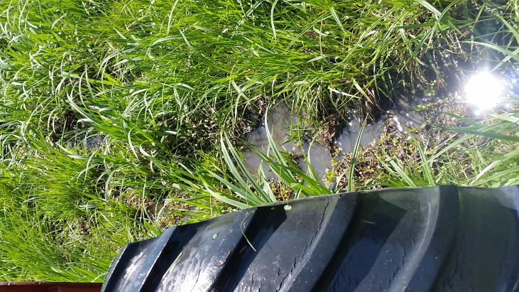

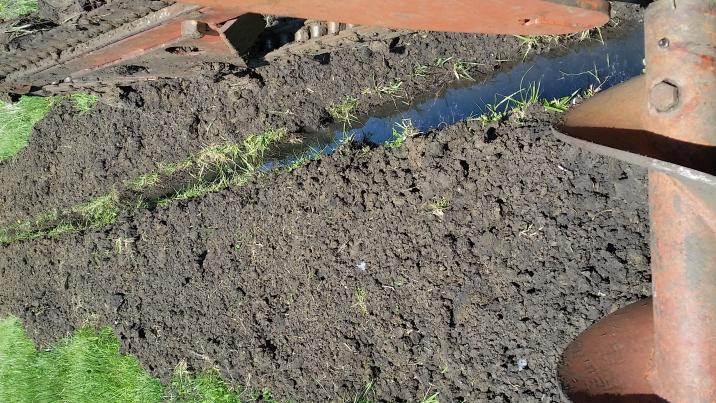

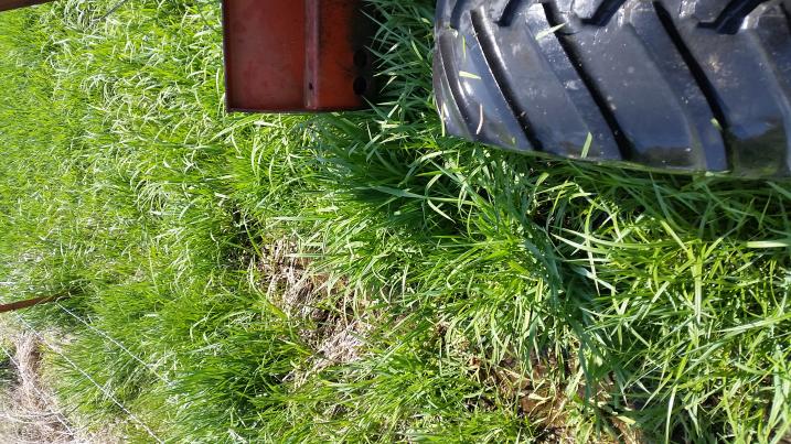

The first picture is the water that accumulated during the first two days of it being dug and setting. (I don't know why the pictures are sideways. The only thing that changed in my technique is I now have Windows 10 instead of 7).

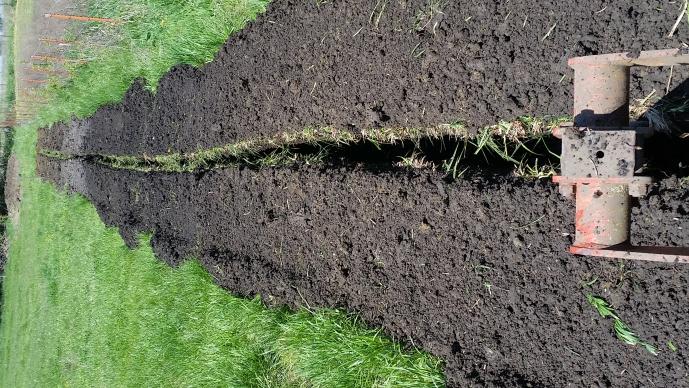

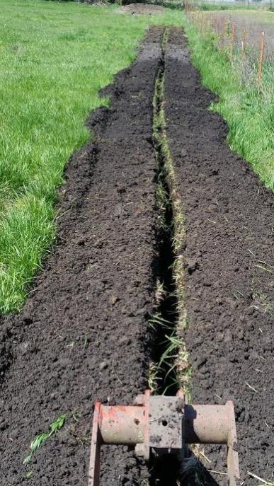

The third picture shows the crumbs through the trench the day I was digging. You can see the 60-70' of fairly dry, then the mud I dug out, then back to fairly dry dirt. I didn't pump the water, just dug!!

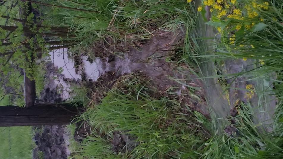

The picture showing where I was going to show weeds on the other side of the fence. That is the neighbor's property and the weeds are there because I dug a "ditch" for him there and he never bought any drain tile to put in, so it's open and he unable to cross it to mow. He mows up to it. That ditch on his property starts at the base of the side of his pond about 10' from my fence (literally 6-8' from where the slope starts up) and runs parallel to this trench I dug on my property.

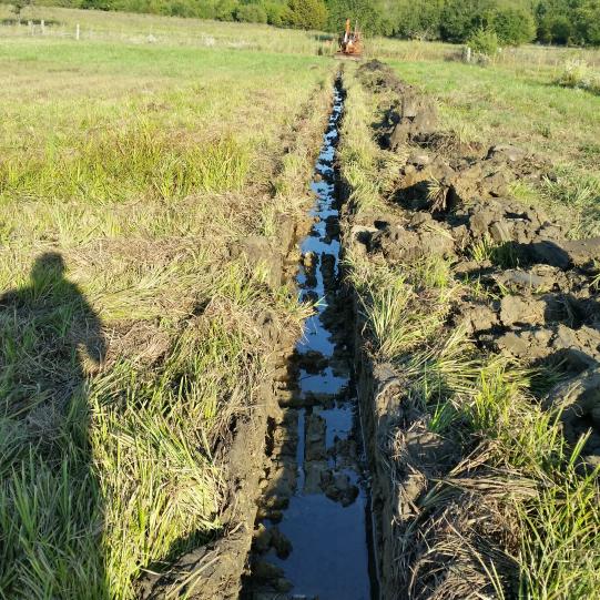

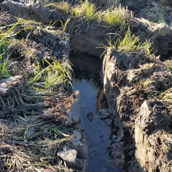

Here's a couple of more pictures showing the water that was setting on the ground when I dug. The rule of trenching is if you grab a handful of dirt, make a fist, open your hand and let it fall out, it should not be stuck together when it hits the ground! I violated that rule. After I hit water my intention was to dig with the hoe, but I just slowed down and mudded my way through. My trencher has flotation tires or it would have been a problem getting through some of the spots.

When I dug the first section I kind of expected to find moisture at the bottom wanting to move, but it was dry at that time. In the second set of pictures water was setting on the ground and as I moved forward with the trencher I could see water moving away from the tires like pushing on a sponge. I think there has to be a spring there somewhere.
I think I will leave the think alone until about Aug. then see if it's still flowing. I'll clean it up some and put a tile in with rock on top.
When I dug the ditch for the neighbor I started on the South West edge of his pond which is 20' North of where I started on my side. I dug 100' East, then started curving to the North. I was using my hoe there. I got bogged down, I mean stuck, like all the way to the frame everywhere. Had to have my neighbor come pull me out with his M9540. Only time I've EVER been stuck with that trencher!
Here's a picture of the ditch I dug for the neighbor. The fence to the right is the fence I am digging near on my property.

One thing really caught my eye in your first post picture #3. See the grey streak in your ditch? (I'm hoping to attach rotated) There's some nice looking dark brown and red soil on either side of that grey streak.
Red and brown soils can mean there's enough oxygen to keep the soil's iron oxidized...meaning isn't water-logged. The grey color can be reduced iron, since there's no oxygen...meaning water logged.
Grey streak can also be a clay streak....
Either can be an indication of a wet "seam," maybe a spring, or something else, but it's wet...
Can't tell elevations from your picture, but is it plausible that "grey" spot essentially filled the rest of your ditch?
Trust me, my Soil Science classes were MANY years ago, so I offer with no warranty. I dealt with a lot of household sewage systems since, and that spot would cause me concern if I was looking to put a system right there and came across a big variation in the color of the subsoil.
Just wanted to offer my humble opinions...for all I know, it might just be drier than the other segments...but it looked different enough I wanted to point it out... Thought if I could be of help, I'd try....

RCW, the difference in soil color is caused by all the water that filled the trench from the time I started until I came back to finish. You can see in the first picture the trench is full. I just put the boom in and started digging....sling mud out as the water was mixing with the soil.
The trench is about 320' long and drops 13' in that distance. I had contacted the local soil Conservation Technician from the Ag. Natural Resources Conservation Service when I dig the trench on the neighbor's property. He came out and inspected to lay of the land the pond, past notes and maps and approved of the proposed method of draining the water.
