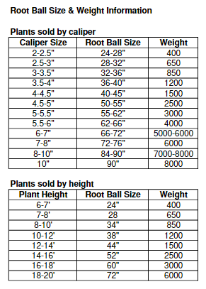

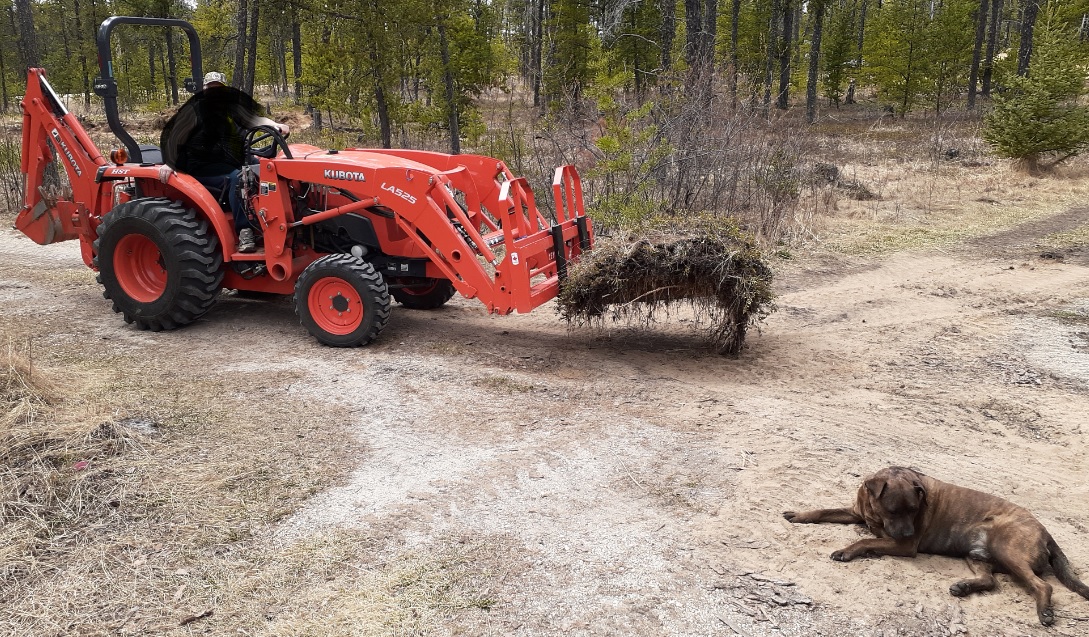

I researched same topic for the larger L3301 and came to the conclusion not really... sure some say maybe but really pushing it so concluded a no.
What I have been doing is using my backhoe to make 4 cuts around the tree creating a root ball, then loosen the root ball using the backhoe, then switch to the loader with pallet forks to pop the root ball out of the ground and move it to the new location.
I am in very sandy soil and like to take big root balls as tree survival seems higher doing it this way lets me move about 5' tall Jack Pine with good survival success. This maxes out my loader lift capacity. Jack Pine roots are wide and shallow in our sand.
I could move about 3 trees an hour around my acreage this way.
Check out the chart below.... root balls are HEAVY!! you can quickly see the L2501 just not going to be up for the task of moving anything too big.
