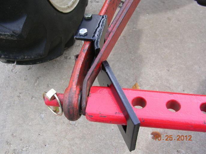

Yes, they make a steel plate thingy to tie it to the lift arm so it doesn't rotate though. Found a picture.

As Jim mentioned, you need a bracket at the end of your drawbar that goes over and under your 3pt arm to keep it from turning.

I might also note like in jims picture the three point was locked into place as to not be able to free rise on it's own.
Here is a better setup.
or a way to improve the bar you have.
or there is the bracket as jimr63 pointed out.

The solution was the torque arm to prevent twisting and a pair of flat stock links that tied the draft arms to the top link point creating a triangle which would prevent the arms from raising and moving side to side.
