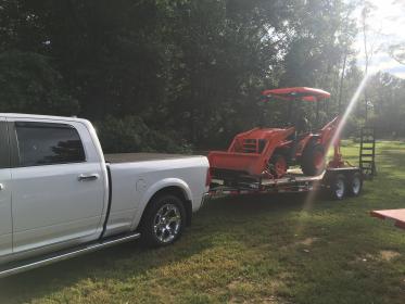

I am not sure what section to post this in, so I hope this works. I am scheduled to pick up a b26 on Saturday and I want to ensure I am prepared to make the 2 1/2 hour journey home. For reference, I have a 2015 Ram and a 18 foot machine trailer.
I picked up a 14 ft 3/8 inch chain and a second 20ft 3/8 inch chain. Each chain has a hook on each end. I was planning on using one for the front and one for the back. I have two 9200 lb ratcheting binders, one for each chain. Is this enough?
Lastly, I have a heavy duty ratcheting strap (10k I believe) that I was planning on strapping to the front bucket and finally a 1500 pound ratchet strap for the rear back hoe bucket.
Is this reasonable and are there any suggestions? I want to ensure I am adequately covered. Thanks.
