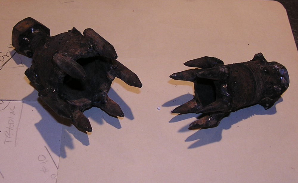

Here is what I made years ago for these problems. You tap it onto the filter for indents. Then drill the holes for the points. Works every time. If you finally have left only the base plate, you still can get it off. The points are welded on a piece of pipe. A big bolt is on the other end.
