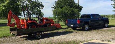

have to agree with ya dalola. Before I had my dump truck for a part time landscaping business, I used to tow the BX23 tlb with my dodge dakota. Even though the trailer had brakes on both axles, it managed to push the back end of the truck around on two separate occasions (once thru a 4 way stop). That was enough for me. I knew I needed a real tow vehicle and there is no way I would trust a trailer of any kind without brakes when pulling any more than 2K.
To each their own. Just hope none of you learn the hard way.
PS....OP- Congrats on your new purchase. You'll love it. They are a real little workhorse.
I'm curious why you had so much trouble with tandem axle brakes. With my single, it almost stops too good. Granted, a BX23 is a good bit heavier than my 2230, but not THAT much more. For what it's worth, I wouldn't try to haul a TLB on a single axle trailer either. That's a bridge too for in my opinion, and the required trailer size would negate the single axle advantage.

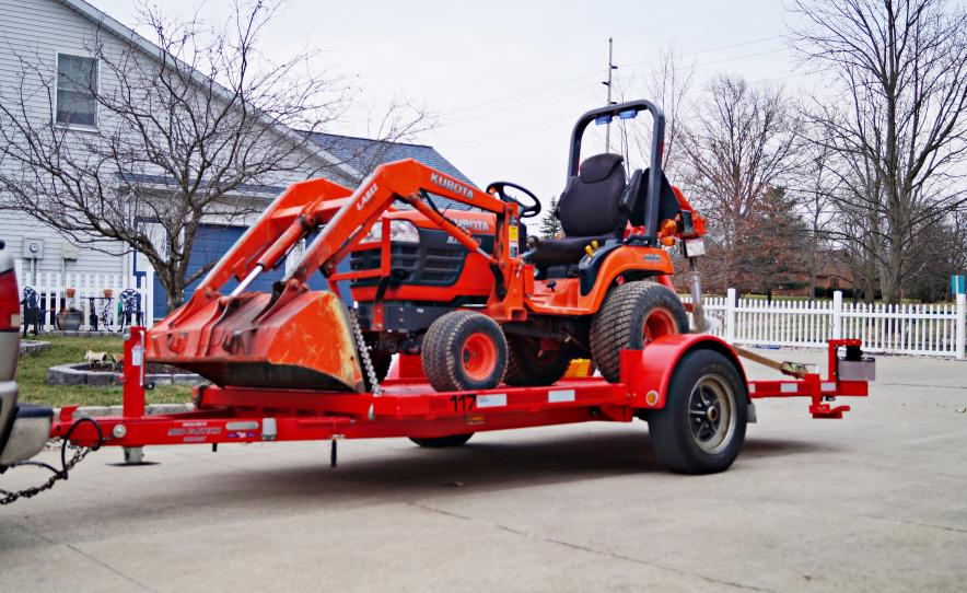

I have a single axle. As long as the axle is rated for the weight, and as long as that weight is properly distributed, I don't see that as a serious issue. There is an advantage of better maneuverability, but increased difficulty backing straight and less flexibility in weight distribution.
I think it is far more important to have trailer brakes than an extra axle. And having tried both, I strongly recommend a proportional electric brake controller over a time-based electric brake controller.
And maybe they can't be seen at that angle, but make sure you have straps or chains to the rear axle of that rig too!
Also need a strap on the FEL.
lol, i had a strap for the rear and i did put one around the FEL. just took the picture before the strap on the FEL. It quit raining for like a minute so i took it as a photo op before the bottom fell out of the sky. Im glad i have leather seats in my truck because i was dripping wet by the time i got in. But it was still worth it! :)
Trailer is 2K, gear and tractor 3.5K. Easily pushes around a very light duty truck in certain conditions.
