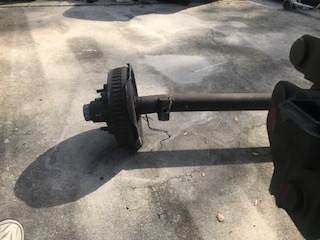

Big Tex trailer 14GN 7000 pound axle. Rating on the trailer 15,000, empty weight 5600 pounds with 8700 pounds payload covering 24 foot of the 30 foot deck. The load was with at least 1300 pounds transfer to the hitch. One small pot hole at the edge of a bridge bent the axle broke 1 u-bolt and bent 2 more u-bolts. In addition to 1 $200 14 ply tire. This has cost me at least 2 days of work. The cost of the new axle is unknown yet. [ $511.00 and will not be shipped until Jan. 2020]
