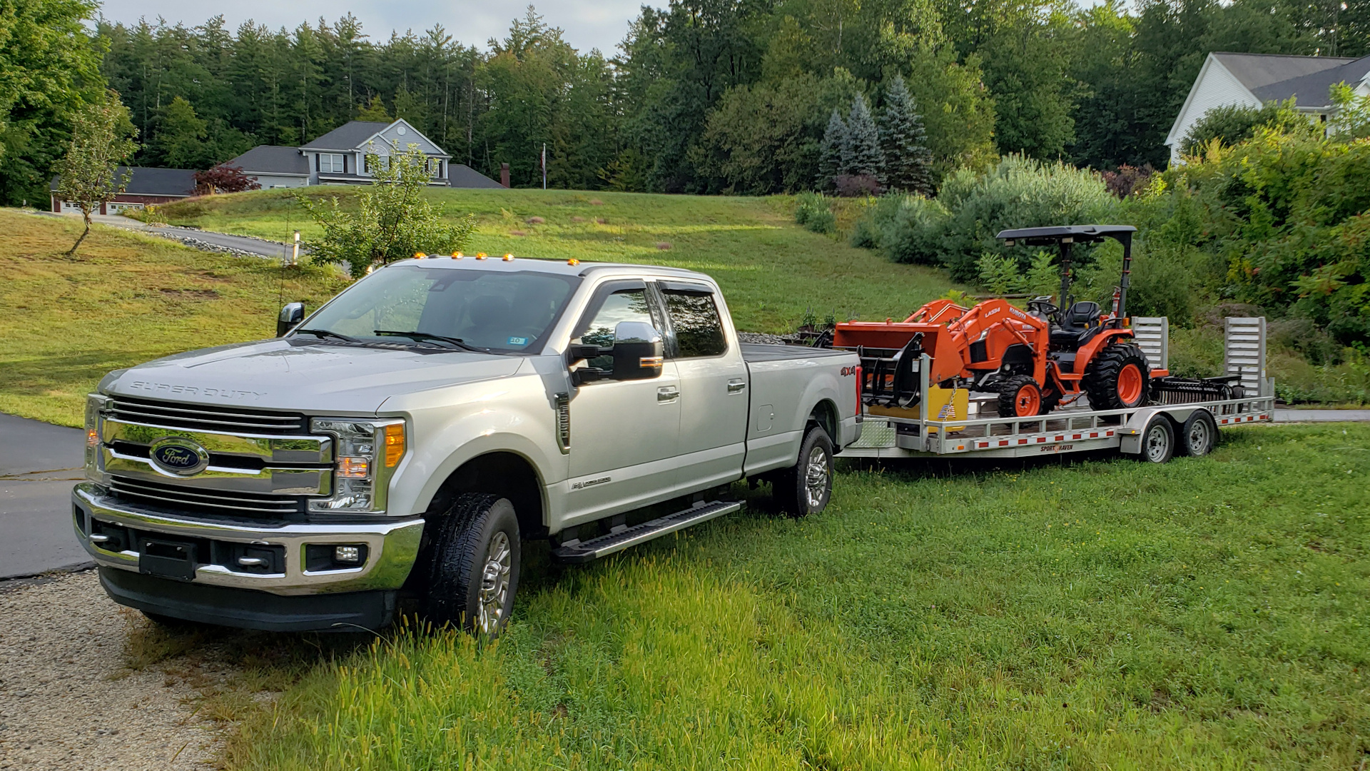

I have a 20' for my B2650 and wish it was a 22'. I guess it all depends on what you need to bring and how often. A 24' would be perfect in all regards except length. I have a Quad cab long bed and that is already long.
