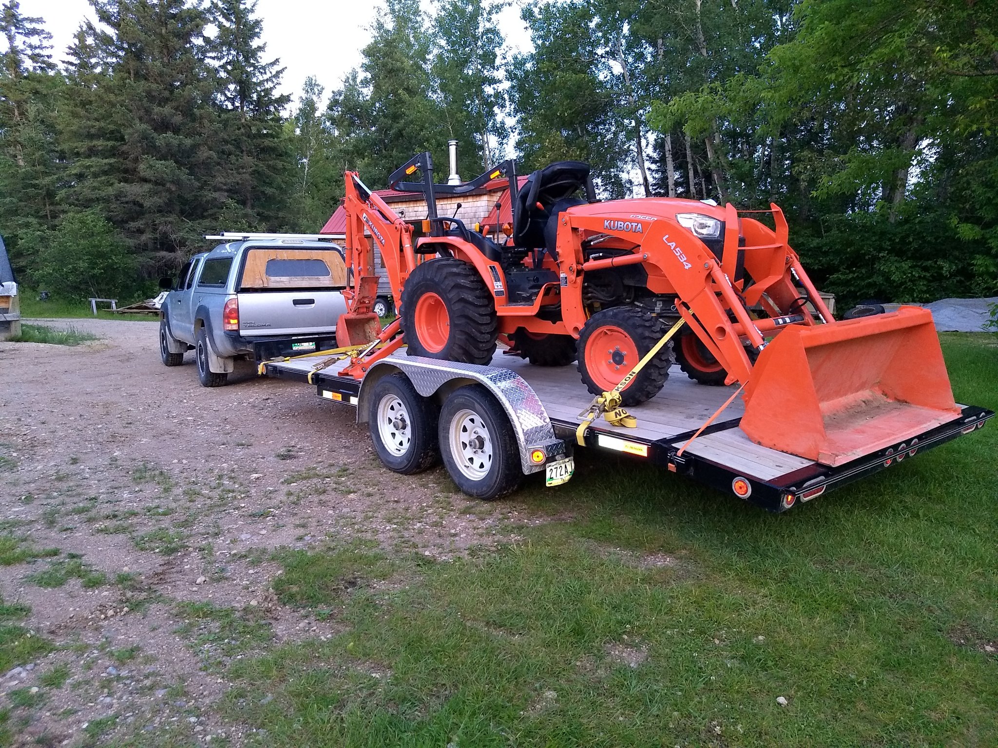

I've been hauling my B2650 with BH77 backhoe and FEL on a PJ 18' beavertail trailer, with brakes both axles. My truck is a 2006 Tacoma 4x4, 6,600# towing rated.
Tractor: 1800#
FEL w/54" bucket: 475#
BH77 with 16" bucket: 950#
Total 3225#, rounding up to 3500#.
3500# + 1800# trailer = 5300# gross. Within truck/trailer specs.
The main thing is that hauling this load handles very well for me IMG_20190710_213154312 (1).jpg .
