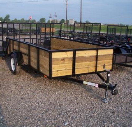

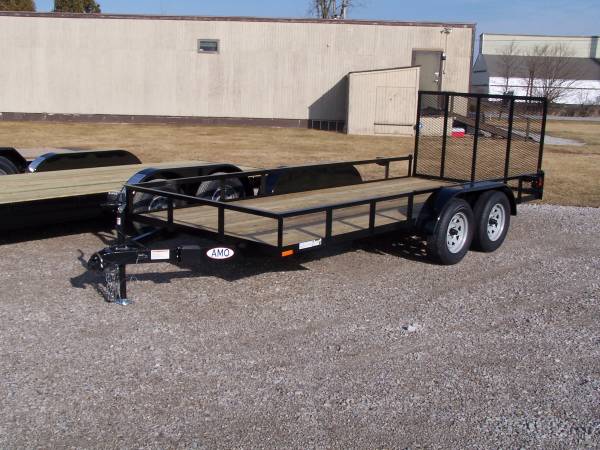

I am looking to purchase a trailer for the B2601. I am considering a single axle 3500# units. I do have concerns about it being single axle but I am towing with a half ton 6cyl truck so I am watching weight.
The question is does anybody use one of these style of utility trailers to haul a 1600 pound tractor plus implements? and how does it perform? Do any of you more experienced guys have an opinion on this?

I have a 16' trailer with a big mesh drop ramp, the trailer is the perfect size and holds the 2650 and attachments, you can find a nice used one on craiglist for around $1000, the mesh gate is not the best and makes it impossible to let a bush hog hang off the back

to answer your question... yes... I pull my BX with FEL on a trailer like your bottom picture.

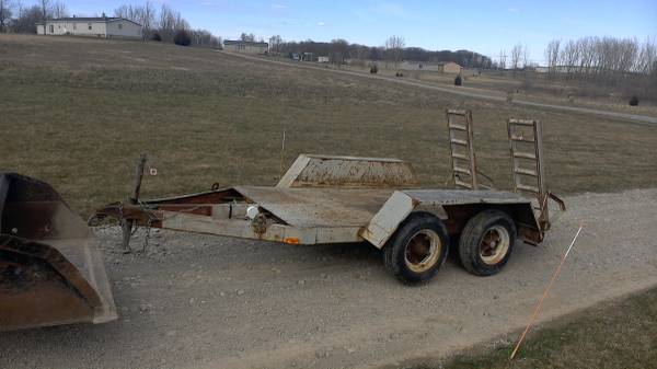

I found dual axle landscape trailers for 1450-1800$. But searching craigslist I found this guy for $500.
It is rather short but the price is right.
I agree being tail heavy in any trailer will cause sway. If I can find a Tandem in my price range I will go that way. I dunno if that short tandem in the pic would be a good one for me it is just to short. The 2601 with loader and tiller would be to long for it.

Ryan, I see you're towing your L2601 with loader and tiller now? Are the tires loaded? What about other implements in the future? Buying a "slightly larger" will never be a regret...but having something too small and overloaded? Definitely.
I agree with your direction to grab a legit landscape trailer with a little extra length for what you need "today". Add on a bush hog and you'll need another 2+ feet of trailer.
