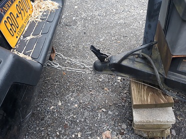

I just took pictures of crossed and not crossed. Of course vehicles not moving or dropped hard.
The proof is.... wait for it...... I have far too much free time on my hands.
image one is NOT crossed

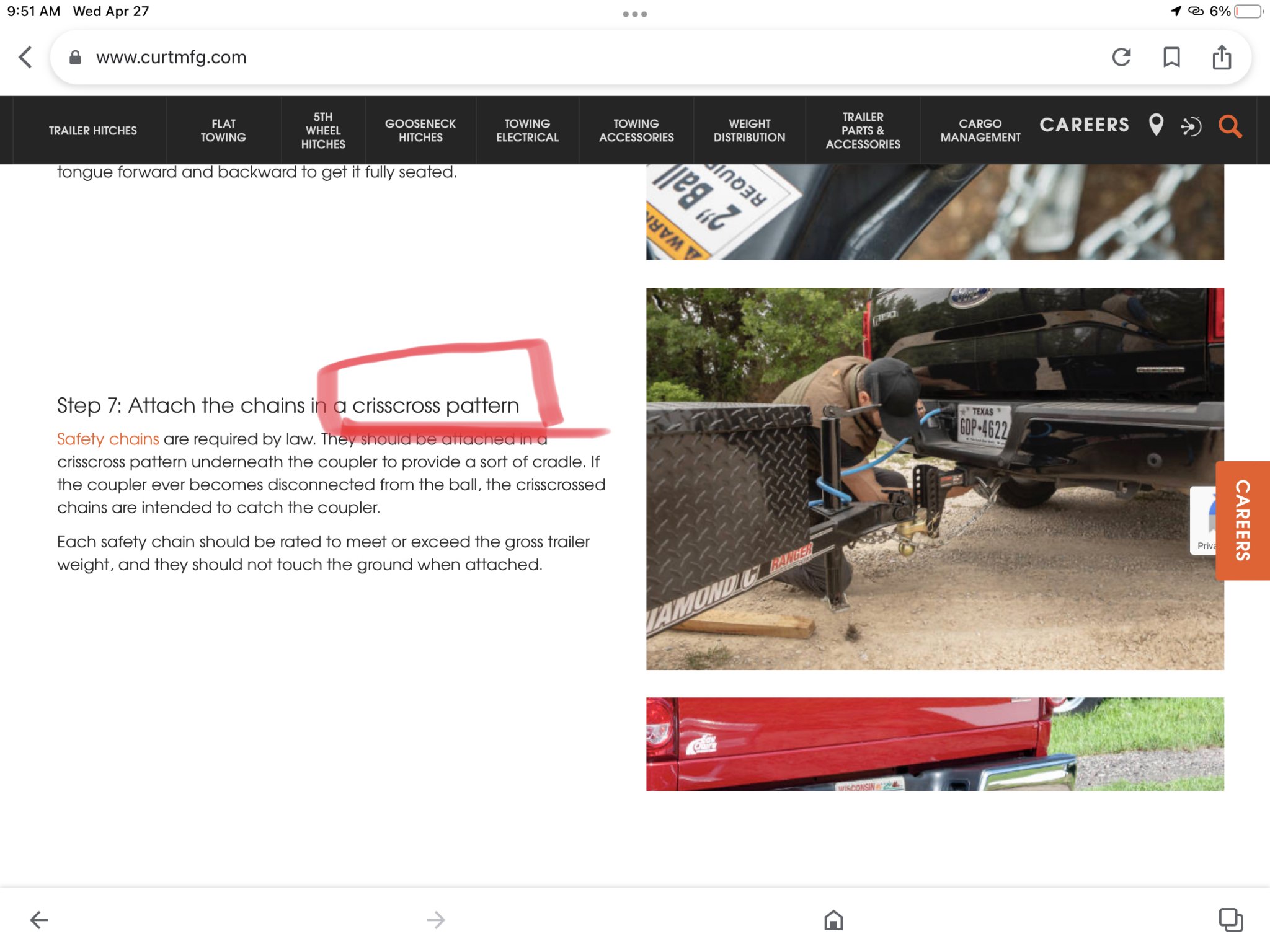

Anyone that refuses to follow the manufacturers own instructions because they know better is delusional.
Curt’s own requirements are the chains should be crossed. End of conversation. MCMXI stated he owns a curt hitch. Here is their instructions:
I should have posted this days ago……
8,001
5,187

nice pics but... if you have a wee bit more time, take some of them NOT resting on the block. It's hard to tell but it 'looks' like, if allowed to be 'free'( as on the highway..) the tongue of the trailer will roll fwd and down really close to the pavement ?
also... neighbour's friend wants to haul a 17' canoe on a 5by8 trailer, say 2' front overhang..that'd leave 7 FEET of canoe 'out the back'..I think he's 'nuts'....
Yeah, I know. I lowered the trailer until it was apparent where the unit was heading. There is no real way to test without a camera on the tailgate and taking the camper onto the highway and hitting a really big pot hole and having it come off the ball.
I agree that at low speed something is going to hit the pavement. On my camper it will be the jack and on my landscape trailer it will be the front of the trailer.
Let's face it at 65 mph it is a crap shoot.
