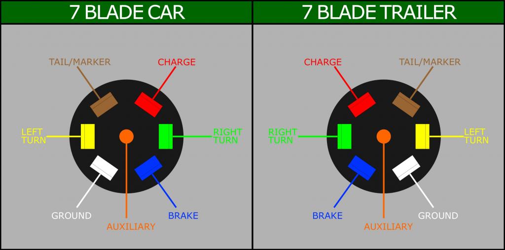

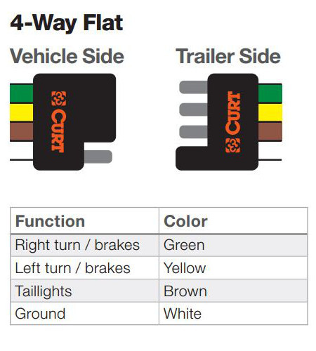

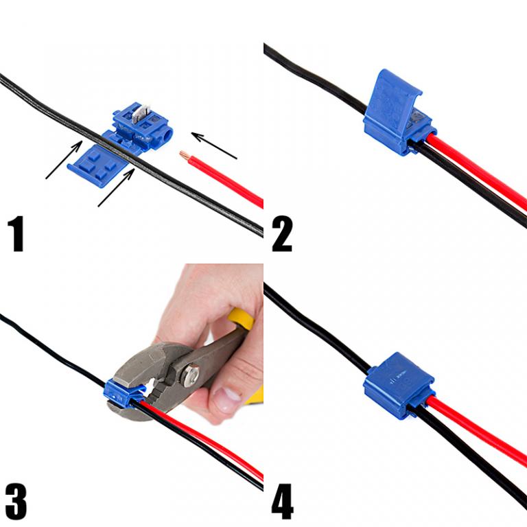

Determine the wiring connector on the trailer. Go to your auto parts store and purchase the VEHICLE SIDE connector that matches the trailer connector, some GOOD electrical tape, and a pack of wire taps (1st attached picture). I attached wiring diagrams for two of the more popular styles out there, 4 flat and 7 round.
1. Attach the yellow wire to the green wire with a wire tap. This ties right and left stop/turn signals together. This is OK on a tractor since you do not have separate turn signals.
2. Run the three remaining wires to the wiring for one of your lights.

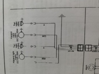

3. Attach the brown wire from the connector to the tail light wire using a wire tap. It appears from your tractor's wiring diagram (see attachment 4) this is the brown wire.
4. Attach the white wire from the trailer connector to the ground wire. This is the black wire.
5. Attach the remain wire from the connector (green or yellow depending on how you tapped them together) to the hazard/flasher wire. This will be red with a white stripe on the right hand light, and blue with a white stripe on the left hand light according to the wiring diagram for your tractor.
6. Wrap all four wire taps in electrical tape to help keep moisture out.
If you have a 7 pin, 5 pin, whatever pin connector, don't worry about the other pins, you do not need to wire them in your application.

A BX2380 does have separate Left and Right turn signals as your wiring schematic very clearly shows. It makes absolutely no sense to bypass this feature.

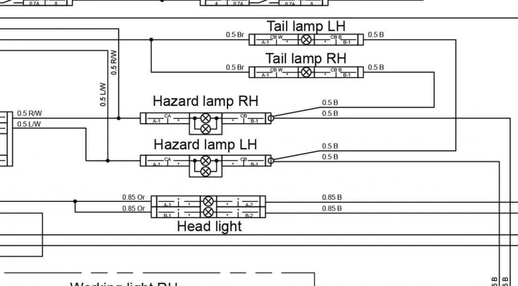

@PitViper...
WHERE did you get shuch a CLEAN,easy to read wiring diagram ? All the ones I've acquired for my BX23S are useless FUZZY ones....
since the 2380 and BX23s are 'cousins' , I'm wondering if your diagram would be applicable to my 'ride'?
Just because they are wired separately does not mean anything.
See attached documentation for my B1750.
If that particular tractor has turn signals, I would expect any half way intelligent person to realize this and wire accordingly.
In my past (and admittedly limited) experience with Kubota, if they are labeled hazard lights no turn signal function exists. If the are labeled turn, or turn/hazard then there is a turn signal function. If I’m wrong, I’d love to be corrected and further expand my Kubota knowledge.

@PitViper...
jay
Google lol
