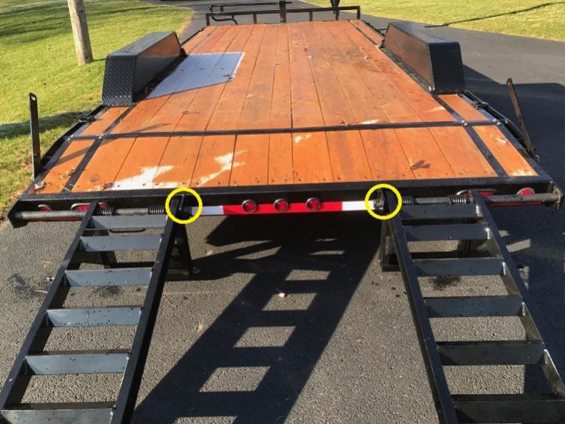

I also have a Tiger Cat 52" and a similar trailer with the same issue. I managed to drive mine up on the very edge of the angle iron but back back down was a definite pucker factor. A welder suggested welding a strip of 3" angle iron to the inside edges of the ramps which would be sufficient. Haven't done anything and had hoped there was some sort of expanded metal version that could be mounted to the existing ramps when you need it and removed when you don't.
Or just weld some mesh on it? if it wasn't that time consuming. I'll start calling around tomorrow for a welder. I may only be able to afford labor costs and moving them in 13 inches just to get me by. I'll see what the trade in value of the ramps would be for the upgrade. I'll keep yas posted in case it helps anyone else figure a (hopefully) cost effective solution.

^^^ nah that was plenty of info for anyone who wants to ask on the trailer ... lets work on your ramp problem.
seriously: if you just move that over to the other side of the ear with a longer bar..or full width bar...
you can gain any width you want that way with no welding.

A full width bar would work. I'll have to wait till next week to I speak with the dealer and see if he'll do the right thing by me. If not I may have to go another route.
I just got off the phone with the manufacturer. The deck was ordered as is by the dealer. There were no mistakes on the manufacturing end. So the error is his for ordering the ramps that wouldn't accept the 2650, let alone the scag.
The killer is the bi fold mesh gate is the same price as the existing ones. He wasn't saving me anything by ordering me the ones I currently have on.

If you only need 3 inches or so toward the center on each ramp and don't need to go back out to the fully spread width, get 4" longer pivot pins. Mount them so the excess length is towards the centerline of the trailer. Then move the inside ramp bracket INSIDE of the mounting tab. Pin the pivot so the ramp can't fall off and the pin is locked in place and you may have the solution! It will gain you between 36 and 8" narrower spacing!

So my issue has been resolved. Thanks everyone for the feedback.
I called my dealership. When I explained the problem, the sales guy said he would "get back to me in a few days and we're gonna take care of you." He got back to me a few days later, he did not take care of the problem.
He wanted to charge me 600 for a new set of ramps and extra for the cost of fabrication!!! When I argued my point and said it was his fault for ordering me a trailer that couldn't accomodate my tractor, let alone my zero turn. he said again he would talk to his boss and get back to me.
Thats when I decided not to wait around.
It was my notion that if he was going to do the right thing, he would have done it already. (talk to his boss or whatever story he was dishing out.)
and a thumbs down to my new dealer. So far every dealer in NEPA has been crooked. (This economy is bringing the best out of everyone.)
Long story short, I called up Load Trail, explained my situation and how I was getting screwed by the dealer. LOAD TRAIL stepped up to the plate, said we'll take care of it for you. They called the dealer, and now are sending out the replacement bi- fold, spring assist, mesh gates on their next scheduled delivery to the dealership. They will replace the ramps to the ones I NEED at no cost.
LOAD TRAIL. A name you can trust. :D
