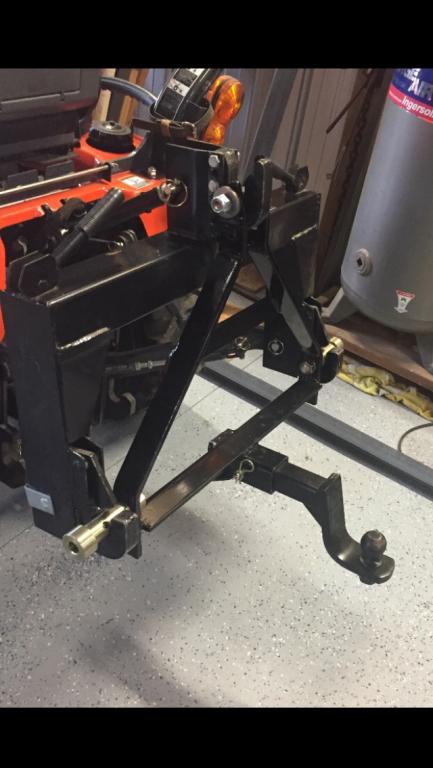

I have a ball on my 3pt, just feels more natural moving trailers around. Similar to a truck but with a much better turning radius. Either should work fine.

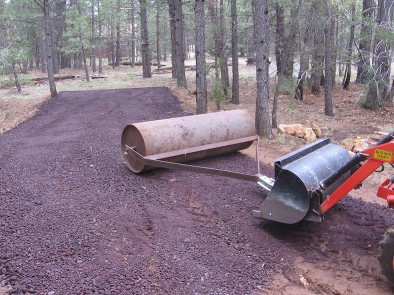

And my box scraper solution:
But keep in mind if the trailer is heavy and can lift the tongue, (especially suddenly) it can cause the three point lift arms to slam to the top of their travel, sometimes resulting in a broken housing for the three point lift. I know a guy who had this happen, and have read about others. Something that limits the upward travel may be necessary.

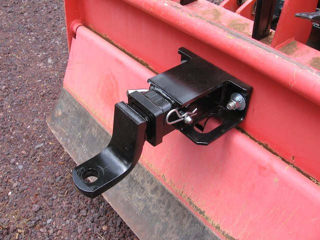

I got my welder neighbor to cut a 1" hole near the end of one of my forklift blades. Pop a ball in when needed for trailer moving. It takes some getting used to maneuvering loads with the pivot point so far in front of the the tractor.

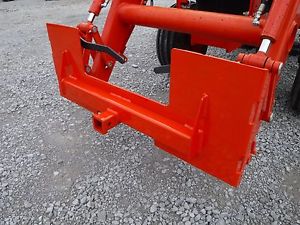

If you have a Quick Attach bucket you can drop it and slap one of these units on the front. I got mine at
Skid Steer Attachment Depot for $200. I bit pricey but very well made and it makes it real easy to see the ball to line up. You don't have to get off the tractor to move a boat or other trailer. The front hitch makes it extremely maneuverable to stab the trailer just where you want it.
