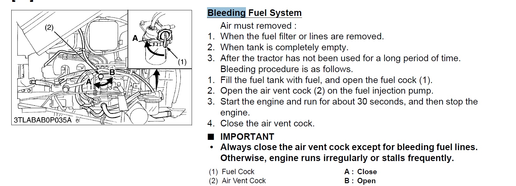

Could you please confirm this bleeding procedure below is the one you are following and you are not loosening lines.
