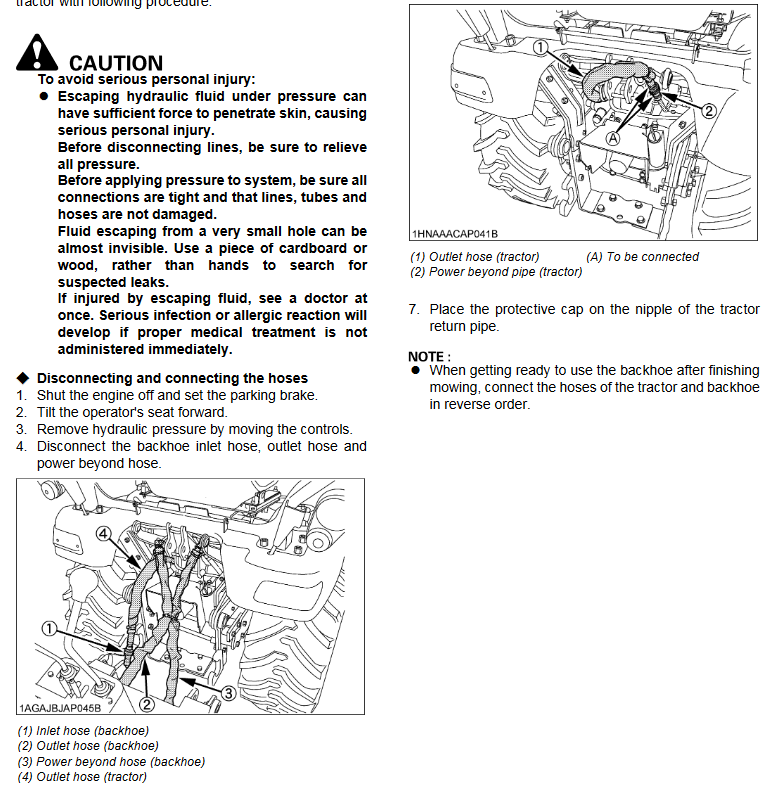

I just purchased a 3-point log splitter with it's own control. It has only an inlet and outlet on the splitter and I think that I connect them to the Power Beyond pipe and the return to tank connection(pg 51 of the manual), but I don't know if this is correct and the manual says that I can damage things if not connected properly. can someone tell me if this is correct?
6,963
3,354
No - the splitter will work but you wont be able to raise the 3pt. You connect it to the pressure out and pressure return lines. Tank return is not used.
6,963
3,354
Thanks Dan
I just looked at the image you posted and the terminology is a little screwy. So to be more specific:
You will connect the "outlet hose (tractor)" to the inlet hose on the log splitter valve.
You will connect the outlet hose on the log splitter to the "power beyond pipe (tractor)"
Thanks again Dan, I think I’ll have to wait until I can get some UDT fluid to flush out the factory stuff from the cylinder before I try to connect to my tractor.

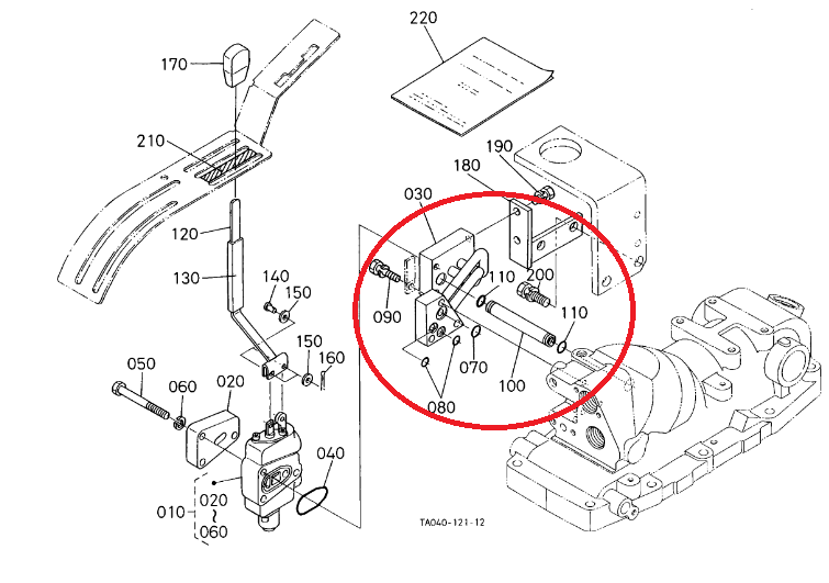

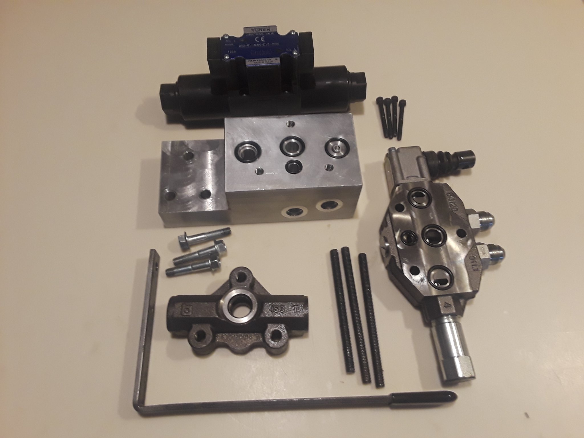

The Kubota valves are considerably smaller than those SV valve and the handles are called levers - a joystick operates two spools not one.
On the L3710 the factory valves also mount to the side of the transmssion with a custom manifold and end cover that only fits the Kubota valves. How exactly are you planning on mounting and plumbing a third party valve? I have spent a LOT of time on that idea (second and third images) trying to fit aftermarket valves to a L3901. Considerable machine work already expended and its still not 100% done.
