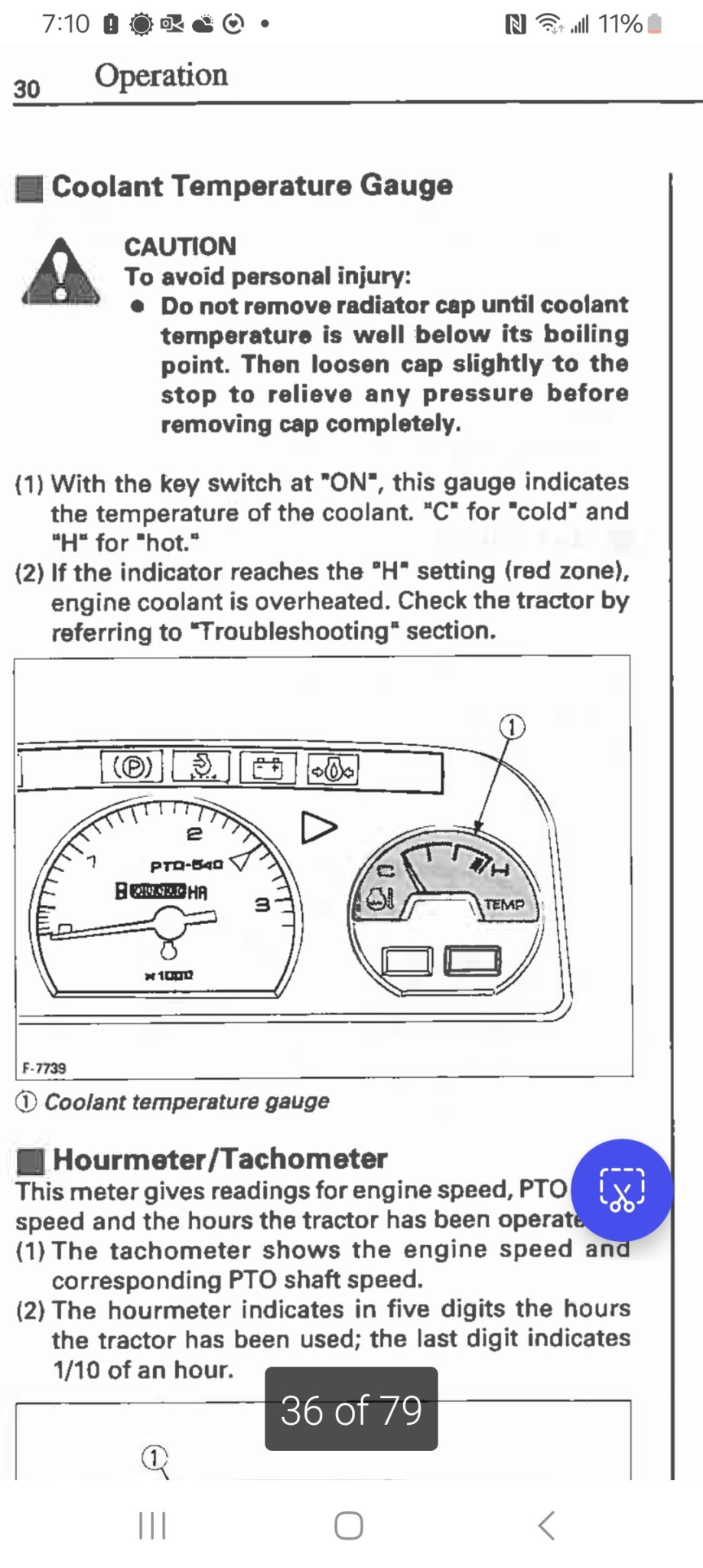

It starts like it is sopose to now.and my tractor temperature gauge ain't right.onlt barely moves off cold mark.and only on the first mark when over heated.which temperature sensor works gauge.mine has two on it.one by thermostat housing.and one towards back of head.

curious am I .
I only see one temp sender, on the head ,at the back in the online drawings.
Maybe it'd defective or the gauge. usually you remove wire from sender,ground it and meter goes 'full scale'. WSM should have 'how to test sender'...so many ohms when hot and cold.
it'd be nice to know what the other one is and for !
Until you KNOW, if you use the tractor keep a nose out for 'high heat ' smell ! Also, check fan belt tension. If it's a little 'loose',pump won't pump coolant and engine can overheat, then big $$$$$ to fix.
I am still doubtful it actually overheated. The bubbling noise you heard when you first turned it off is not unusual on a machine with a coolant recovery tank.
I would certainly fix the temperature gauge so I could monitor the temperature

Use an infared thermometer to check the water temp coming into and going out of the radiator. Then you will know if it's overheating or not. Do this as you are using the machine so you're not guessing.
