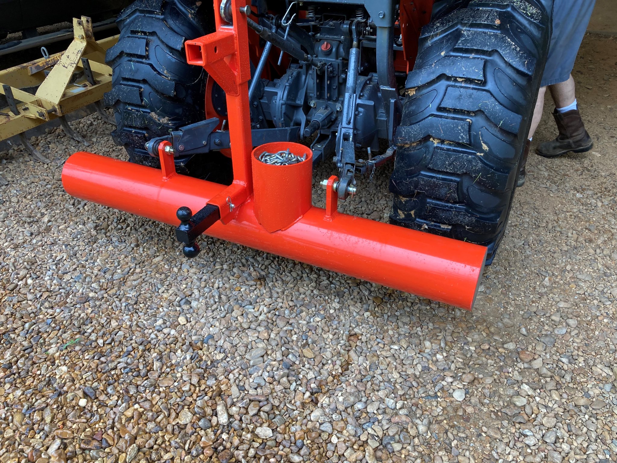

This is what I fabricated up 586#'s, the pipe is great at filling and smoothing ruts, pulling trailers/ goose neck and carries 40' (2-20's) of chain.

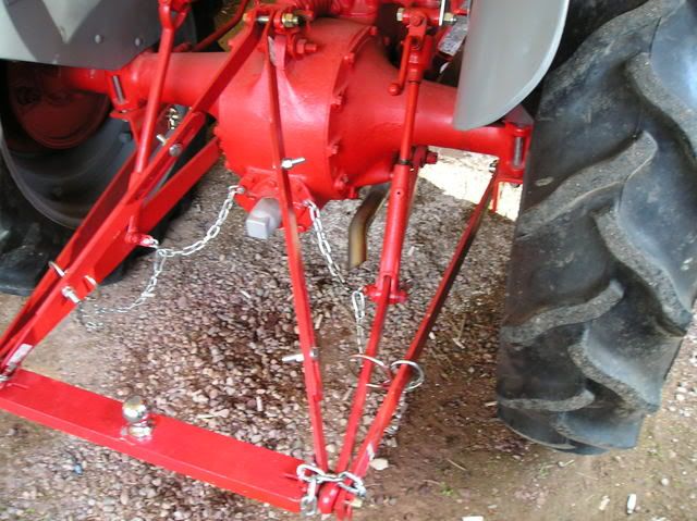

When towing trailers with the 11 hole draw bar the lift arms need to be immobilized. Old school example shown below. Notice the use of vertical as well as horizontal stabilizers and drawbar anti-roll locks.

THAT is the type which will still allow the trailer to Over-Run the tractor …unless you have some method of holding the 3-pt Down.
The use of chains as hold down devices will work…… BUT…don’t forget…. if you attempt to raise your 3-pt you are likely to damage/break your 3-pt hitch-parts, lift-forks, or other….until you Remove that hold-down.
In an extreme situation, the trailer over-run might also do this.
BTDT…. (this is how I learned to weld cast-steel lift-forks on my 9N)

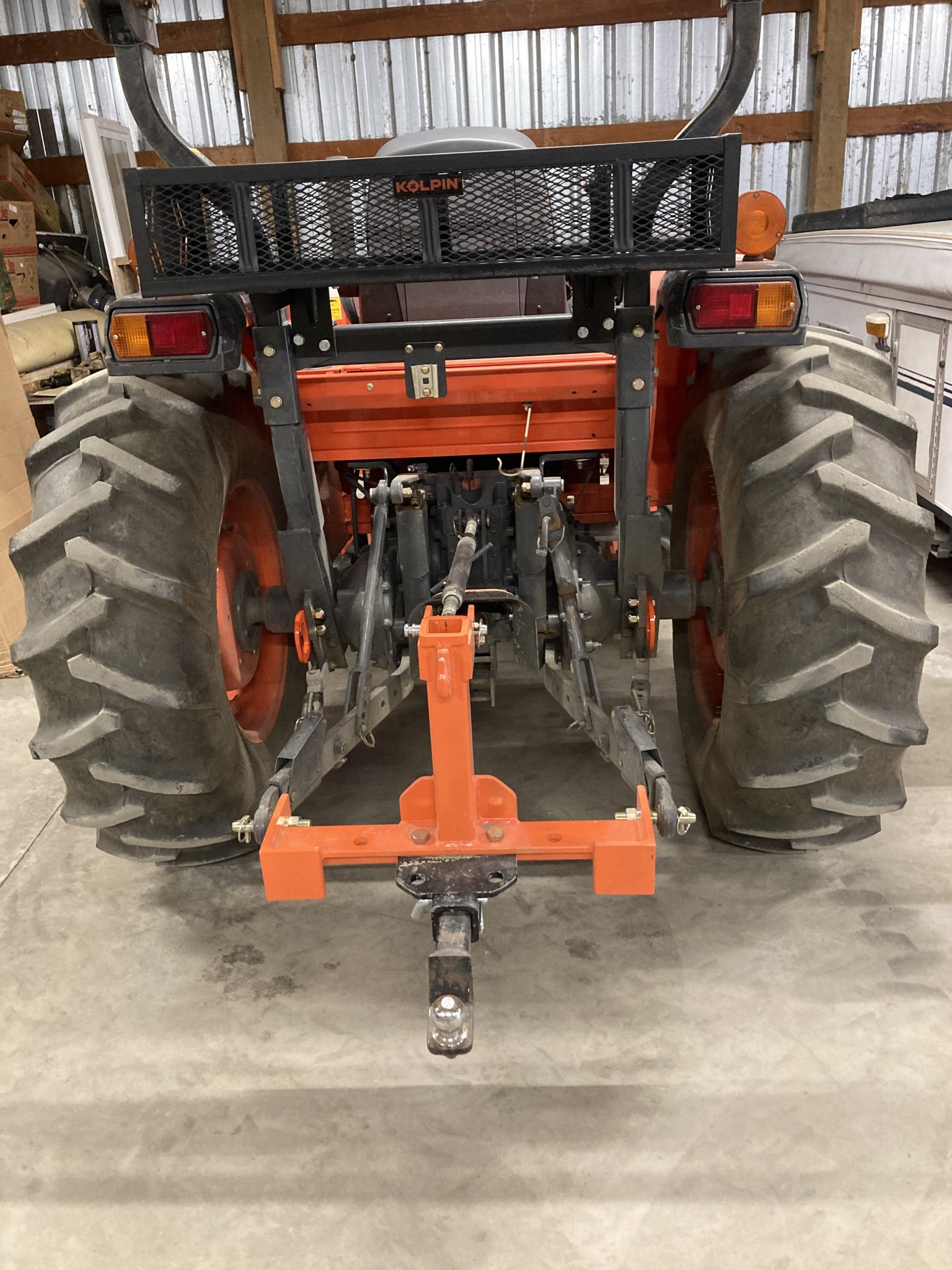

I bought this King Kutter receiver for $50 when I bought a used snow blower a few years ago. It was laying next to the blower looking a little sad, so I asked the guy if he needed it. He said no and that it was mine for $50. It's a very well made receiver and nothing like the cheap Chinese crap found on Amazon and other places. There's little I despise more than cheap, Chinese, ripoff crap!
Towing with a tractor shouldn't be an afterthought and something you're only prepared to invest $50 on. Save money with a cheap box blade, land plane, rake or whatever because those things aren't going to kill you. But I would highly recommend getting quality when it comes to the interface between the tractor and trailer.
This one has an eye for a chain to do what @GeoHorn describes above. If I had borrowed this King Kutter receiver from a friend I would absolutely have bought one for $300 if I wasn't interested in making one. There's probably $100 to $150 worth of material in the KK, and figuring in my time and consumables, buying wouldn't be a bad option.
