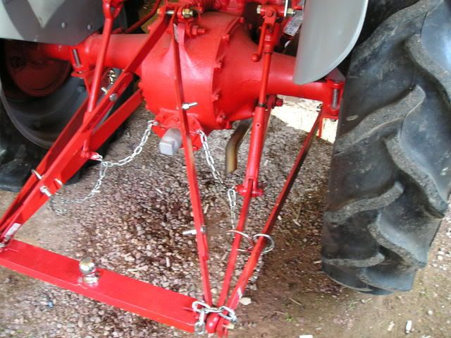

When towing trailers with the 11 hole draw bar the lift arms need to be immobilized. Old school example shown below. Notice the use of vertical as well as horizontal stabilizers and drawbar anti-roll locks.
This is how I did it on my 8N as well. Kept the 3 point from coming up when I stopped. Plus I was able to operate the trailer brakes with a couple momentary on buttons, one on each fender. Towed about 4 tons. Not saying it was smart.

The problem with towing via the 3-pt is….. Most 3 pts have no DOWN force….and when you attempt to stop... especially going down-hill…. the trailer tongue will LIFT UP the 3-pt hitch and the trailer will OVER-RUN the tractor. It can result in operator injury…and if the trailer happens to be a hay-ride full of kids….it can be particularly dangerous.
Very good point! The system I use now and shared the picture of indeed has that weakness. Most of the others similar to it have the same issue. As pointed out a chain would limit the upward movement. Although I like the compression struts on that old N better.

It's exactly threads like this, and posts like this, that make me glad to be a member.
For whatever reason, I just never thought about this happening.
I am quite sure that it has been said/posted a million times to "not tow for your 3pt", but for some reason I just never actually realized the "Why".
Kinda strange how the mind works,......I've read not to do that, over, and over, and over.......but I just kept walking through life Fat, Dumb and Happy........ but for some reason your explanation made the "dim bulb" in my head pop on. (y)

Design Note:
If using stay bars you may find it useful to also put a lockout on the lift control lever. If you forget even a weak sister 8N can bend them into pretzels and never break a sweat......:mad:
lol. Well…not saying my compression struts are both perfectly straight (anymore). I suspect it’s due to exactly that reason. Weak sister 8N. 😁
Also have a Jin pole (boom) that uses those same struts.
