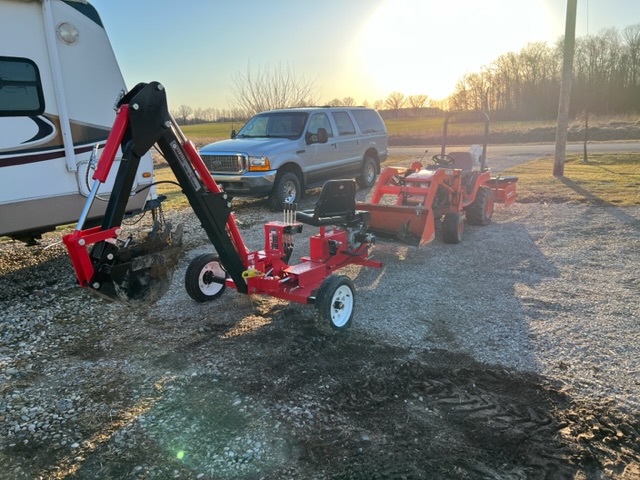

Might not technically be an attachment, but I use the BX to move it around the property.
Got delivered on Friday. Put it together and tested it out today. It’s going to take some practice to get efficient with it, but still a whole lot better than a shovel.

I have a hitchball on my loader as well as a drawbar with one for the 3pt.
The wheels switch to the back of the backhoe with metal stabilizer legs on the front when you are digging. To transport it the wheels swap to the front.
I am still trying to figure out how to transport it around the property without having to swap things around. It doesn’t take too long, but still a little inconvenient.

I used the loader with the ball to lift the back to remove the wheels. Then used the backhoe bucket to lift up the front one side at a time. I saw a video where you can lift one side with the backhoe bucket to swap the wheel to the front, but I haven’t tried that yet.
A common mod is to get an extra set of wheels, so you just lift the front with the bucket to switch from the out riggers to wheels without having to touch the ones on the back.
Once you are in the area you are working at you can move the backhoe around with the bucket.

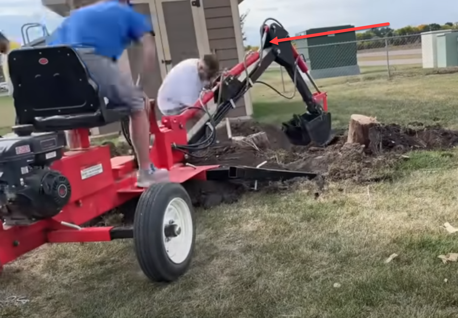

I saw that video. Said he bent it by trying to go to hard after some roots.
Yes and it has no weight behind it whatsoever...that means the cylinder took most of the forces. Not a great design...but you can make it work if you are careful. As mentioned better than a shovel!

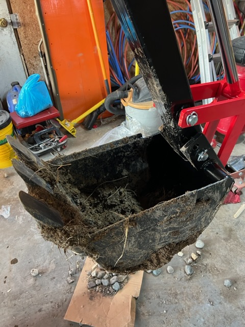

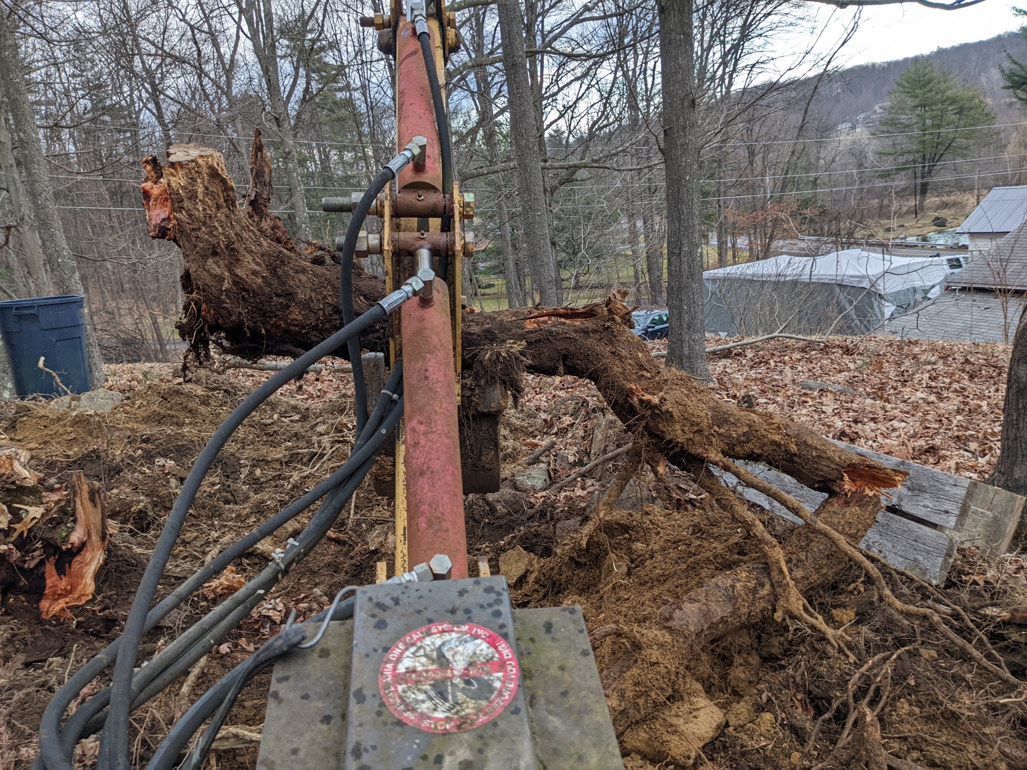

A couple of weeks ago it was dry enough to get out some. I dug up and old stump. Took my time and got it done without any damage to the machine. Worked pretty well.
Been way to wet to do anymore work with it. Main reason I got it was for trenching etc, not digging stumps.
14,317
6,545
Looks like it did fine with the old dry stump and that damp soil. That would be more difficult work then simply digging a trench.

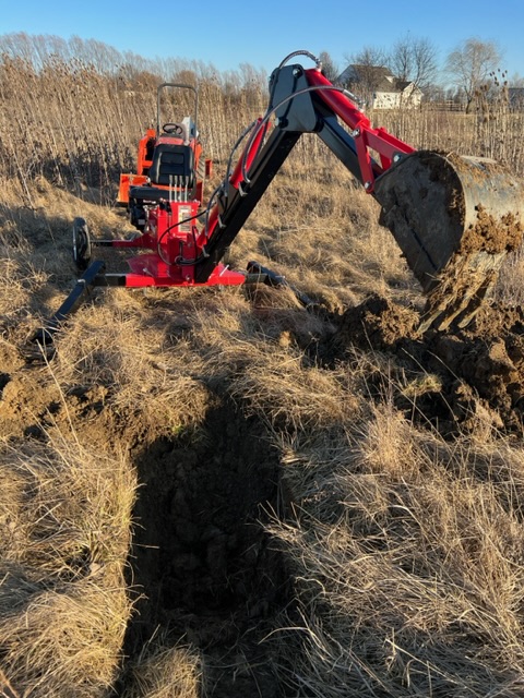

Here's one I built with my uncle about 20 years ago, it will get it done and it will teach patience. I rent an excavator now and then, but use this thing quite a bit
Nice.
This one isn't overly fast, but it has a decent amount of digging power.
Upgrading the pump to a higher flowing one is a pretty common mod. It doesn't really increase the power, but does increase the speed quite a bit.
If I just had one project to do, I would have rented something.....but I have a number of projects that this will be used for.

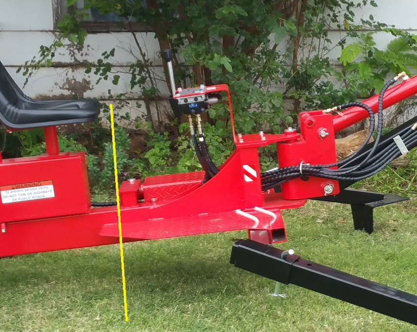

As far as turning it into an actual tractor attachment, i think it's a perfectly reasonable idea and it's actually the tractor side of things making it iffy. I say that because the swing cylinder placement on the HF machine dictates a pretty long 'stand off' distance from the back of the tractor, which would make the small BX pretty unwieldy to operate as anything other than a propulsion system for the backhoe because of the added length and weight distribution. It might suck to use for loader or other general work without dropping the hoe off of it. It's (bx) also not tall enough to tuck any of that digger underneath it even if you did for example, relocate the swing cylinder to the bottom. On a larger tractor you could simply lop the tank and engine off the top of the spar and sling the whole spar underneath the middle of the tractor as part of your 'subframe'. I'd say it's a reasonable thing to consider and there's nothing stopping one from making the 'other half' of the machine essentially a standalone hydraulic power pack that could be recoupled to the digging half if you wanted to use them together again. Since it's not using its main 'spar'/beam (looks like a 4x6?) as a hydraulic tank, you could just cut it in half at the yellow line below, and if you wanted to be able to put it back together again you'd just weld some plates or angle irons to the non-digging half, and drill some pin holes in the digging half, and could slide and pin it back together. A couple hydraulic quick disconnects and it's done. Sure, you'd have to be a confident welder but the actual cuts on metal needed to make it happen are extremely simple in this case.

The only unit I found that was specifically made for my BX2200 was a Woods. It looks like a nice unit and had the subframe as well as the backhoe available. I looked around for a used setup, but didn't find anything.
For my use I just couldn't justify the $$, so I went this route. Less than half the price including an upgraded hydraulic pump.
I will report back when it is finally dry enough to begin my trenching project.
