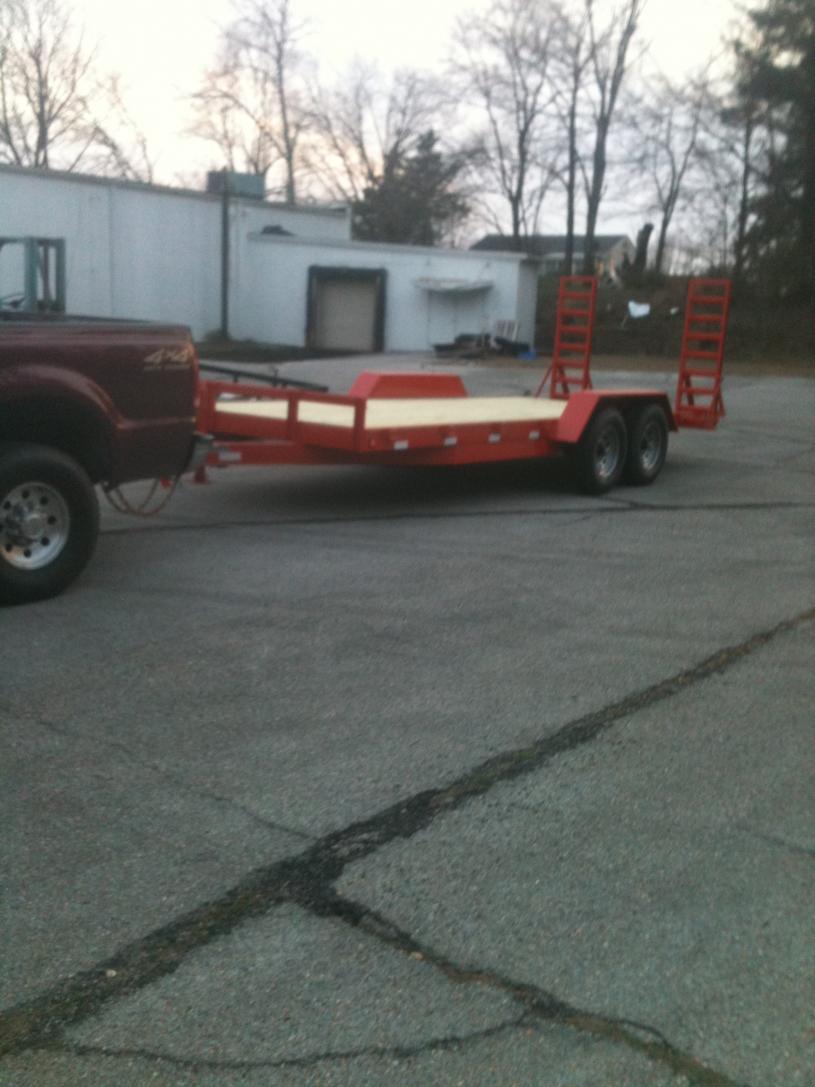

ethomas, I'm also puzzled at this point. Your trailer looks good and sturdy to me and at 50 psi in the tires, I don't see why you'd be having problems with your trailer swaying as you go down the road. I agree with checking the wheel bearings and suspension. Be sure to look at the bushings inside the ends of the springs where they bolt into the frame shackles and the equalizer. They should be good and solid and not move when you shake the axle (you'll have to jack up the trailer with the jack under the frame). How does the trailer pull empty? Or does it only act up when you are pulling your tractor? Does it act up if you are hauling a different tractor, say by itself? Have you tried pulling it with another truck? Maybe a Chevy or Dodge? I've pulled lots of trailers down the road and only had them act up when I had too much weight on the ass end and not enough on the tongue. Good Luck!

I would question not only if the rims are right for the trailer, but are the tire the right tires for a trailer at all. Last trailer I bought had some all season radials on it. They looked good but it would sway back and forth on the tire, literally moving side to side. Got trailer tires with correct weight rating for trailer and it towed great. For poorly towing trailers I check tires first, then make sure its not heavy on the tail end, then will add a sway control bar on the front of the hitch, can help a lot.

Your tongue weight should be about 10% of your trailer weight(trailer and tractor). If your truck sags in the back end, get a weight distributing hitch or a bigger truck. Proper tongue weight will likely fix your problem, unless something goofy is going on, like broken belts in your tires.

Check for a bent axle. They will drive you crazy. That one tire is worn on one side only and that is strange for rigid axle. Check the distance between axles left side and right side and make sure they are parallel, and perpendicular to the tongue. If the axles are parallel and the wheels plumb it should track true.

tractor weight 5600
trailer 2020
so i could only haul 4980 with 2 3500 axles about 620 over
