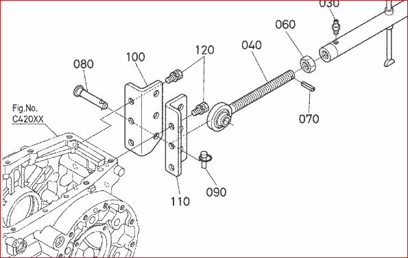

in the factory pictures it shows what looks like it could be a very slight or small stepped or collared pin, but I think that's just the way they have drawn it. ;)
It is more likely that they punched the holes slightly larger on one side either by design, to keep the pin from getting wedged in (my guess), or one too many sake bombers by the production crew :eek: and they just forgot to change the dies before running the other side. :eek:

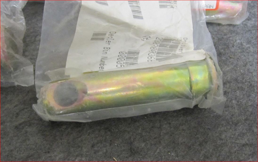

Wolfman, I can't thank you enough. I made a pin out of one I found at tractor supply that was stepped just right by chance. Will definitely call my kubota dealer ot let him know that he is mistaken for future reference. I will order the correct pin while I have him on the phone.
