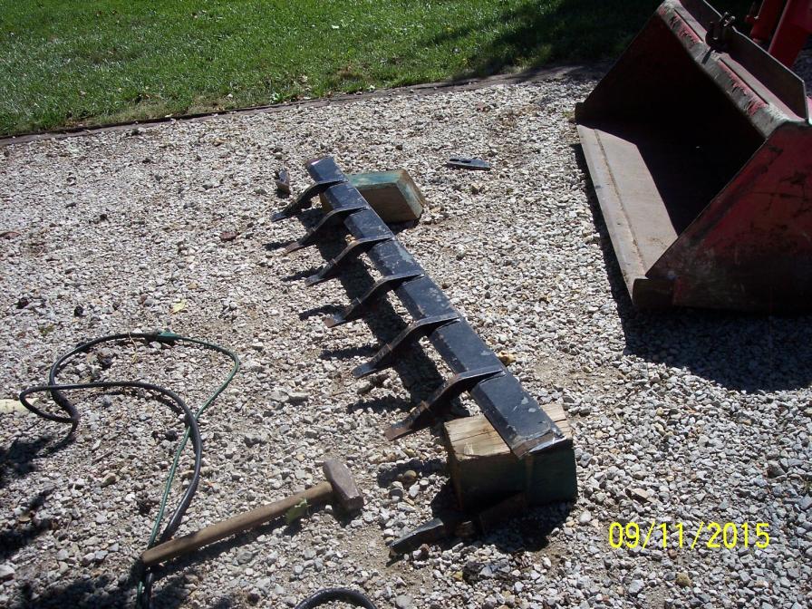

Here's 2 pictures, not the best but my name isn't Karsh. I used a hardwood 1by3 as a template for the hole spacing, bolted scrap as 'teeth' to it then barstock to tie together. My teeth aren't pointy as I'm usually fluffing up or hauling compost or triplemix or dirt or gravel. Easy enough to create pointy teeth if you need them, again zero cost and I've used/abused it for over a year now.

Looks outstanding! That does not look like it would make that much difference but I am glad it works. Now that you have it would you do anything different? Space the teeth or the length of the teeth differently?

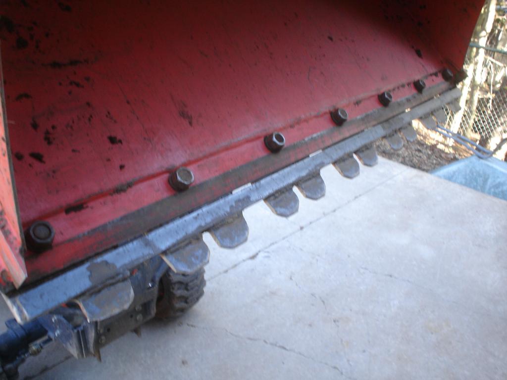

I also made my own out of a piece of 1/2" x 5" AR5 (abrasion resistant) steel, shamelessly copying the Piranha style.
The teeth were roughed out with a torch (the material was too thick for my plasma cutter) at a 60° angle, then final sharpening with a hand grinder. Sharpening AR steel with a hand grinder takes a long time! But shipping to Canada was a killer.

The spacing is 'funny' as the steel plates had PERFECT fit 5/8" holes, so I just quickly cut a groove to make 2 teeth. They actually dig in, break up the soil/sod around here very well, far better than the smooth front edge of the bucket. I may make another, with longer pointy teeth..as if I 'need' another Winter project. It has made a HUGE difference in time and speed in rebuilding the 1/2 acre veggie garden and adding mulch under the trees.

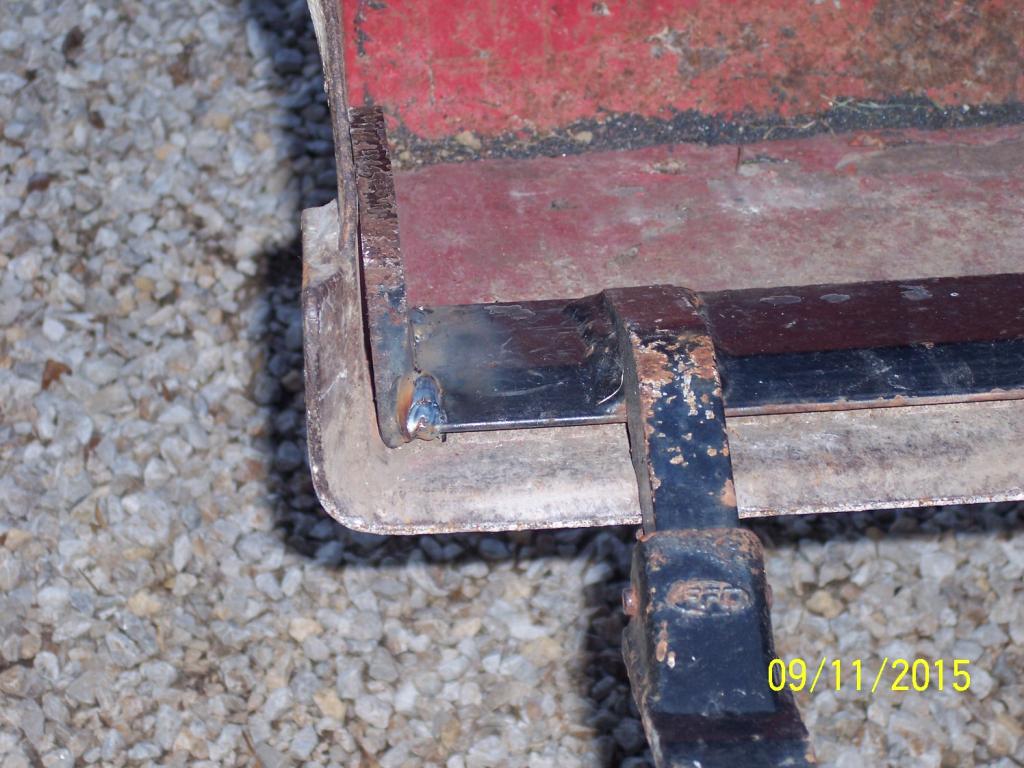

I bought a tooth bar at the scrapper for $25. Someone had torched it off a bucket. The tabs that hold it in position were missing, and it was too long for my 5' bucket.
I added some material on the back so it would lock on the loader edge. I also shortened it to fit the loader on the L305.

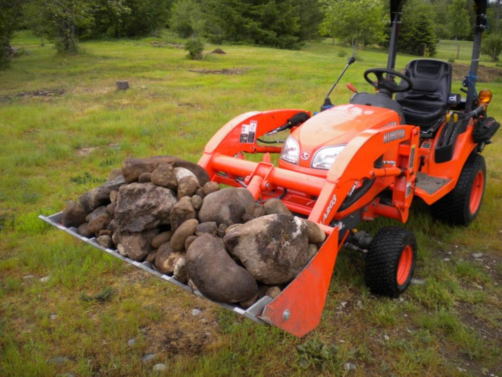

My property is very rocky. I have been successfully using the Piranha Tooth Bar for digging up rocks of in my yard. I have attached a picture of some of the rocks that I have dug up using the Piranha Tooth Bar. I am very happy with the performance. I also use the Piranha Tooth Bar to groom my gravel driveway by back dragging the bucket. It works so well that I do not have to use my box blade to do that task anymore.
