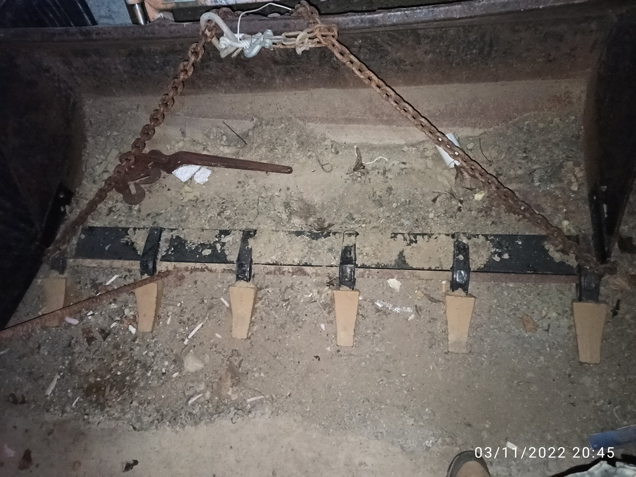

I have one that I bought from Titan last spring. I got the single teeth and the double (aka tiger teeth i think). i have to double check the length though and get back to you. I was going to use it to dig into this hard shale bed my house is on to save some money on fixing my foundation wall that has been taking on water since 1947 :oops: but I couldn't get a comfy position on the slope (actually almost rolled it...didn't even see it comin...thanking my protectors for having me double check the 4wd was engaged...sorry i digress).
I never bolted it on but instead strapped a heavy duty chain around it and the bucket and it snugged up pretty darn good. I've had to fix issue after issue with the hydraulics and now i've got to address the hubs allowing the rear wheels to all but fall off. so i literally used the toothbar a total of 1.25 hrs in the past year. LOL I'd be willing to part ways with it...I will measure and take some pics today.

Turns out the toothbar is 59" because my loader bucket is 60". That is not going to work for you, right? sorry again for the delay. i still dont know what is going on with my service and temp hotspots are being picky also.
snobunee37
Jun 30, 2020
9
Grantville, PA
If you think it will work, please let me know. Here is a pic of it on my bucket.
