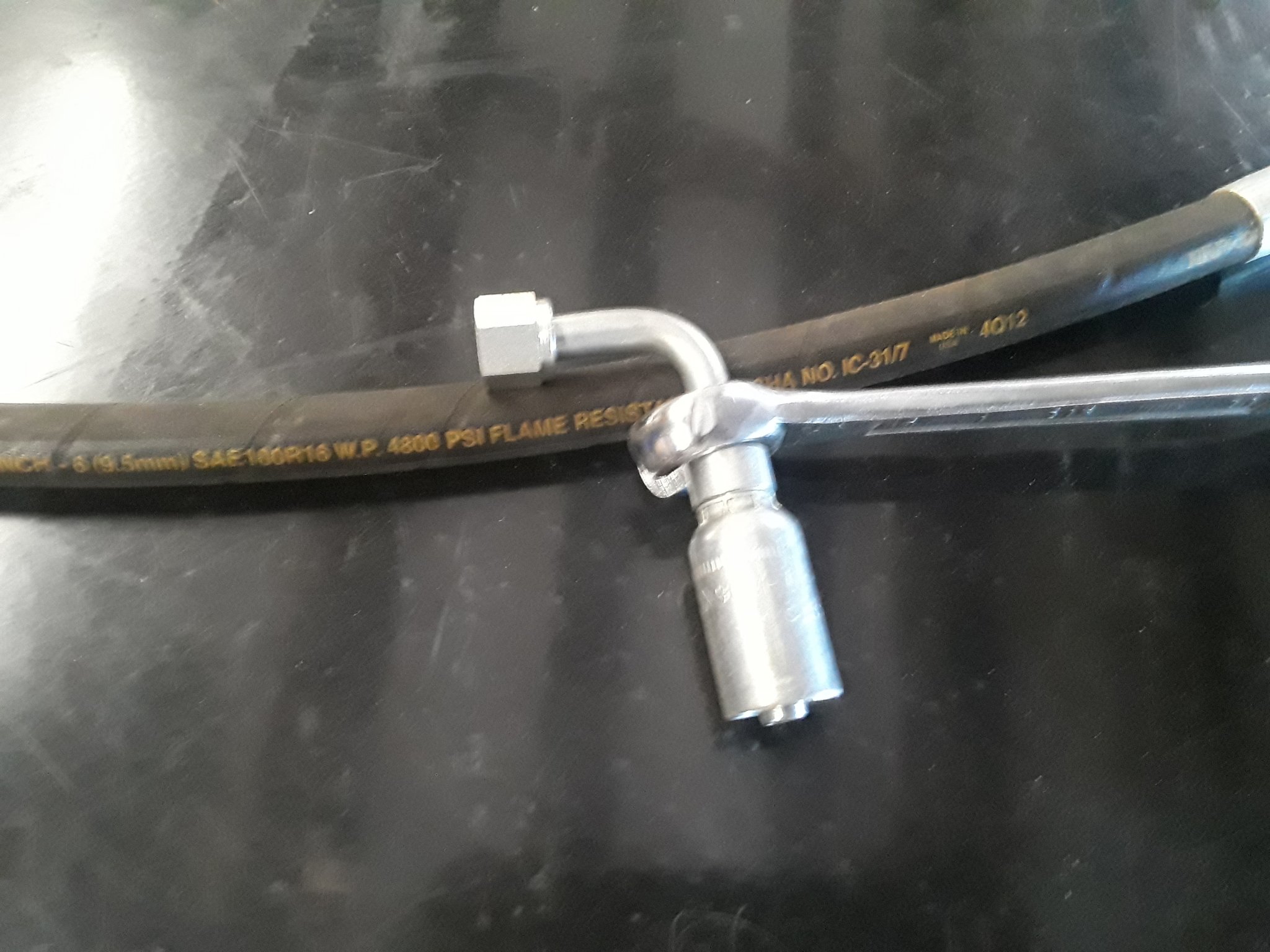

Does anyone know the size of the hydraulic fittings I want to buy a tube wrench to tighten them as they are leaking a little on the backhoe. b2301 or b2601. Are they metric or SAE thank you

Hose fittings will be Imperial (inch) and flare wrenches wont work on them. You will need open end for them. I would expect any tube fittings to be Imperial as well but thats a pure guess. Given the relatively low cost buy a flare wrench set that has both. I have both and I can't remember the last time I needed a metric flare wrench.

Thank you why will the flare wrenches not work? it is a tight fit for a open end wrench. It must be 3/4" then 18mm is too small to skeets point I cannot find my 3/4 open end wrench. I know it is somewhere.

Flare wrenches don't work on hose because the OD of the hose is too large for tehe opening.

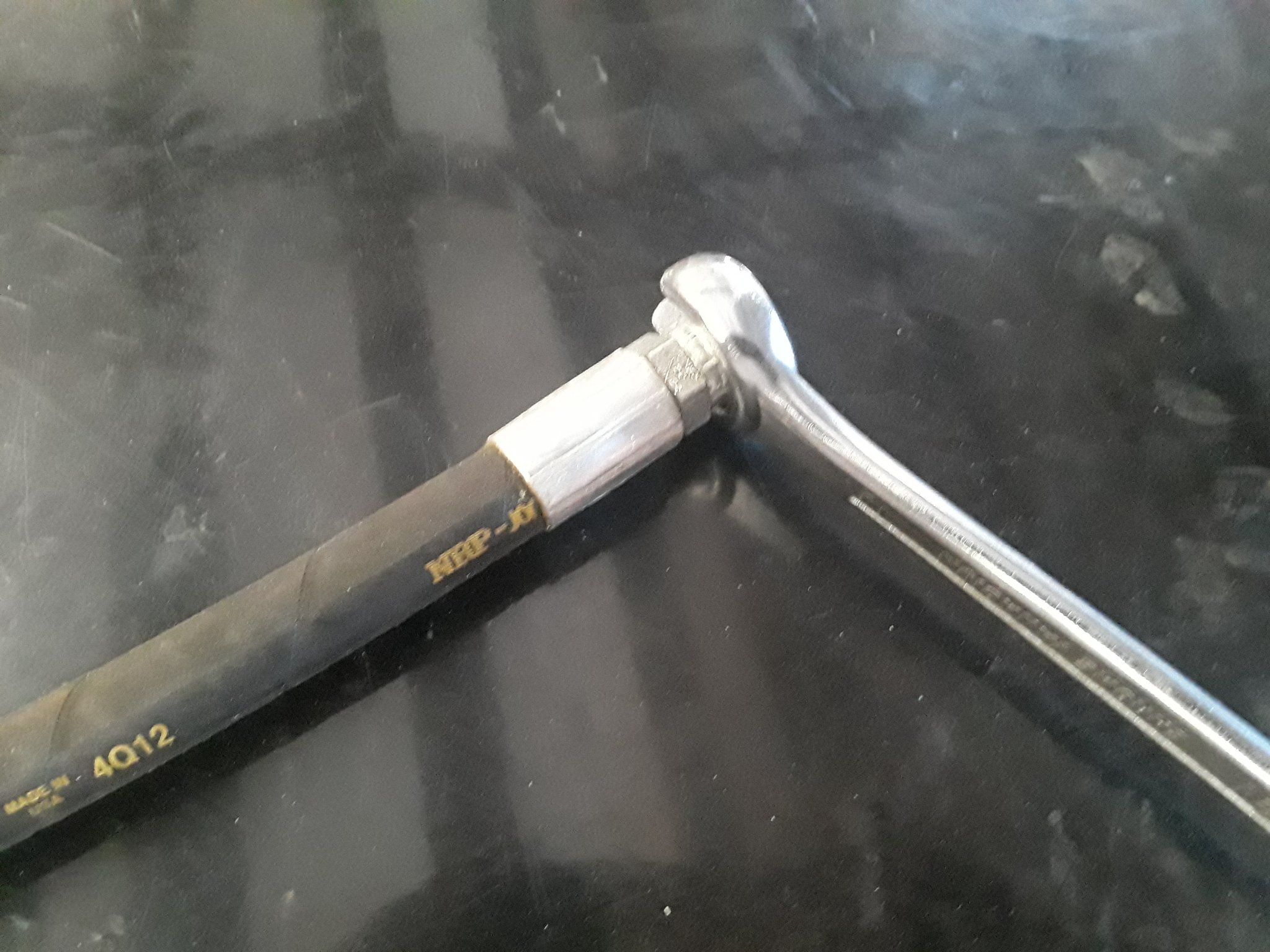

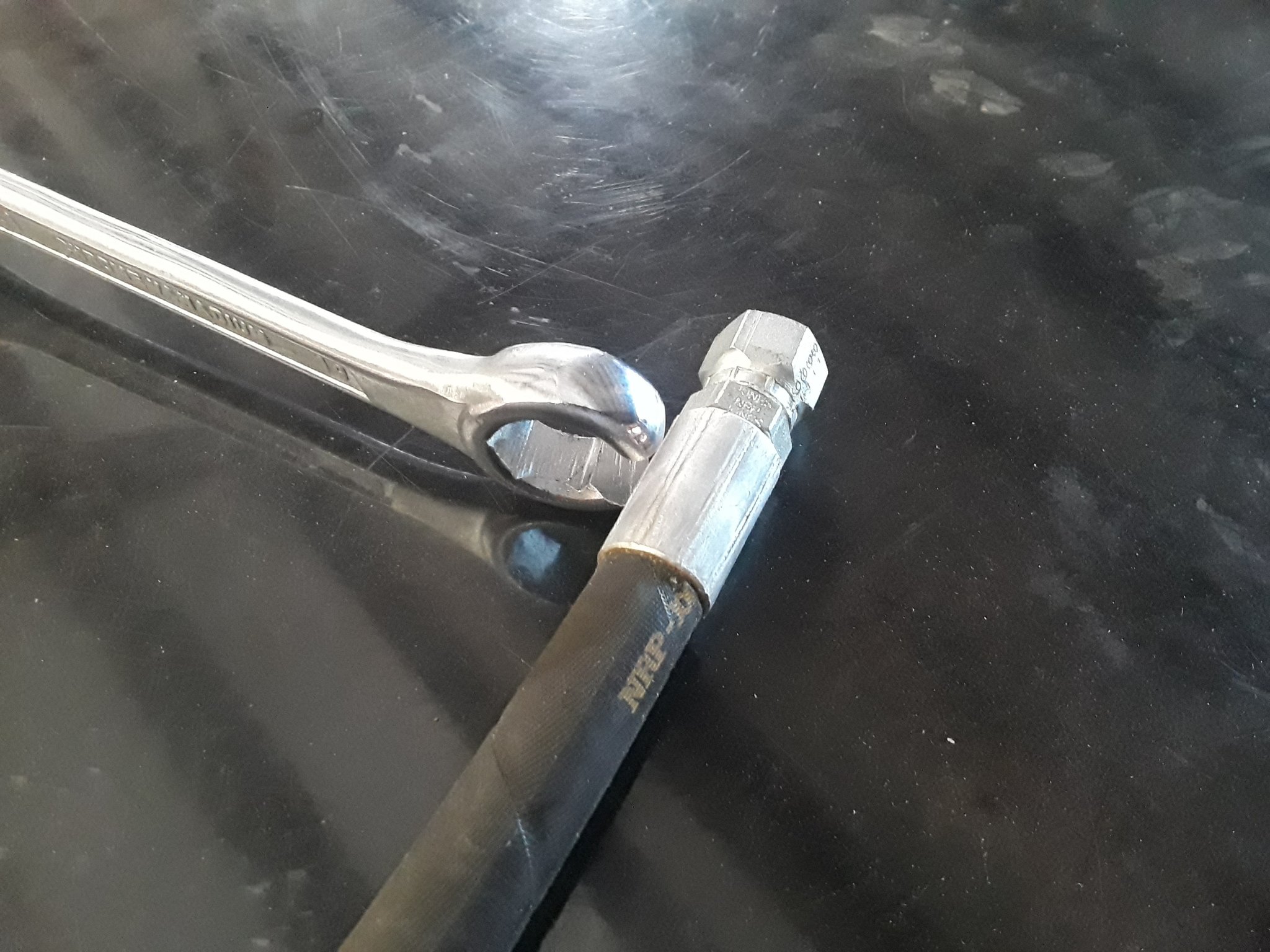

The opening on a flare wrench is just large enough to fit over the corresponding tube size. It is too small to fit over the much larger diameter of a hose ferrule. A JIC-06 hose end is 3/4" across flats.A 19mm wrench will usually fit. Here is a 19mm flare wrench which fits the 3/4" swivel perfectly but is not even close to fiting over the ferrule. If the hose has a tube end you can get the wrench on.
[ View attachment 80975
thank you that explains it. well
