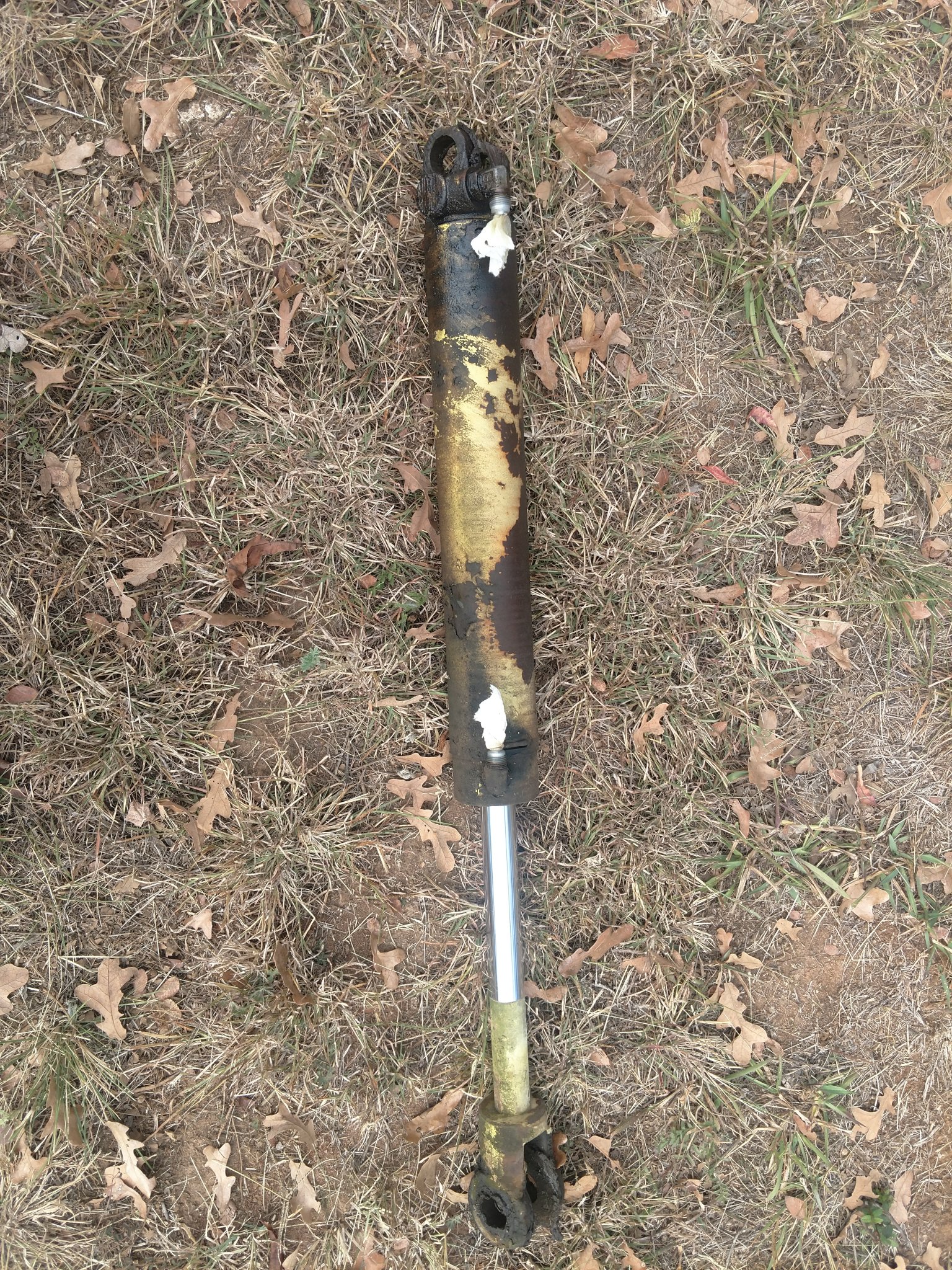

Very recently (last month) I had a leaking cylinder on an asphalt compactor-roller which dates back to ‘87. The mfr’r still makes that same equipment but uses a different supplier for the steering cylinder. The original cyl uses clips which must be cut to disassemble it and They no longer sell the original clip or cyl seals and only offer the newer replacement cyl for over a thou$and buck$. :eek:
I went online and found an almost identically featured cyl (3” bore, 30” retracted length, 50” extended length, 1” pins in clevis-ends ...which only required also purchasing their 1-1/4” to 1” reduction-bushings for $8.... and BACK IN BUSINESS! .... and for less than $210 including shipping... had it in two days and a 15
-minute installation was done!
