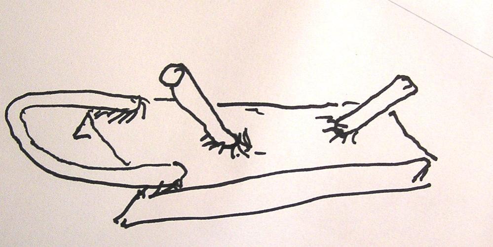

Here is a device that I made once and got lots of uses. It is a cleat as you might have on a dock or boat for tying off a line. Run figure 8's around the fingers. Make the pulling ring parallel to the rope. Place this over a ball hitch on tractor's pulling plate.
Hope fully this is attached.
