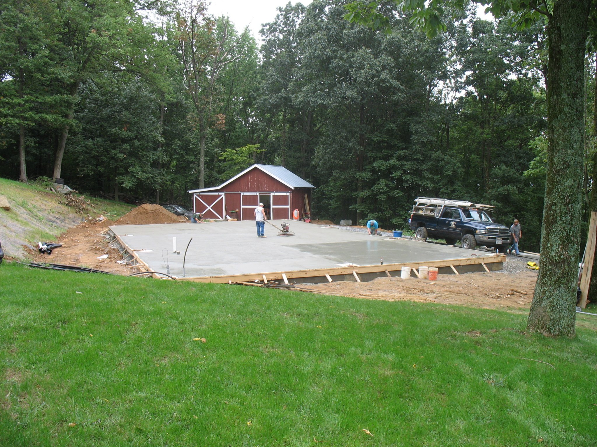

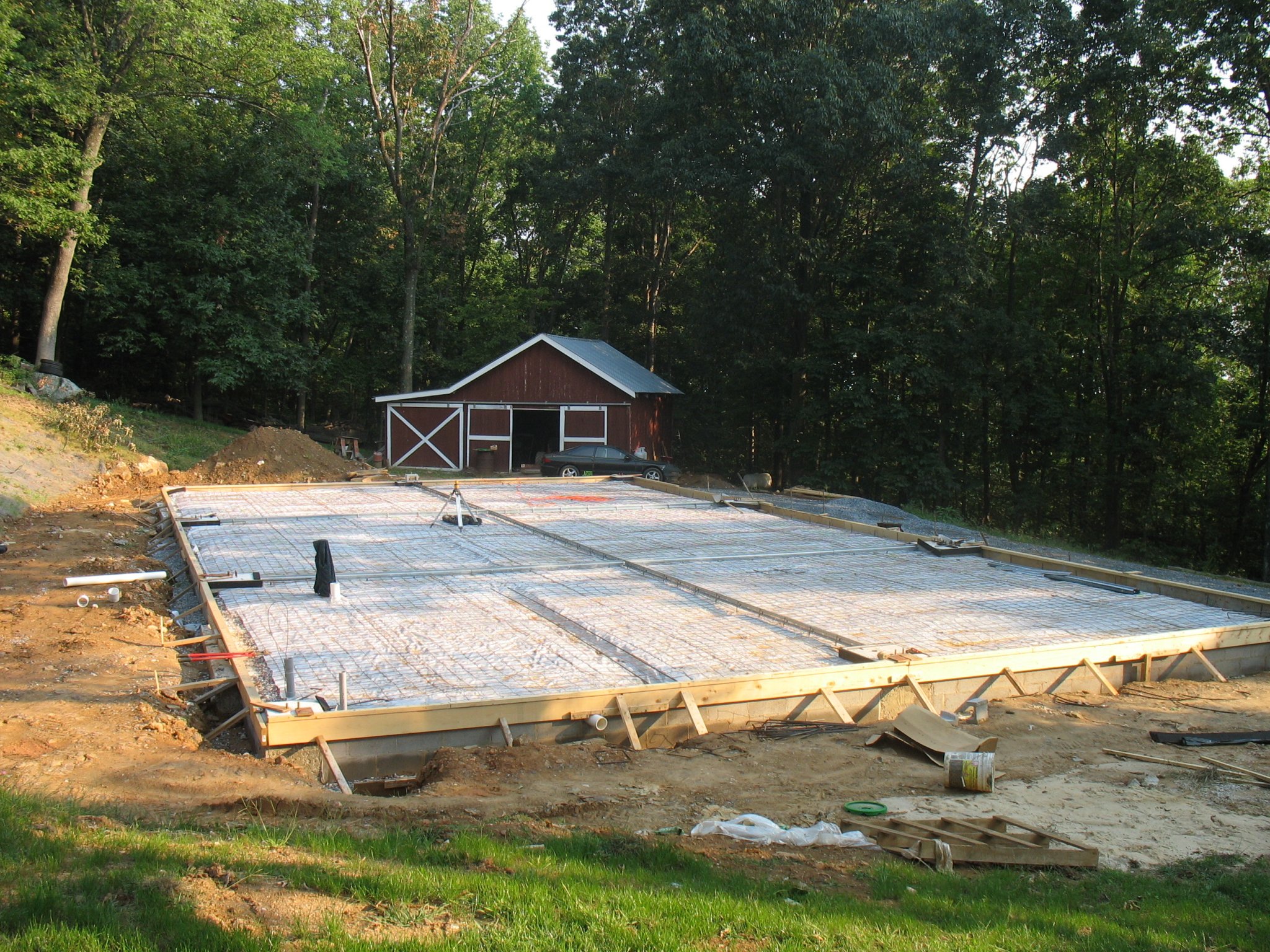

Times must be good where you live. Around here I could have my choice of half a dozen local boys with a hoe and dump truck to to rip out that little slab. Same for a crew to pour and finish it if I wanted to spread the stone and lay the wire myself. Here is the crew that poured and finished the footings, piers, and slab for my shop. All hired in person over a cup of coffee at the local gas station where they congregate. I put down the stone, wire, forms , paid them double what they get working for a GC, and provided the refreshments when finished. The slab pour was a biscuit under 40 yards @ $100/yd. so a little bigger than that driveway.
