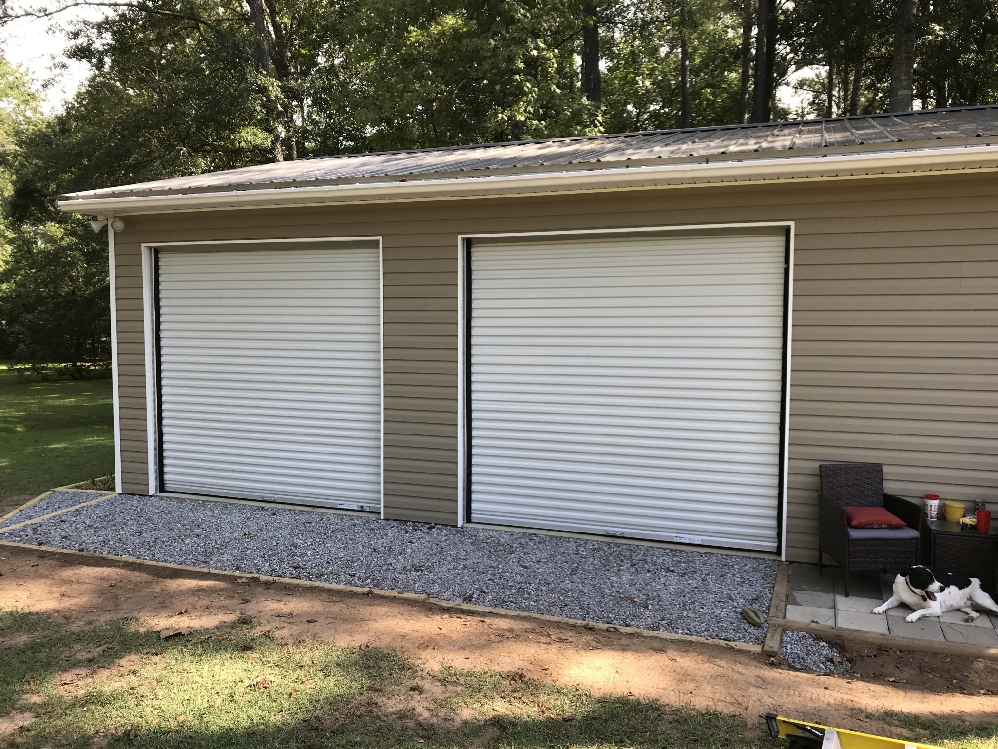

67 might be the best stone for allowing silt/sand to wash through, and less likely to catch in the tires. The coarser the better, except for the part of walking on it. Too course may make you or the missus twist an ankle. BUT, you still don't want gravel right up to the edge of the pad. I kick/sweep more 57 back out of my shop now than I care to mention. Even my little riding mower drags it in. Dunno if you plan on bringing your tractor in across that or not, but depending on the tread (Turf, R1, R4 or R14), you may pick up bigger rocks and bring them in. I pick pretty good size rocks outta my R-14's frequently. All food for thought before investing in a floor coating that has the threat of nearby gravel. Your floor, though. I wanted to coat mine too, but once I saw how much gravel was coming in and how much mud from using the tractor, I talked myself out of it. Just keep it in the back of your head though, eventually, you're going to have to scrape and recondition that gravel. Dirt and silt will eventually fill in around the gravel and come to the top as well as the gravel pushing down into the dirt.
Your doors are on the gable end, so you've already eliminated any possibility of roof runoff splatter being an issue with the doors. I put roll-up doors on for zero clearance on the opening, and fewer moving parts to give me trouble down the road. There isn't much price difference, and I can't say I'd do it again because of sealing issues with the rollups on the sides. I get some water in the building when we have a blowing rain, which is often in winter. Just a little heads up for your consideration before you spend your bucks on doors (if you haven't already). I like the roll-ups for their intended purpose, but they don't seal as well as garage doors. Maybe not meant to, because they're just thin sheet metal. If you plan to heat the garage, you're going to waste a lot of energy on doors that don't seal. I would strongly recommend at least 8 feet of concrete apron across the door openings where you can stop the tractor and wash some of the mud off if you still go forward with the floor coating. If you've never washed a tractor, though, just be ready to wash off the side of your garage too. Tractor washing is an experiment in mud splattering. But an apron will give more time for the gravel to fall out of the tires or at least to let you see it and will help with erosion splatter around the doors. Mine is a lot better now that most of the surface dirt has washed through the 59 that I used, but for a while it was making a mess on the doors and vinyl.
Here's what I did. No drive going to it, so I just put gravel in to keep the tractor from making a muddy mess. I ran a 4" perf pipe across the front edge of the gravel to drain the water from left to right and get rid of any that wants to stand in the gravel.
Old Paint...we cool!! I didn’t want to come off as facetiou, was still working on my first cup of coffee, so I might have. Sorry if so!! I can only imagine the back stories of a lot of us on this site which could change perceptions on/or the writings we share. This garage is at my coastal home so the Kubota will not be stored there, only while I move the dirt left over from the garage build and driveway / landscape project. This will store 3 vehicles, boat (which I just sold) tools, ice machine etc..and lawn maintenance tools. Speaking of perceptions, probably some rolling their eyes as if I’m filthy rich, braggadocios, self centered, etc., etc.. God has been good to me. I grew up very poor, parents divorced when I was 6 but both were there for me. Dad has 8th grade education but one of the smartest men I know. I went to community college, learned a trade, worked my way up through that company in 10 years, then started my own. My wife and I have never had any financial sums of money handed to us. Wife has 4 family members that received $250k or more in settlements, all are now financially challenged with not much to show for it. Raised 3 great kids, youngest works with me ME degree, middle is a hero to me, joined Army serve 2 tours in Iraq has become the man I never thought watching him as a kid. Daughter just graduated Liberty U with second degree masters. , primary degree in home interior design. YES, I am boisterous of them and blessed, wife and I worked very hard. When economy was good beginning with Reagan, my fellow business friends blew their money on cruises living large partying. Obama presidency put them all out of business. I payed off my house, cars, company and assets. Bought the house in our conversations in 09 when construction was horrible (went from 15 employees to 3), paid it off in 18 ( Thanks President Trump) still 3 employees. So there is some back story, folks can judge if need. Was it Popeye that said “ I ams what I ams”. My life has been interesting, best friends wife says all the time they should make a movie of your life. Bless her heart!
Back to the points, differently going with larger rock, at least #67, tractor tires are R4 but more concerned with the aggressive tires on the Wrangler. Will put down a geotextile in hopes that will control sinkage of stones and weed control. Think I will skip the epoxy floor color coating, just plain sealer, save that $5-6k. Building pad was poured with a 2” lip down at doors to seal out water or wind blowing it in on pad. I really like that!! Door contractor placed thick seal around doors so they are better than average. Building is well insulated, putting in 3 ton ductless heat pump, quite a bit more than needed but want it to recover quickly. Wife will use it for family gatherings. July, August, Sept. we easily have 95+ degree days @ 90%+ RH. Really like your well thought out suggestions, greatly appreciated. Your building looks great! Giving serious thought to concrete apron at building pad. If I had my Kubota at the time the building was being built things would have been different with the drive I believe. I think it is going to be better now. Got to figure out border materials next. Will stay in touch!!
