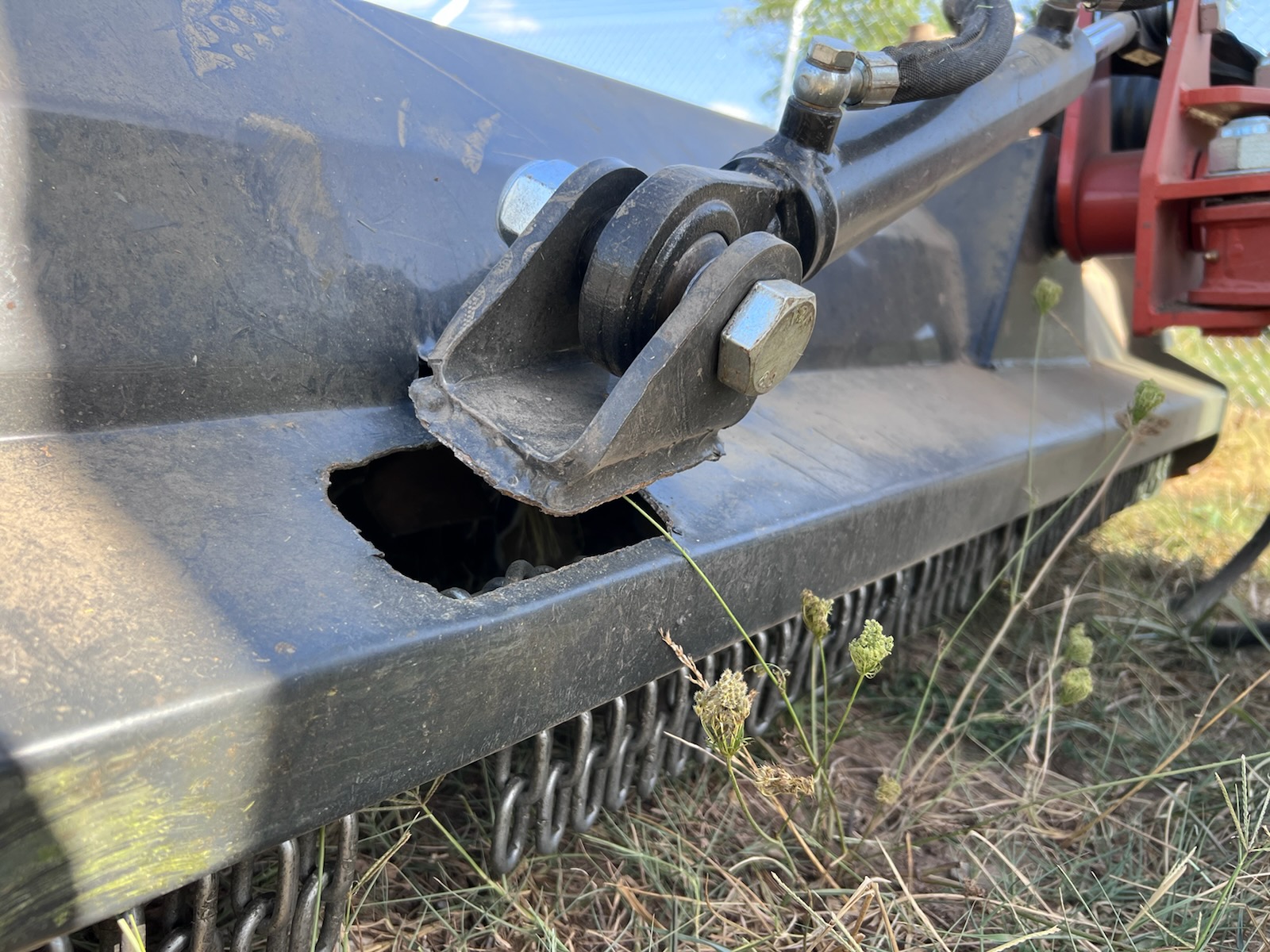

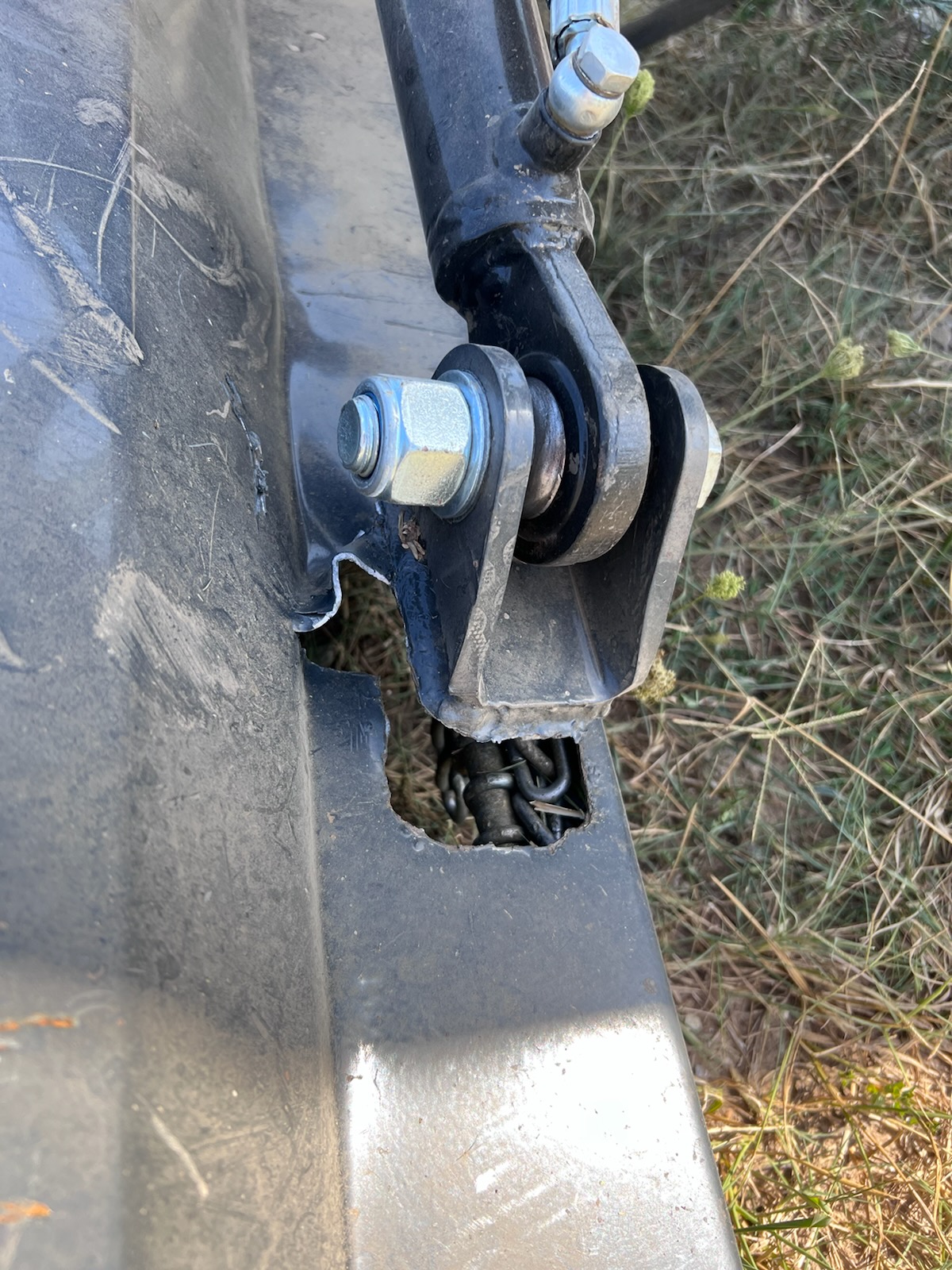

After approximately 100 hours of use, our flail mower had a significant failure. We were in the field, so we had to hire a welder to repair it. Hopefully, it will last a couple hundred more hours now.

Wow. I'm surprised they would weld such a thick linkage directly to such a thin plate, which is really just sheet metal. Definitely could use a stiffener plate there. If you send that to Titan, hopefully they'll update their design practices, since I'm sure that if they design like that on one implement, they probably do it on many others as well.

After approximately 100 hours of use, our flail mower had a significant failure. We were in the field, so we had to hire a welder to repair it. Hopefully, it will last a couple hundred more hours now. View attachment 86105 View attachment 86106
Not good. Can you show a photo or two of the repair? It's unfortunate that you had to pay somone to fix a poor design. I would have done it for free if I lived near you.

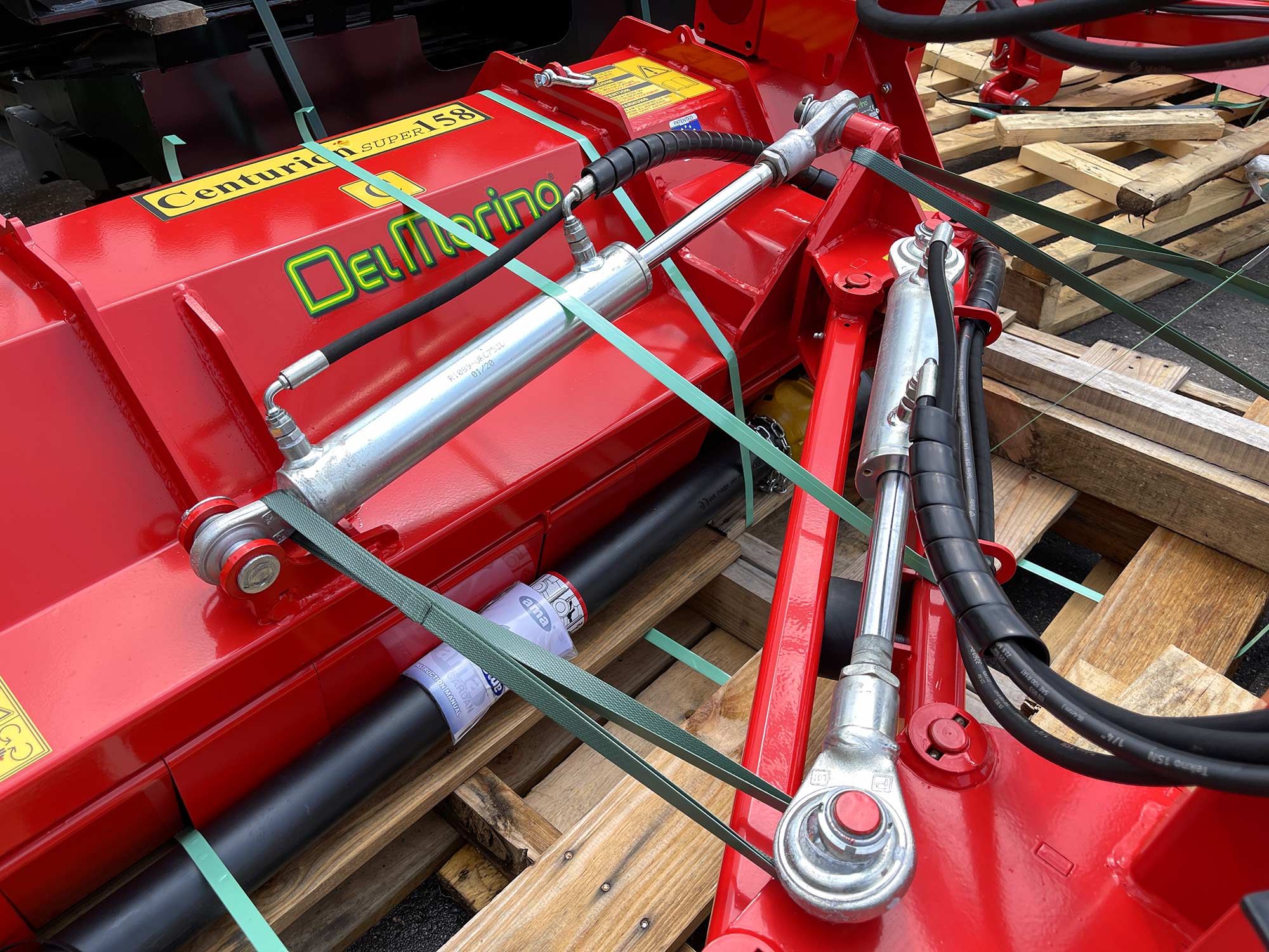

Since Titan Implements now IronCraft doesn't make a 57" ditch bank flail mower but Titan Attachments does, I assume it's one of the TA Chinese knock off models that still aren't cheap. Like @OriginalRedfishMan I opted for an Italian made hydraulic offset flail mower, specifically a Del Morino Centurion Super 158 which has been excellent so far but only 20 or so hours of heavy duty cutting on it.
Good luck with that! This is Chinese made stuff you're talking about.

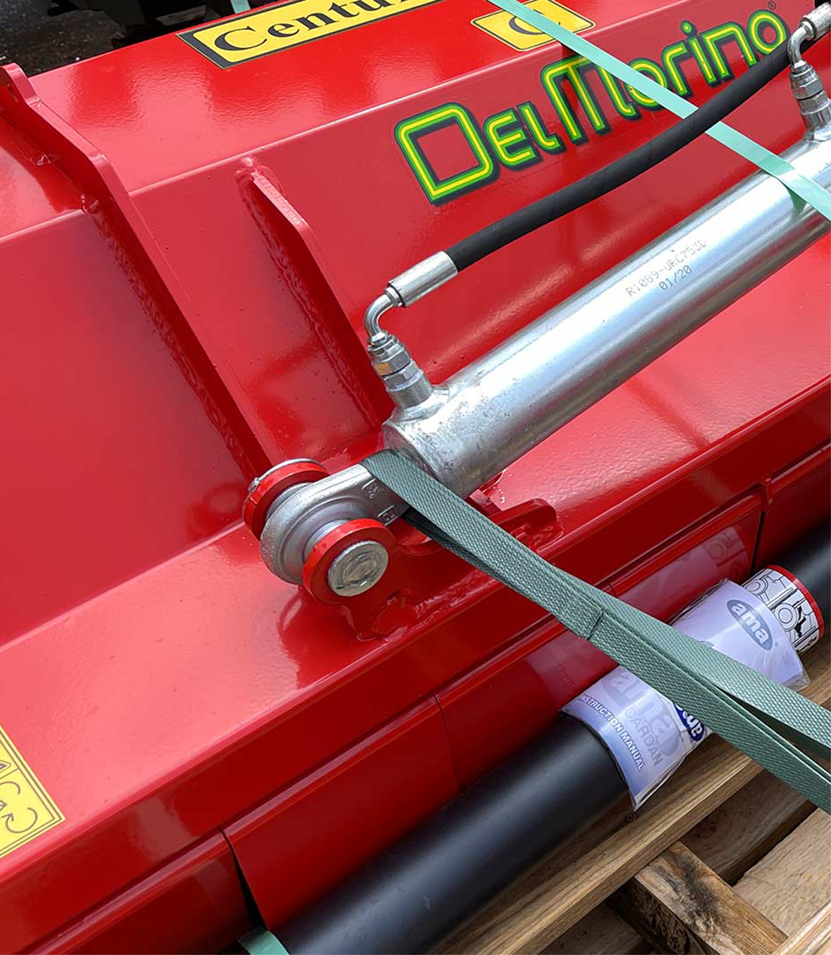

Look at how Del Morino mounts that cylinder to the box. They have a bracket tied into the stiffner plates.

I agree with those who mentioned the lack of reinforcement in a high stress weldment.
It looks like you have a palletforks.com (Titan Industries) unit. I had a problem with one of their products and had to push really hard (even put in a complaint with the Better Business Bureau in their local area).
Kind of demonstrates why Titan Attachments ( a good company with a made in America product) has changed their name so as to not be confused with the other Titan.
I hope that you can get a satisfactory response from the factory, because that is just poor fabrication plain and simple.

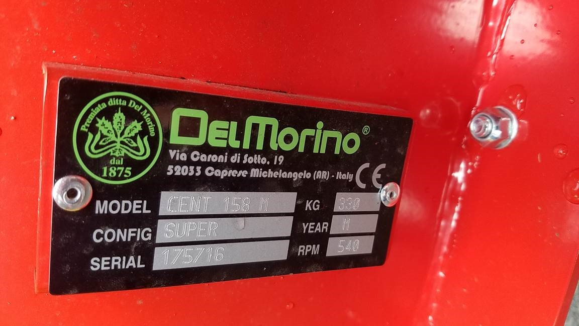

I was going through some photos and here's the ID plate from my flail mower. Pretty much says it all.
