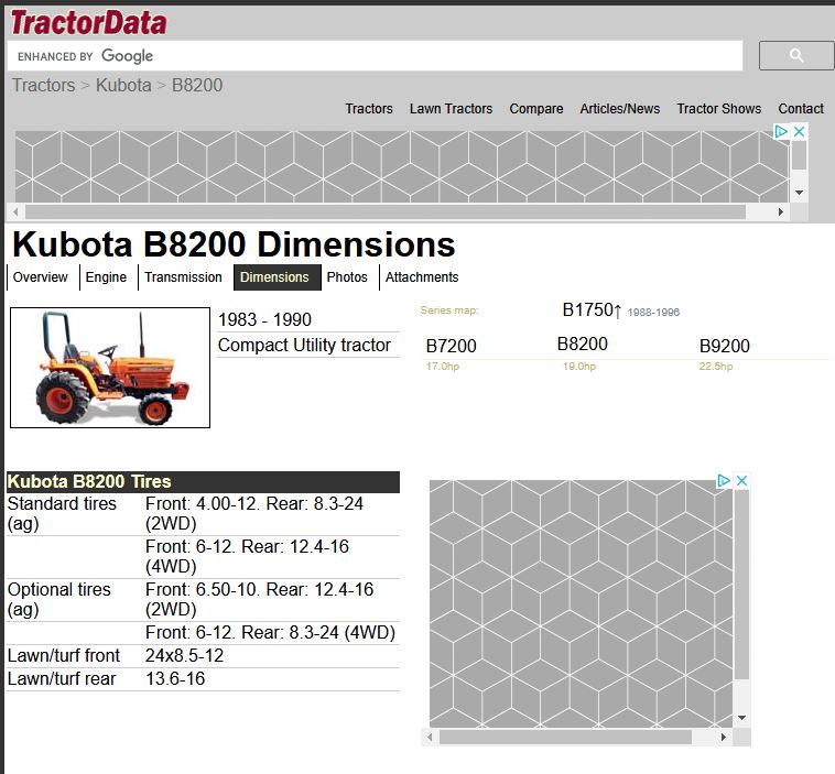

You didn't mention whether your tractor is 2WD or 4WD. If it is 4WD you will want to maintain the circumfrence ratio between fronts and rears as was the original. This is because you want the fronts covering slightly more ground than the rears to maintain steerage. "Pushing" the fronts is not a good idea. I have attached the original specs for reference. Good luck with the new tires!

Thank you. I have read a lot of reviews and forum posts about BKT tires. I hope to have them at least half as long or more then what I have now....from April 1989!
