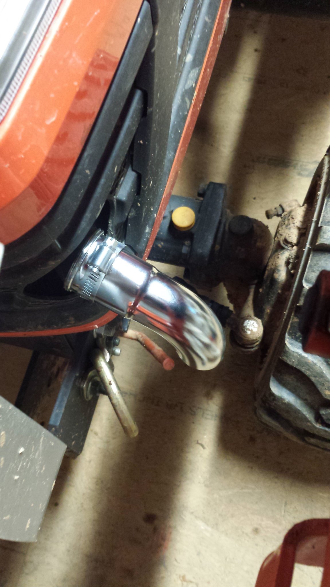

NAPA number 41231, cut off factory pipe 3/4” past last bend, cut off with a cutoff wheel, clamp on new pipe, no more soot.
I did this on my LX2610HSDC

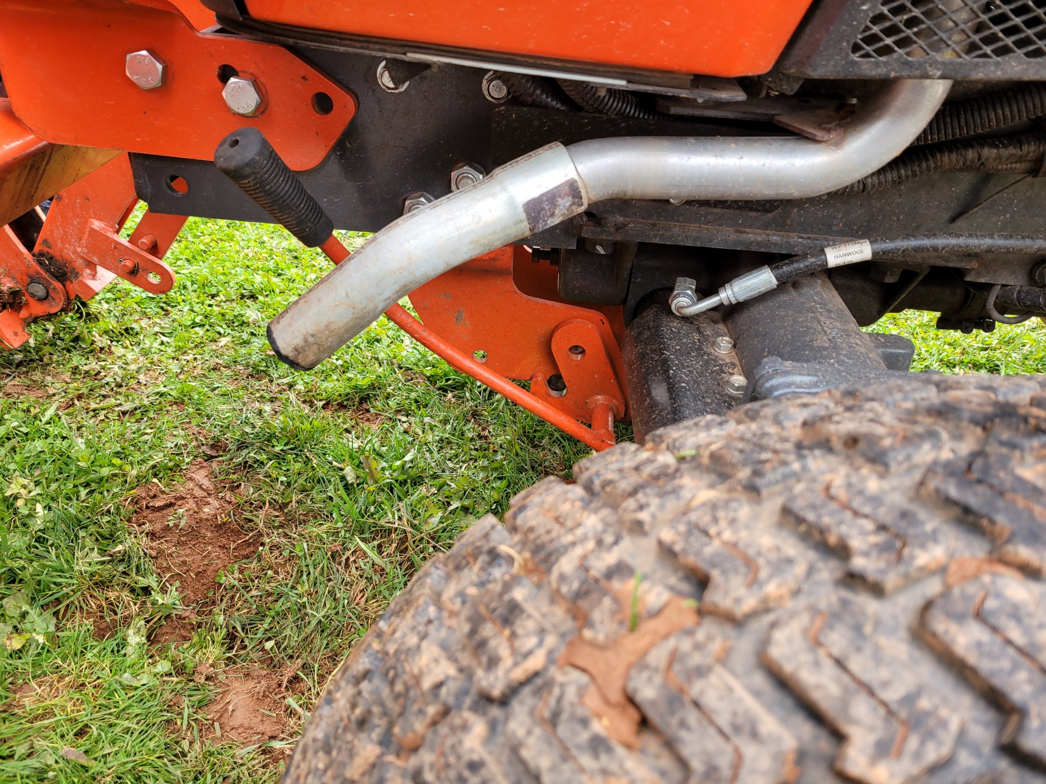

A piece of good ol metal sink pipe does the same ! Both work well! On BX25D

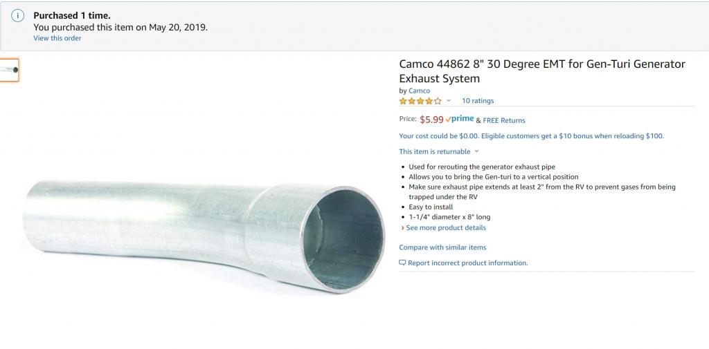

I used a generator pipe extension from amazon on mine. I just pushed it on and it hasn't moved.

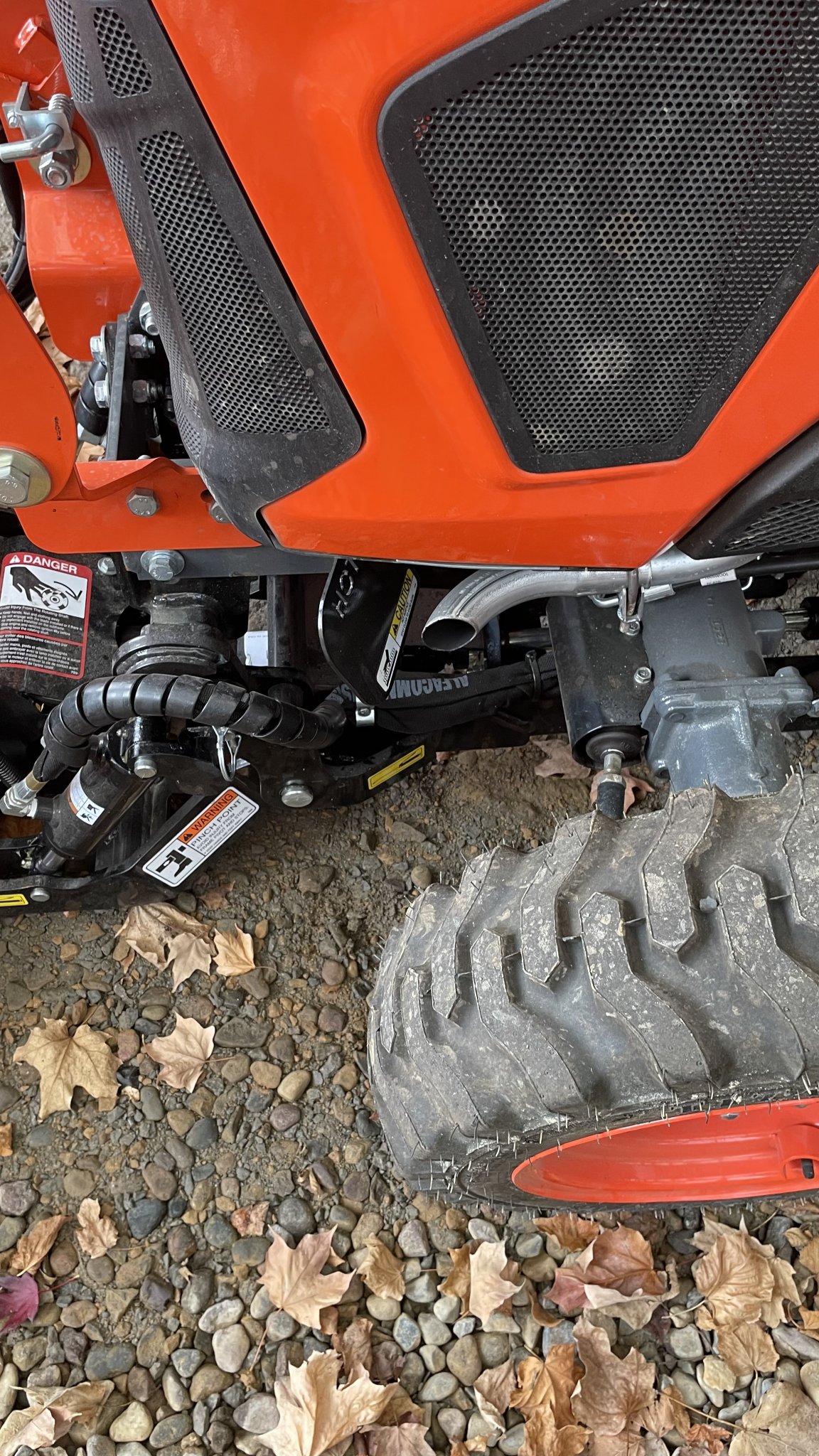

There is a welded ridge on the factory pipe of the BX2370 - so when the pipe slides on a tight fit is created - however, with the expansion of heat/cold and vibration, I found that I had to slit it a bit on the backside and place a hose clamp around it to secure. It fell of once, but has not in the last couple of years.
