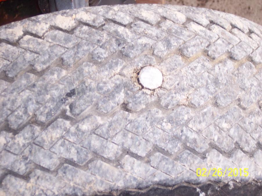

When I got the B7100 it had a carriage bolt through a tire. The tractor was in parts, the radiator was missing, head off. So I just figured they ran over a bolt and just left it.
When I broke the tire down the bolt had a washer and nut on the inside. That was their method of sealing the leak!
