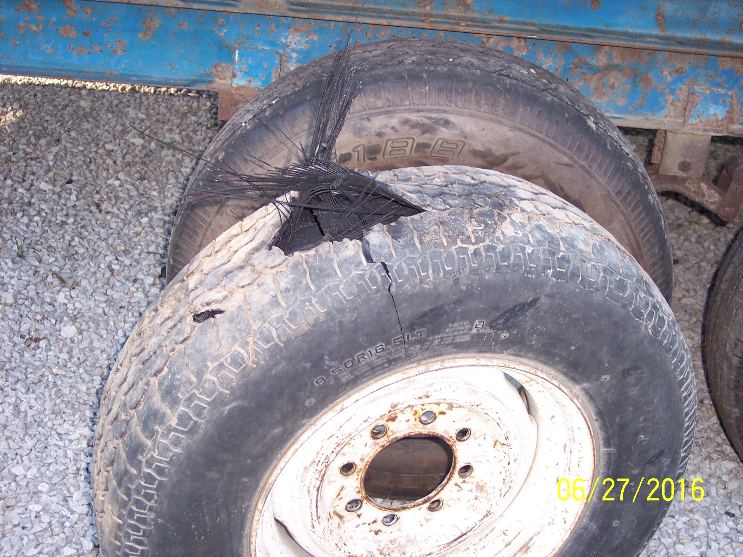

Here is a real world example of what happens when a 'bulge' fails. I know you'll recoil when you see the guy purposely slit/puncture the actual bulge site. I mean what kind of fool would place himself in such a perilous position. Please take this opportunity to educate yourself on tire construction (passenger vehicle and tractor tires....the same). Perhaps then you'll understand why the danger you propose (at low inflation pressure and a tire that is not dry rotted) is such folly.
In no wise am I advocating we ever dispense with reasonable safety practices. I AM however calling out your notion that the OP's tire represents a physical hazard. The tire is a 'time bomb' (pun intended) only in the sense that it WILL fail at some unknown point. The failure WILL be unspectacular and manifest as nothing more than an audible 'whoosh'.
We live in a world with plenty of things to actually worry about. The OP's tractor tire is not one of them. Anyone believing otherwise probably needs to stay at home each day because you are venturing out into a world where REAL risk assessments are necessary.

Here is an example of your so called 'rupture' (also a release, the only difference is the force curve over time). We are not told at what pressure the tire failed (I inquired in the comment area) but suffice to say it was probably in the 60 psi range, fully three times the pressure of the OP's tire.
Note the 'SPLIT' in the tires sidewall just as I said would happen with any tire not dry rotted and at low pressure (35 psi and under). I would submit as a former technician you failed to learn this along the way.
As you will see in the video there is NO explosion, no detectable debris flying anywhere, just a quick release of air (no doubt at a high pressure). A purposeful over-inflation to cause failure.
Of course, a tire manufacturer will not make any statements other than replace the tire for liability reasons, you know that....so don't throw that out there. It would not be in their best interest regardless the real world facts.
That doesn't support your position... it just means they practice CYA. And pretty much everyone here is smart enough to know that.
Again, lets maintain the context (tractor tire, low pressure inflation) NOT a death trap.
