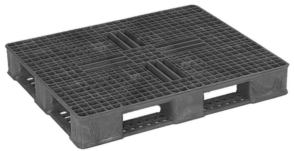

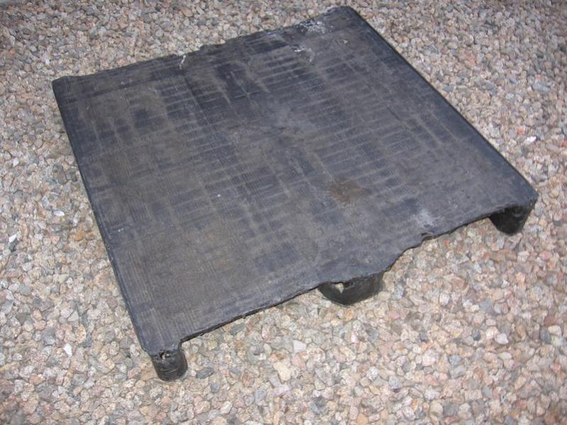

I like plastic pallets for parking implements. The last much longer than wood, and have much less stiction than wood. They are also a lot more forgiving than wood if you happen to drop something heavy on them, or back over a corner; stuff like that. (not that I would know anything about those things;))
The only other thing I can add is that a quick zap with a dry silicone lube spray on pins, ball joints, lynch pins, and such will often ease things.

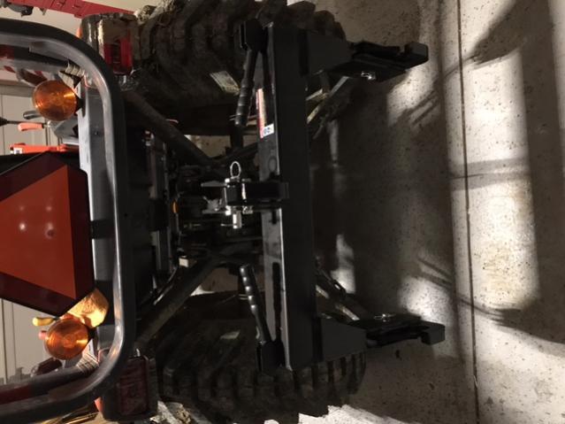

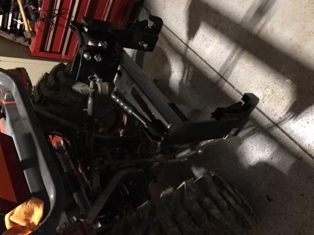

I ended up getting a quick release from Harbor Freight. For the cost I'll give it a go and see how it does. Installation was a breeze. Including unboxing, maybe 15 minutes total. If it becomes a hassle, I can easily take it off.
I'm thinking about putting some level bubbles on the top and side to better see the angles with the attachments on.
