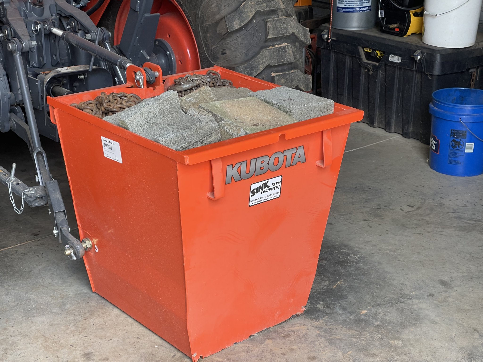

Load rear tires and have the tire guy put the rears in the widest configuration. Loading will add several hundred pounds of ballast per tire. I purchased this and have it loaded with gravel. It added several hundred additional pounds of ballast weight. IMG_2526.JPG IMG_2525.JPG
