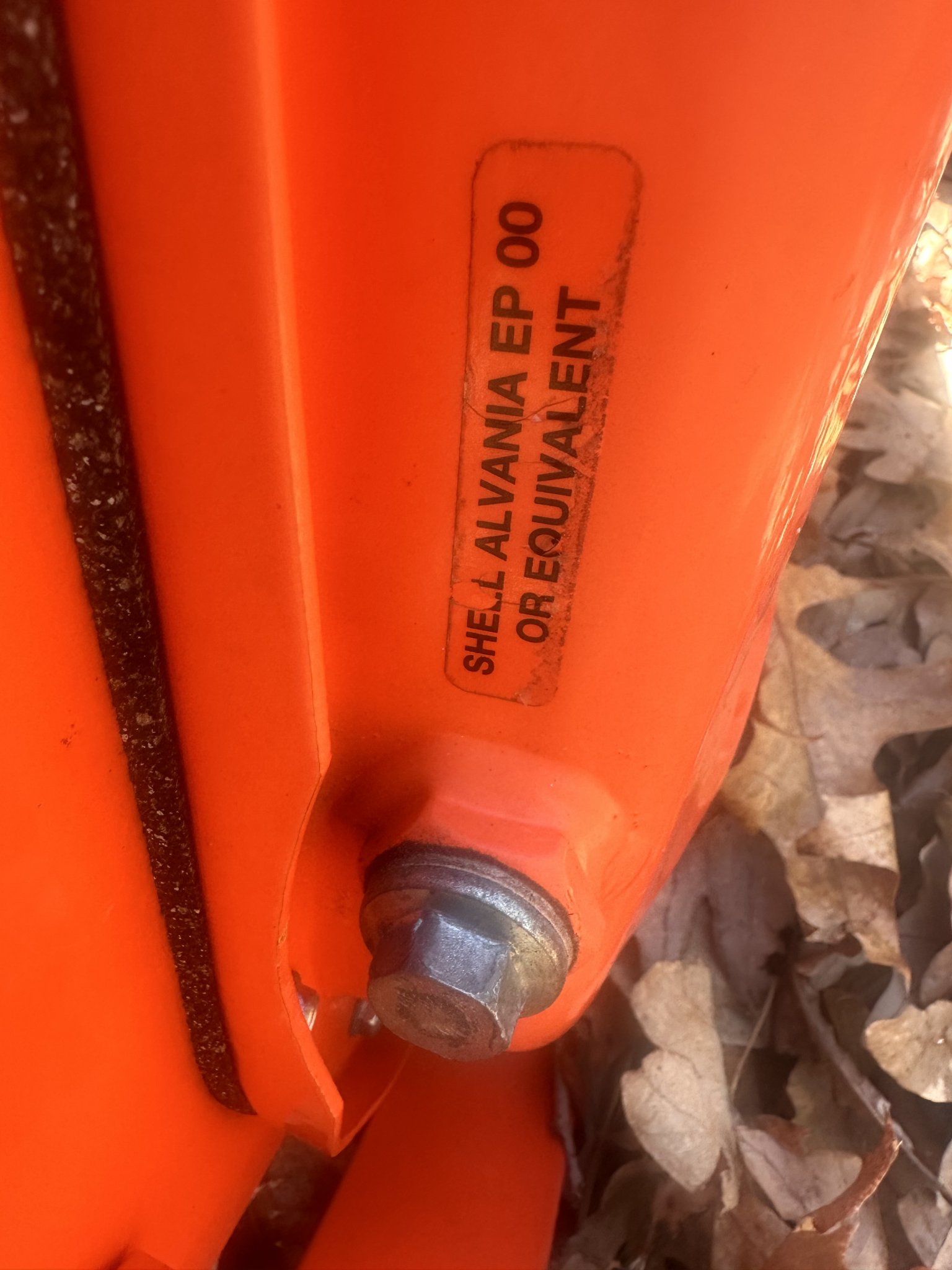

I recently bought a pre owned Landpride RTA 1250
The sticker outside chain housing indicates to use “Shell Alvania EP 00 or Equivalent”
I can’t find the recommended Shell
product to use, any recommendations as to what the “equivalent” would be?

EP 00 is an extreme pressure semi fluid grease, a.k.a. "corn head grease". Check your local big ag dealerships. Also look for NLGI 00 grease in a tube. People use this in brush cutter gearboxes as well.
That's what I use in my CCM tiller. I could buy grease cartridges for <$5 each at the local Case/IH dealer, and in stock. Go to amazon and pay a bunch more!!
