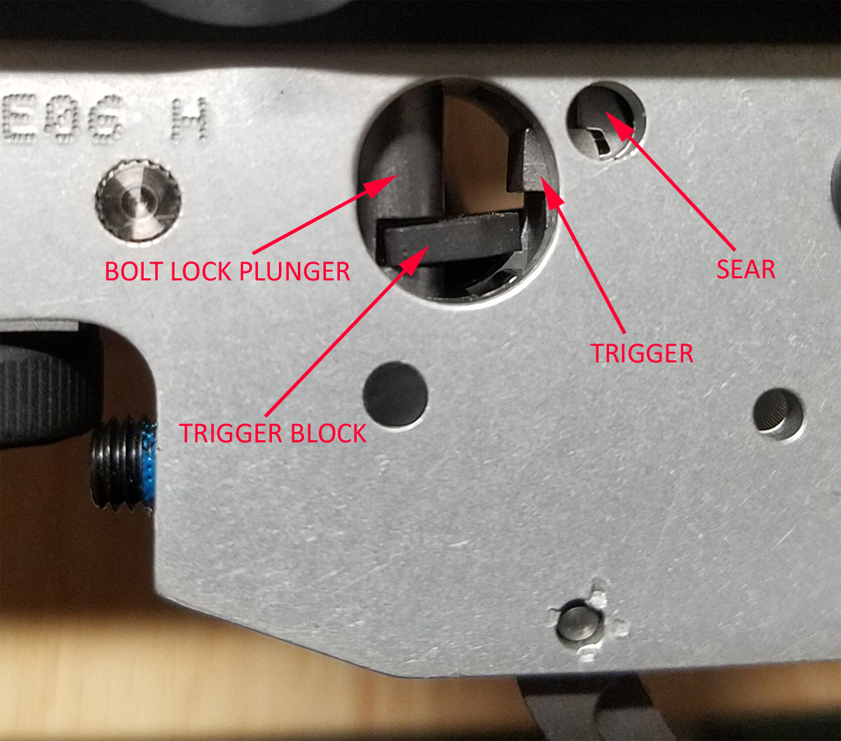

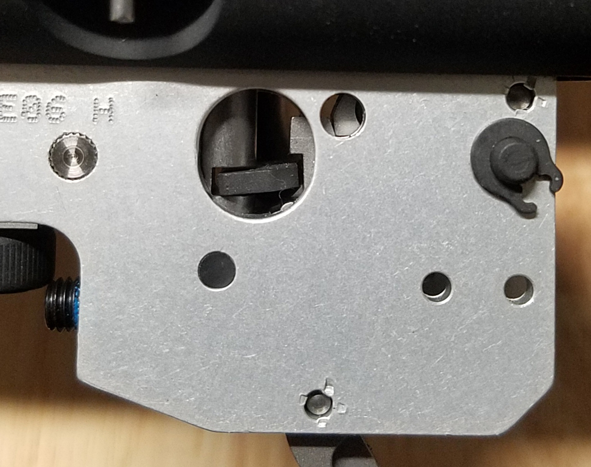

I don't know if this is common or not but this weapon has, what I believe is an extremely stupid bolt function. For what ever reason the bolt will not move unless the weapon is in the fire position.
She loads the weapon and puts a round in the chamber. She flips the safety ON and the round discharges straight into the ground in front of her!!!
The T3 like many rifles has a locking bolt handle. Some with locking bolt handles allow the bolt to be manipulated while the safety is on such as Sako, Kimber and Winchester rifles. I have a Tikka T3 (.300 WM) and a couple of Sako S20s (.308 Win & 6.5 PRC) which are nicer siblings but I'm a fan of Tikka and Sako products. I took some photos of the trigger group and added some labels for various parts.
Did you try cocking the rifle and then thumping the buttstock to see if the sear would release? Better yet, cock the rifle and drop from 12" onto a pad to see if it fires. Activating the safety blocks the trigger (see second photo below) so I'd guess that the pull weight is so light that movement of the safety is enough to release the sear and thereby the cocking piece in the bolt. A thump to the side of the stock might give the same result. There are other possible explanations, but a single stage trigger that has either intentionally or unintentionally been adjusted to a pull weight that is too light for the geometry can cause this.
When you develop a new rifle you have to pass the SAAMI "jar-off test" which involves dropping the rifle from 12" onto a rubber mat with the bolt cocked and safety off. The rifle must be configured with the trigger set to the lightest advertised factory setting, and any reasonable accessories installed such as a scope, rings, sling, ammunition etc. that add weight to the system. The rifle is dropped in six orientations and should not fire on impact. I've conducted such tests and on one rifle project was able to drop the rifle from 36" (six orientations) without discharge.
Cocked with safety off
Cocked with safety on
Fired position
